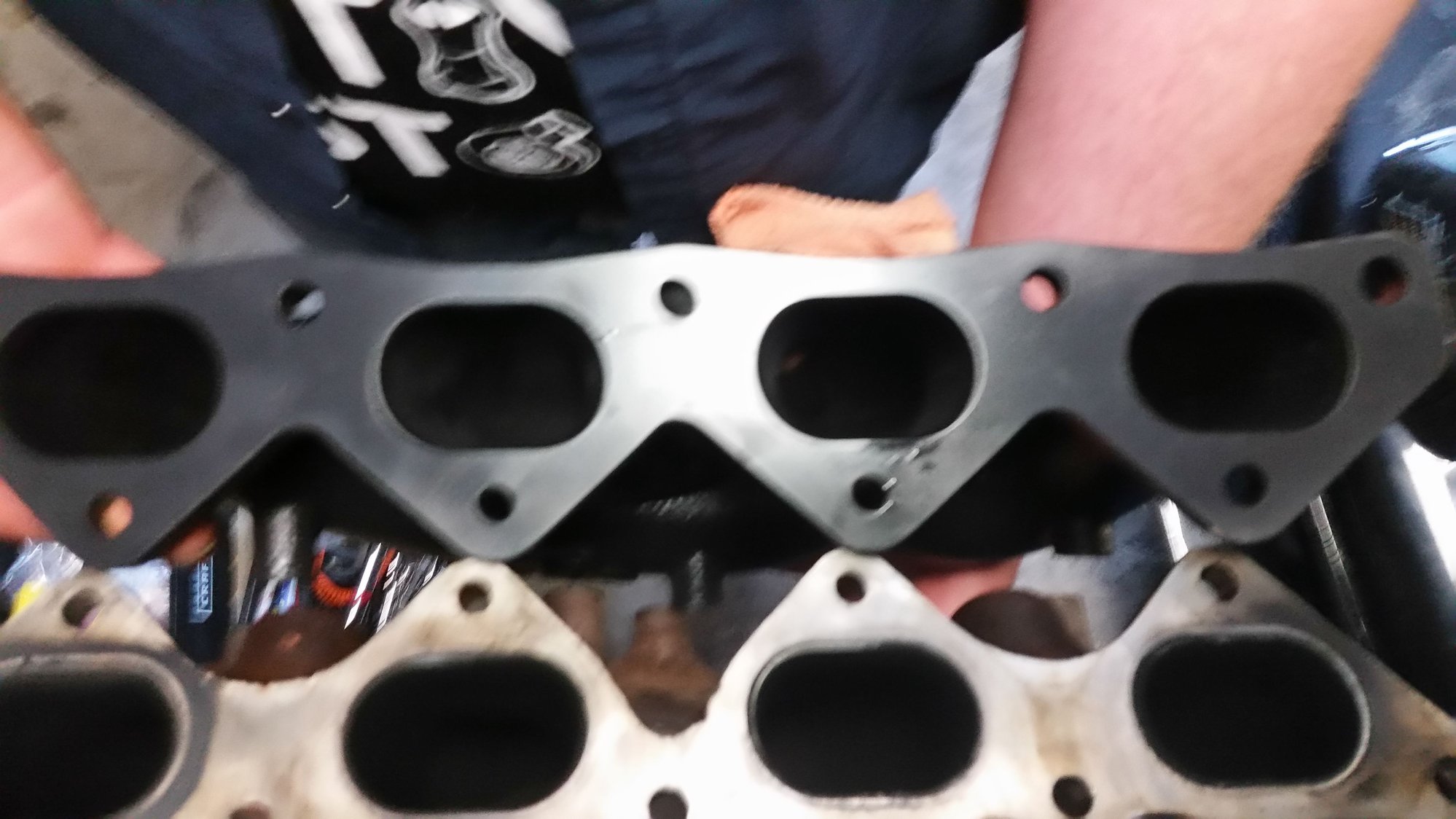

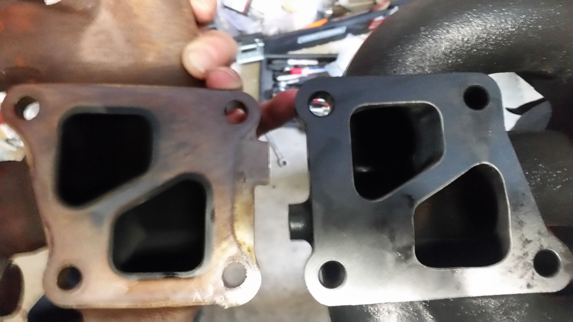

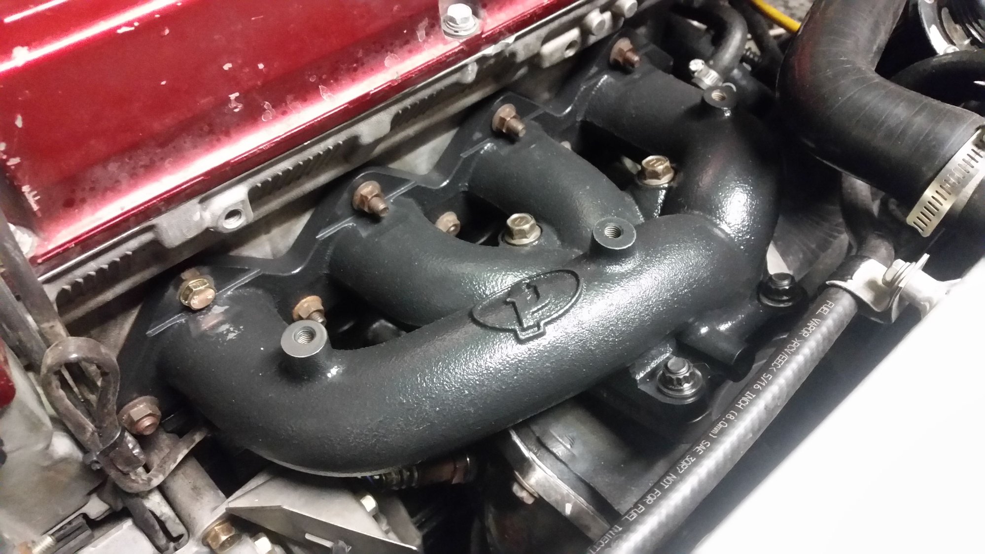

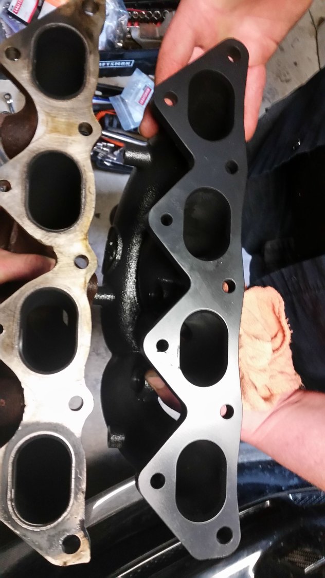

Hi, Recently purchase an FP Cast Race Manifold. Read up on here with several posts form the past. I decided to purchase one when most feedback was stating it was good in the 600HP Range. I have had tubular manifolds before, most under $500 and all have cracked at the runners. So my decision was a decent manifold with decent numbers, but cast. The runners are almost 25% larger than stock.
I will post more as soon as I fire it up and give it a run, see if their is anything in tuning that shows up and adjustment I make.
Here are a few picks. Install was straight forward and not hard at all. Do to a broken stud on my block, I had to tap the block screw and fix resulting in about a 45 minute add on time to install. All in all it took me about 3 hours, taking my time, and doing it the long route, unbolting exhaust down pipe, charge pipe, etc.
My pictures do not do it justice, should have held a tape measure to it to show perspective of larger runners. It is Ceramic Coated, and port matched on both sides for the block.
