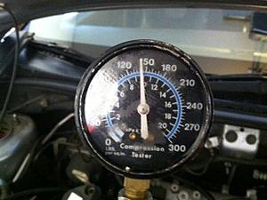

These were my plugs. Car has power again but still not hitting over 20 psi and still having misfire.
