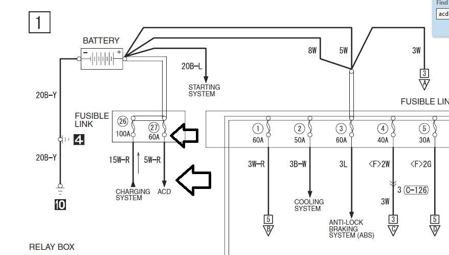

Hey guys,
Question if anyone knows the answer.
What current does the ACD Pump pull? And would it be possible to switch out the positive terminal fuse connector to two inline fuses without anything going haywire?
My fuse is currently toast so can't pull the current load.
I have a new positive terminal fuse connector on order but thought I would pose the question.
My understanding is the fuse connector has a 60A fuse, but please correct me if im wrong.
Thanks!

yes, 60 A for the motor

Old Mar 13, 2017 | 04:41 PM
Hey Declan
Pulled this image from the service manual to give you some written proof
Joe

Hey Declan
Joe
You guys rock! Thank you.
I would assume if I stuck a 60amp fuse in the line that it would do the same job, right?

it is the 60A fuse on the battery terminal..
