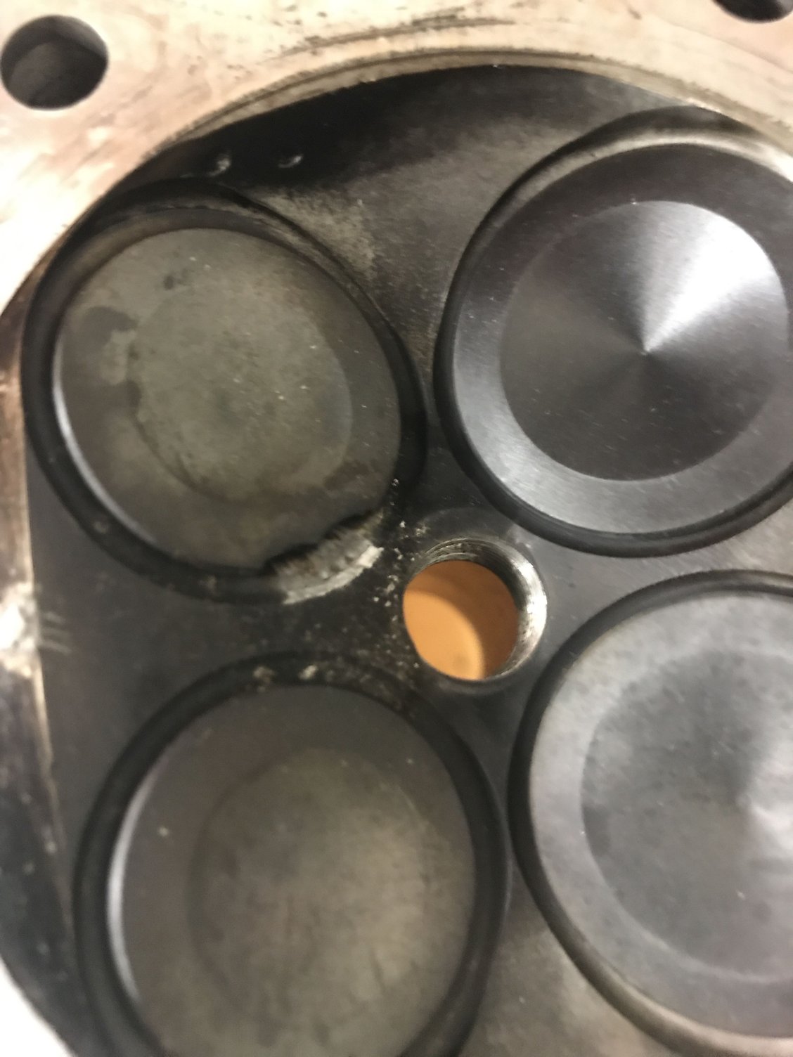

I have a 03 evo 8, fully built. Last year, during a road course event, i spun a rod bearing. My engine was built already with about 25k miles no issues. E85 with spark tech, FIC 1450's, fp red with all the supporting mods making 550whp. Got a new built shortblock, went with the new ss fp black and stock intake mani ported. That is all that i changed from my last build, no issues for 25k miles on that setup.

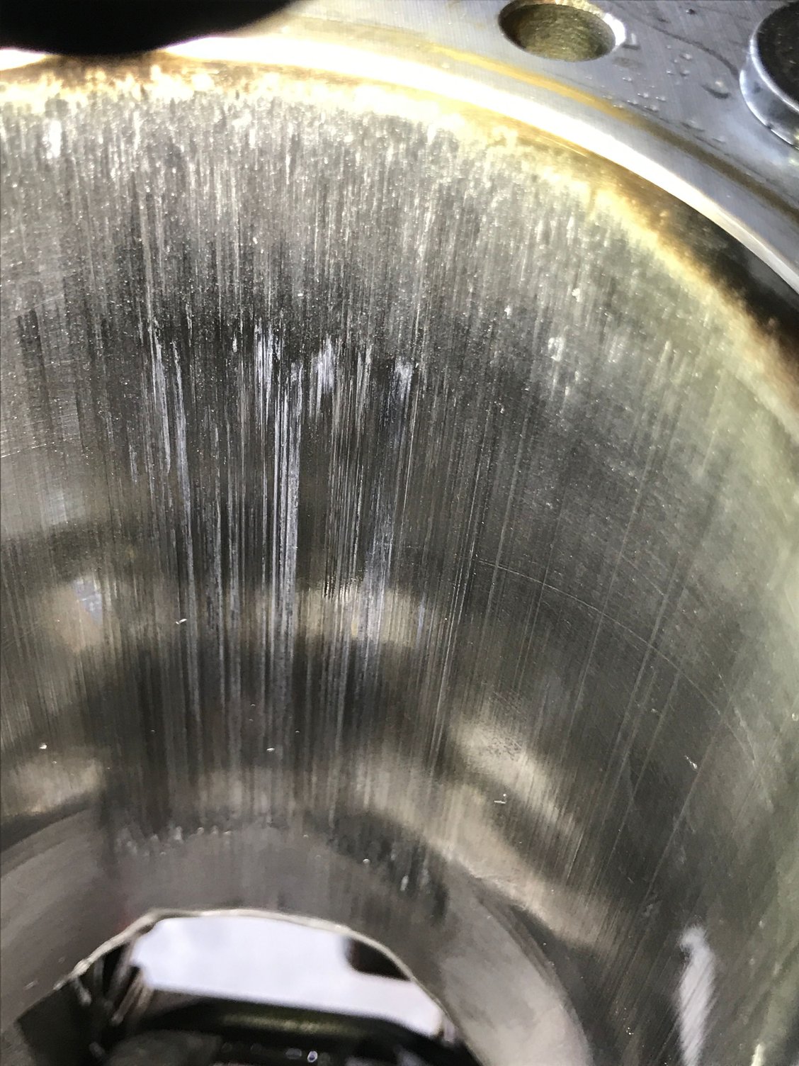

Ever since my new build, I've put on 400 miles and need new pistons and a bore. The first 300 miles, i blew a spark plug which also took out a valve. I got new valves in a week later, switch to iridium plugs, maybe put on 75 miles. Went to go get a dyno tune, first pull on the dyno. She eats another plug. Now my cylinder is down 25% compression. Haul it home tear it apart to find out i need new pistons now. I also noticed my crank timing gear got stretched over 1mm, i didn't think this would be the issue to cause such a problem but you never know either.
I've talked to a few different people and thinking its gotta be injector failure. Weird thing is i just had my injectors flow tested before my new build. These injectors ran perfectly fine on my last setup for 25k, bought brand new 5-6 years ago.
When it blew the second spark on the dyno, the tuner told me he's had injectors causing issues on customers cars, spending lots of money on new parts only to have the same thing happen again. They've sent those injectors off to the manufacturer to get tested and the results came back perfectly fine. They throw in a new set of different injectors and he's perfectly able to tune the car now.
I pulled my evo engine probably damn near 7-8 times so i know where every bolt goes and what not. its definitely not my first time. I bought new ID injectors, new coils, and getting my shortblock rebuilt.
I have many different pictures to show. One weird thing i noticed is the fuel spread across the pistons is a bit odd. starting at cylinder 4 to 1 getting hotter and hotter it seems. I have a FPR, 450 with a rewire but stock fuel rail and lines, but never had an issue on my fp red on 35+ lbs of boost and my black was only on wastegate at 20lbs.

Based off all the e85 notes ive read. Its knock resistant as hell. Id have to say it was a fuel pump issue. Since its not just 1 cylinder to blame a injector.
Old Aug 26, 2017 | 11:08 PM
4b11slayer's Avatar
Joined: Nov 2015
Posts: 1,787
Likes: 89
From: Santa Ana
The damaged pistons are the 2 farthest from fuel feed line. Looks like the pressure mightve been too low on cylinders 1.2. Just a thought. But youd figure all 4 injectors would have equal fuel pressure/supply in the rail.

The end result is melted plug electrodes, broken ceramics and melted pistons.
As per your photos.

What do the rod bearings look like? Your engine has classic signs of knock/detonation damage. Either too much timing, or running lean.
