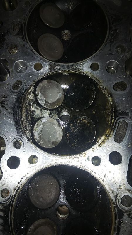

Approximate Date: 1/2/2015
Year: 2006
Mileage: 40,000k km on built motor
Modifications: Built 2.0L, AMS 900x w/ PTE6466
Power: 550whp / 380wtq
What Happened?: Destroyed the block, piston and rod.
Solution: New block, 2.3L built now making 800whp
Why?: I was running a 6266 then swapped to a 6466, without altering the boost in the ecu (was a n00b).. The car was running 34psi on pump and it let go at 9000rpm.

That's crazy!! I have never seen a hole in a piston like that of the #3 cylinder.
It could have been a wrist pin failure, because there is no signs of detonation on any other piston. I still have all pistons and rods.
