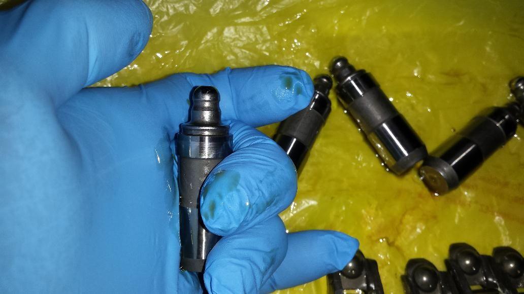

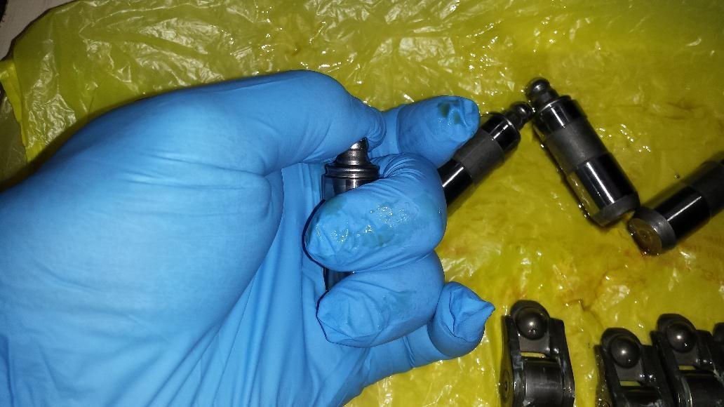

Old Dec 26, 2017 | 05:06 PM
OX's Avatar
OX
Posts: 495
Likes: 27
From: central NJ
So I pulled both sets of cams and lifters back out.
They seemed hydro-locked, just like they were
with oil when I first pulled them out.
So maybe the diesel compresses a bit more than oil,
but I wasn't taking that chance. I compressed
internal valve just one time with lifter upside down,
and then I could compress lifter by hand easy.
Just for kicks, I totally emptied one lifter again, and it
takes 4-5 internal valve compressions. So you can
still have lifter pretty full to start, with only one
compression (after complete fill) and have them compress.
Best of both worlds I'd guess...........
For kicks I took picks up fully extended and how
far they compress after just one release of internal valve
