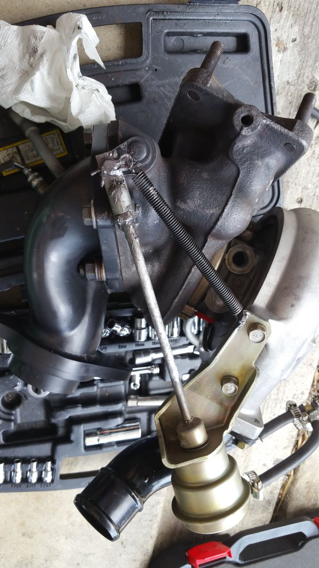

The Evo 9 bracket fit, but the rod of the actuator was about an inch to the right because the lever arm on Evo 9's rotate to the right not left. Maybe I could use an Evo 9 bracket with the Evo 8 actuator.

It's strange how there isn't a kit made for this. You can't be the only one doing this.

Yeah, seriously. Just talked to my buddy. He's just gonna look for a 10.5 hotside and eliminate this problem. He still has the Turbosmart Evo 9 WGA, so we could just bolt it right up and be good to go. Do you know of any sites selling a 10.5 housing? I've just been looking and the few sites I found them on were out of stock.

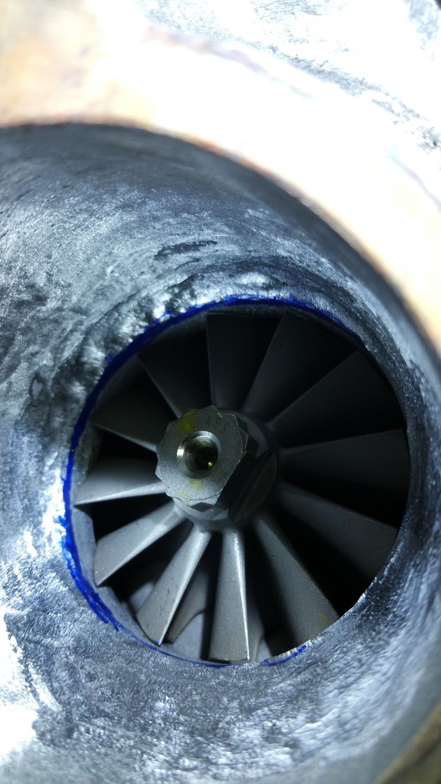

If you find one, consider porting the exhaust impeller port closer to impeller. This is what I did (when I was done, the shelf was barely taller than impellers-blue ink was shaved down):

Here's my HTA71 before it was installed.
