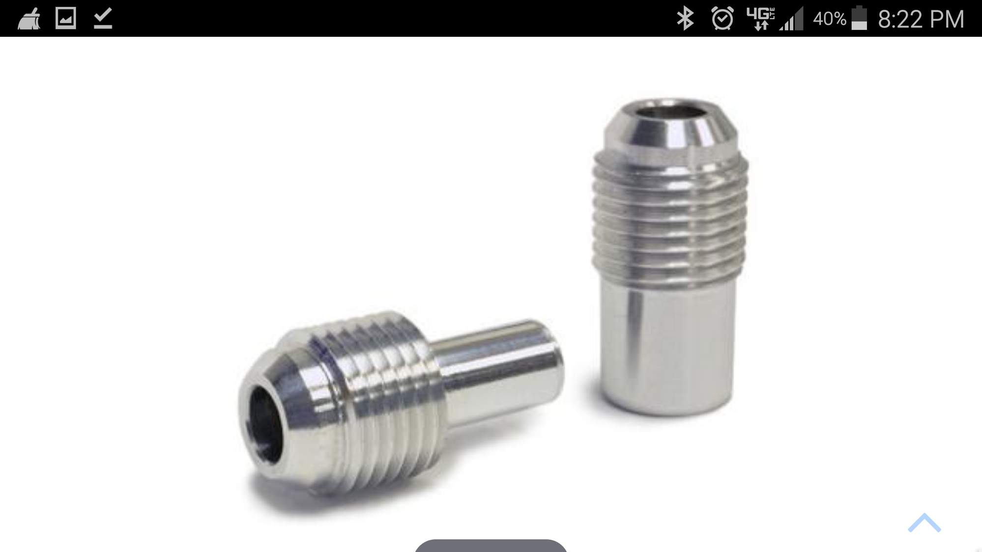

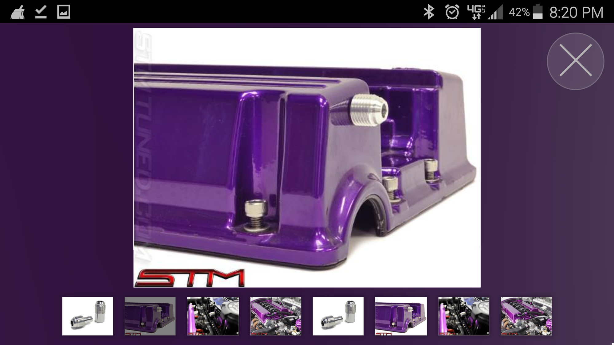

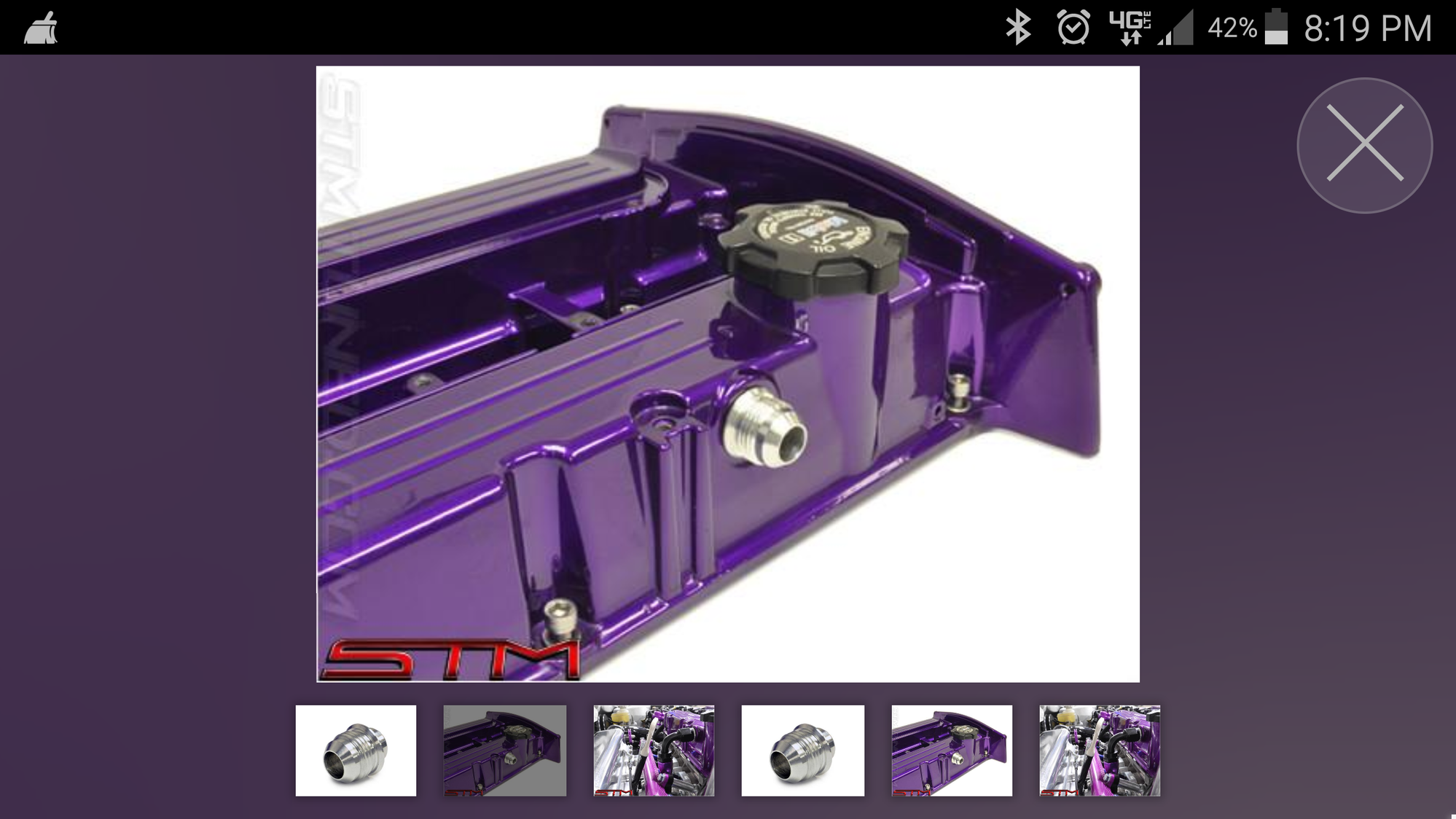

Originally Posted by sunnyhillkid
thanks for the help ill have to look into it when you say vent the vave cover i have to get an aftermarket vented cover
just the replacement tubes. I'll load a few pictures.

STM has a huge 10an for the rear vent next to oil cap. Only problem is you'll have to remove your factory PCV.
