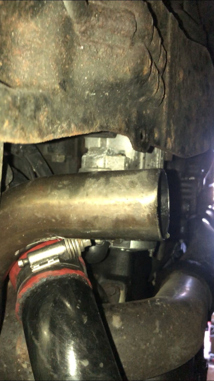

im not sure what this is but i think coolant is coming out of it

That looks like a dump tube for your turbo. It's probably only water vapor from your exhaust when cold.

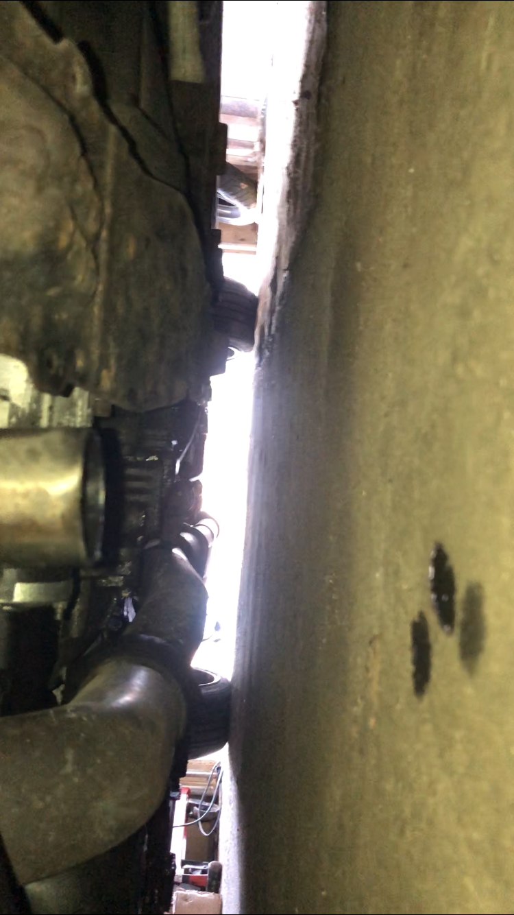

You need to provide better info for us to help. The only pic you posted was of oil on the ground near the dump tube. This could be a bad turbo oil seal. Does the car blow a blue'ish color out of the exhaust when you driving or at idle after a WOT pull? If it were bad valve guide it would be a lot of smoke all the time. Also possible misfires. My guess is the turbo needs to be rebuilt.

the oil wasnt coming from the dumptube it was coming from under the diostick im pretty sure coolant is leaking off the radiator and onto the dumptube because it doesnt really look or feel like oil i dont think my car is a lemon i think it just may need some tweaks the whole head was rebuilt not long ago with piston replacement so the pistons and rings should be ok

Wipe down everything. Then look for leaks around oil and coolant lines to turbo. If you're leaking around dipstick, definitely check out o-ring. If good, start going up to valve cover gasket. Again, make sure you clean everything off first before looking for leaks.
