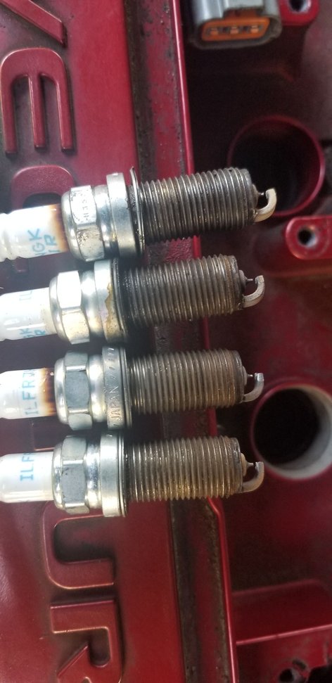

- Pulled the spark plugs (they were about 1 year old) and they looks a little burnt (pic below)
- Swapped new spark plugs and no help
