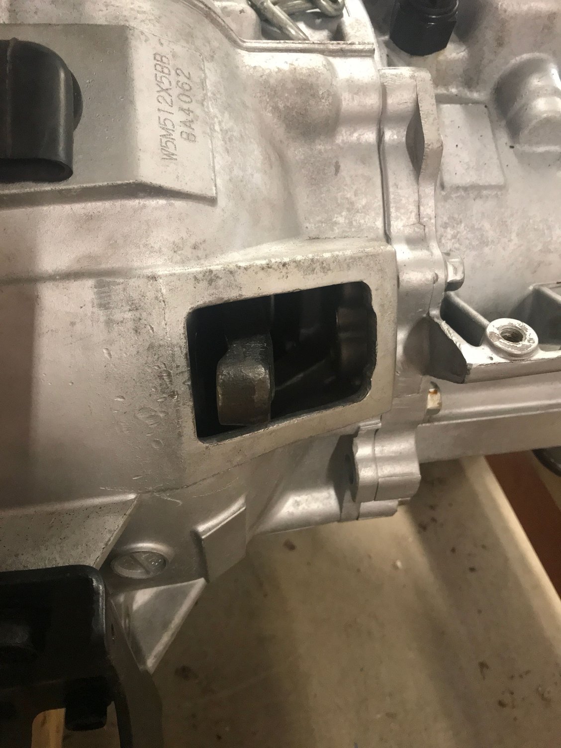

I know this subject has been beat on and I’ve searched and read all my little brain can comprehend. I’m mating the motor and trans back together and I can get the fork to seat in the middle but it doesn’t take much pressure to push it back to the passenger side of the car. I can move it with my finger. If it’s seated in the middle, I can push to the pass side of the car and it clicks and moves toward the pass side.

Put a deep well socket over the end of the arm and give it a good tug. If it doesn't lock in you need to pull the transmission and check what's wrong.

I’ve done that and tapped it with a block of wood/hammer, it won’t go any further to the driver side then the 1st picture. It will hold in the middle but it doesn’t take much pressure to push it back the the pass side, 2nd picture...

It sounds like you have an issue with your TOB or the clip on your pressure plate. Time to pull the trans and inspect.
