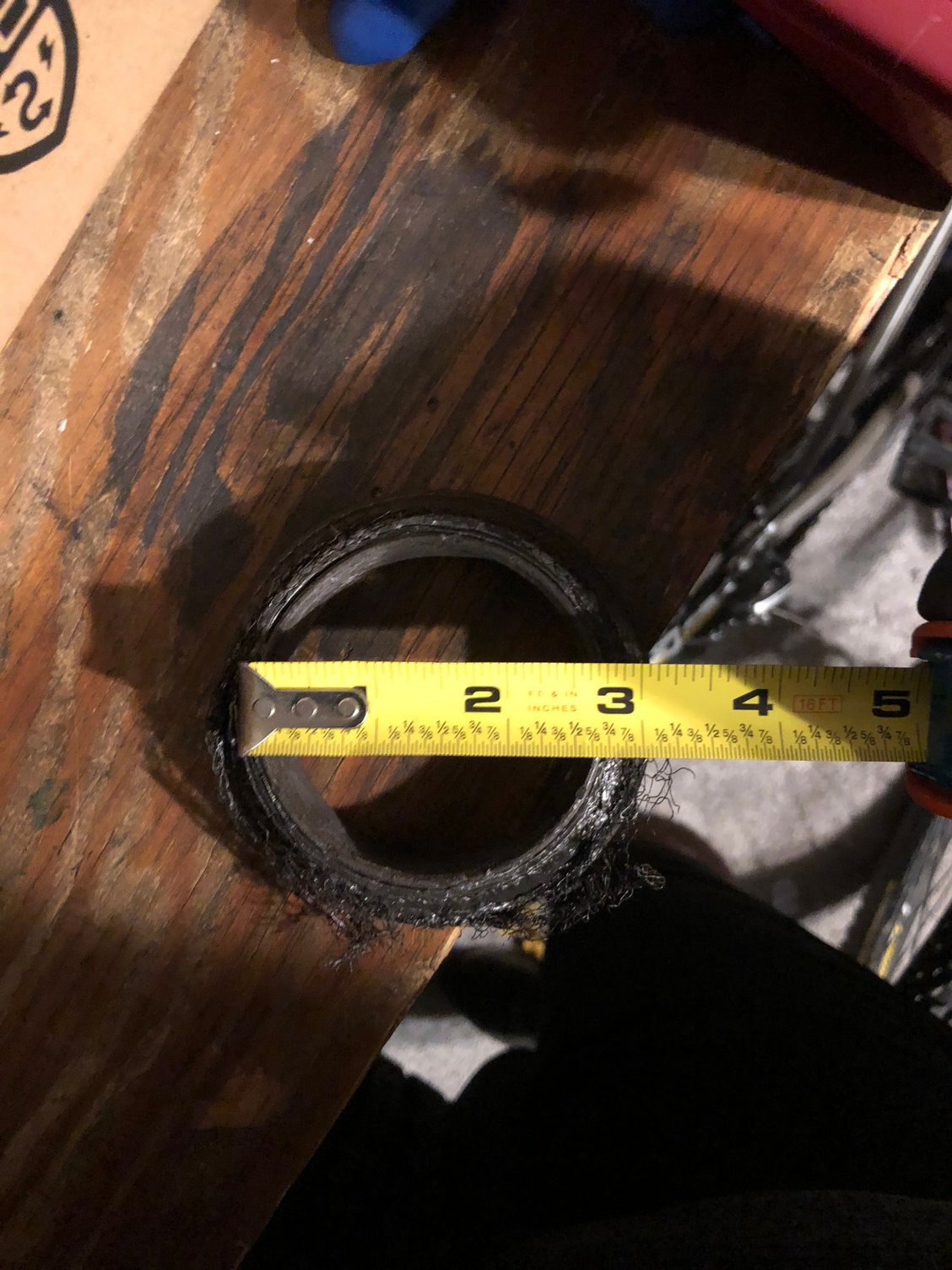

Heres some pics of the donut gasket on the adapter with measurements

Just looks like you have the wrong size. I think I got mine off of ebay, or something. I run the donut gasket and the OEM spring/bolts and have never, ever had an issue with leaking. Maybe your o2 housing isn't actually 3". Sometimes they come in 2.5" (like the Titek on my car).

you can kinda see it in the pictures I previously posted, it’s actually the piece that the donut gasket is around in the pics. I’ll try to find a generic pic similar to it online because it’s on the car rn LOL
I dunno. I see a cardboard box.. a piece of wood, an exhaust "donut" gasket, and a tape measure.

were you able to see the picture I just posted? With the metallic adapter thing? Or is it not showing up?

Green is the donut gasket, which is crushable and is composed of some sort of metal netting, just like the oem donut gasket (but this one is larger). Purple is the adapter, which the larger donut gasket sits on top of

I know Works has an adapter they use when mating their 3 inch downpipe to their o2 housing. Its bigger than that piece is. Yours looks like one i got from Autozone, that came with a thin sleeve in the moddle. Works is a true 3in inner diameter gasket and yours looks smaller. You need to get the inner diameter and find a gasket with the same if you want a snug fit.
