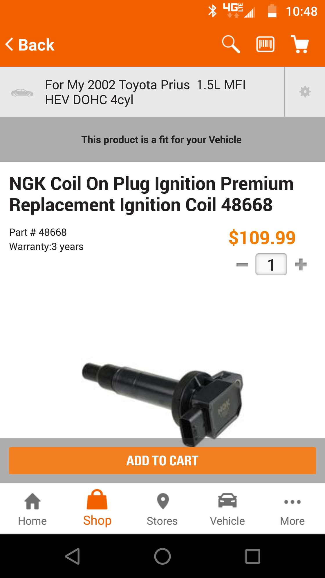

So sorry for the super late response. I added ground wires from fuse box to battery and firewall to valve cover. Blew out a coil in 3k again. I was looking at AutoZone for coils and it shows they have A ngk coil pack replacement with a 3 year warranty. Has anyone tried this brand of coil for the cop
