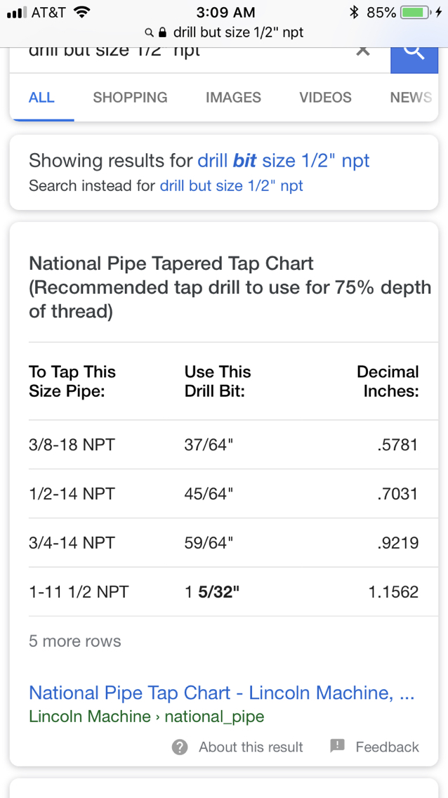

1/2" pipe thread is a smidge bigger than 17mm. Can drill it to size, and tap it for 1/2" NPT.
Actually 1/2 NPT is quite a bit bigger. NPT 1/2 is around 21mm, and 1/2 regular thread is around 8mm. I need a fitting around M17x1.25 ish.
The DRILL BIT size is very close to the hole. Drill, tap, send it...
25.4mm (1") x .7031= 17.86mm
You're not going to find a specific fit fitting. That is a custom press for fitting mitsu designed. good luck.
