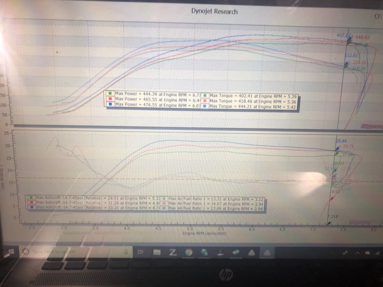

Gents,
Sorry for the delay! Went with the green for now. Spoke with FP about different options and might consider a newer turbo down the road. Here is what the car made for now. Didn't reach my power goals, but maybe I'll drive it for a bit a see how it feels.
