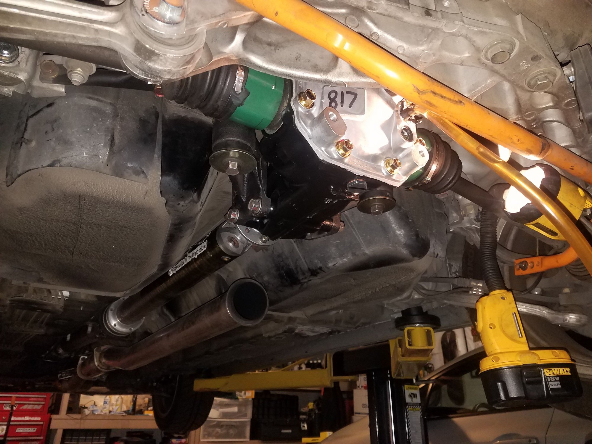

On the bright side, I got the diff back yesterday, so ran it to the garage and tossed it in. It's quieter (OEM had a bit of a whine, after adding poly bushings) and makes zero noise during full steering lock u-turns, which surprised me.
It sure is clean and pretty. I really like that he puts in new bolts. Dirty, old ones are always a pet peeve of mine I'm tempted to buy myself a solvent tank. Aaaanyway....
I was a bit concerned because the box was a bit beat and I could feel the diff rolling around inside. Anyone remember the shortblock I ordered? LOL. So, I opened it up and it was pretty much all in one piece, so I was relieved. It definitely had a rough trip. Having worked at UPS, I'm not surprised. The bag it was in had torn and foam packing material was inside the diff. I blew out what I could, but assume it won't harm anything until I do the 500mi fluid swap.
It ended up with the billet side cover (both my OEM covers were toast):
... and the addition of the sight glass to the rear cover (I left it because I felt bad that he'd have to disassemble everything, plus it saves me a couple paper towels during fill up). It ended up being twice the original quote, but then again, my transmission did, also (different vendor); it is what it is. I can't wait to see what kind of shenanigans the t-case turns out to provide The only "negative" to the differential is the fill plug is now tucked up near the mustache bar (the next thing to go). Depending on what type of pump you use to fill, this may not be a big deal (mine has a fitting on the end that took some work to get in and out). Also, I didn't have a 24mm box-end wrench, so I had to use a large Crecent to "torque" the fill plug. Using those always makes me nervous, though LOL.
All-in-all, I'm impressed with the assembly and can't wait to try out the actual "good stuff".
TLDR: Packaging concerned me, given past experience with shipping companies. Turned out well. Diff looks great. Nice attention to detail. Send your stuff to TRE. Runs quiet.

Dec 22, 2018 | 12:42 PM
Nice work there Jason. Great looking piece for sure!
BTW, nice driveline
Reply 0
Dec 22, 2018 | 01:40 PM
Quote: Nice work there Jason. Great looking piece for sure!
BTW, nice driveline
I picked it up for a steal. Couldn't resist. One of my very few "didn't really need it" purchases.
