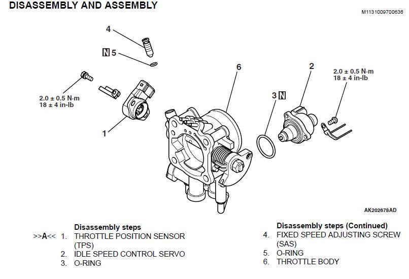

Possibly the idle controllers on the throttle body. See item 1 or 2. Its 13A of your service manual
Just a thought

if thats the IAC ive already replaced it twice. Once because it was actually bad and the second time because of this issue but its still ****ing with me
