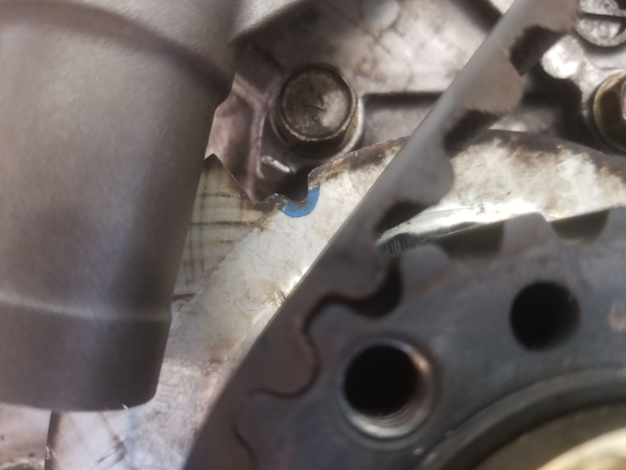

Pics for reassurance!
Heres some pics of whay i have.

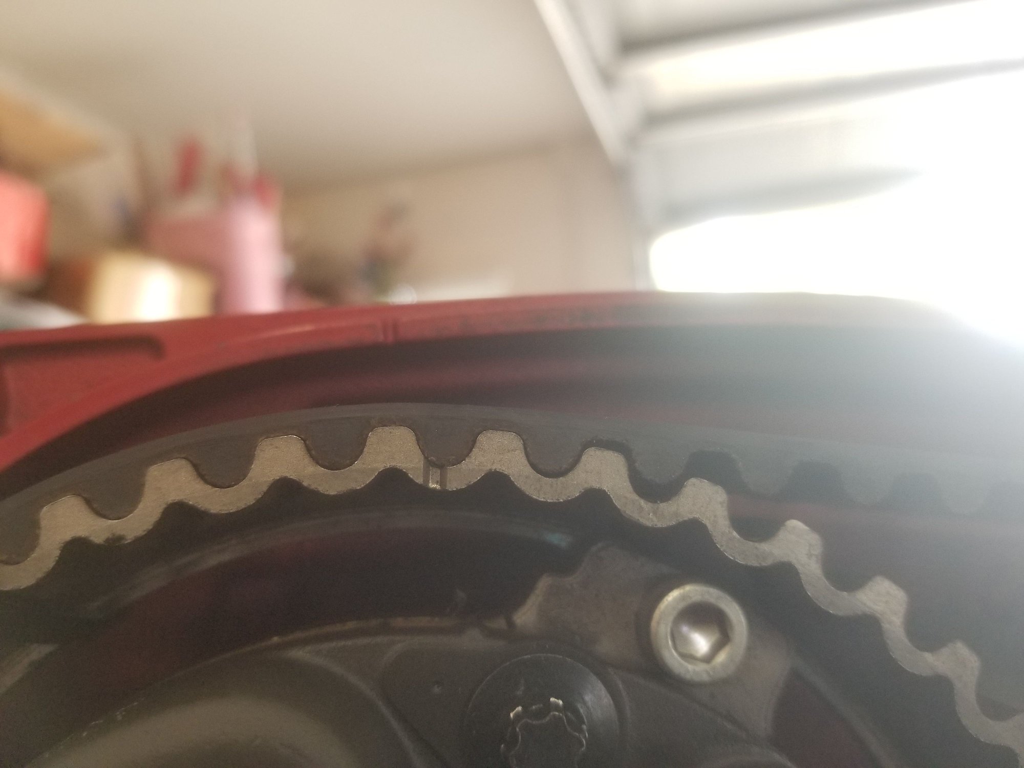

Old May 20, 2019 | 04:38 PM
joey pierce's Avatar
Joined: Jul 2018
Posts: 98
From: Roseville
New marks. Adjusted mivec gear.
Old photos ornnew correct?

The new pics are correct.
