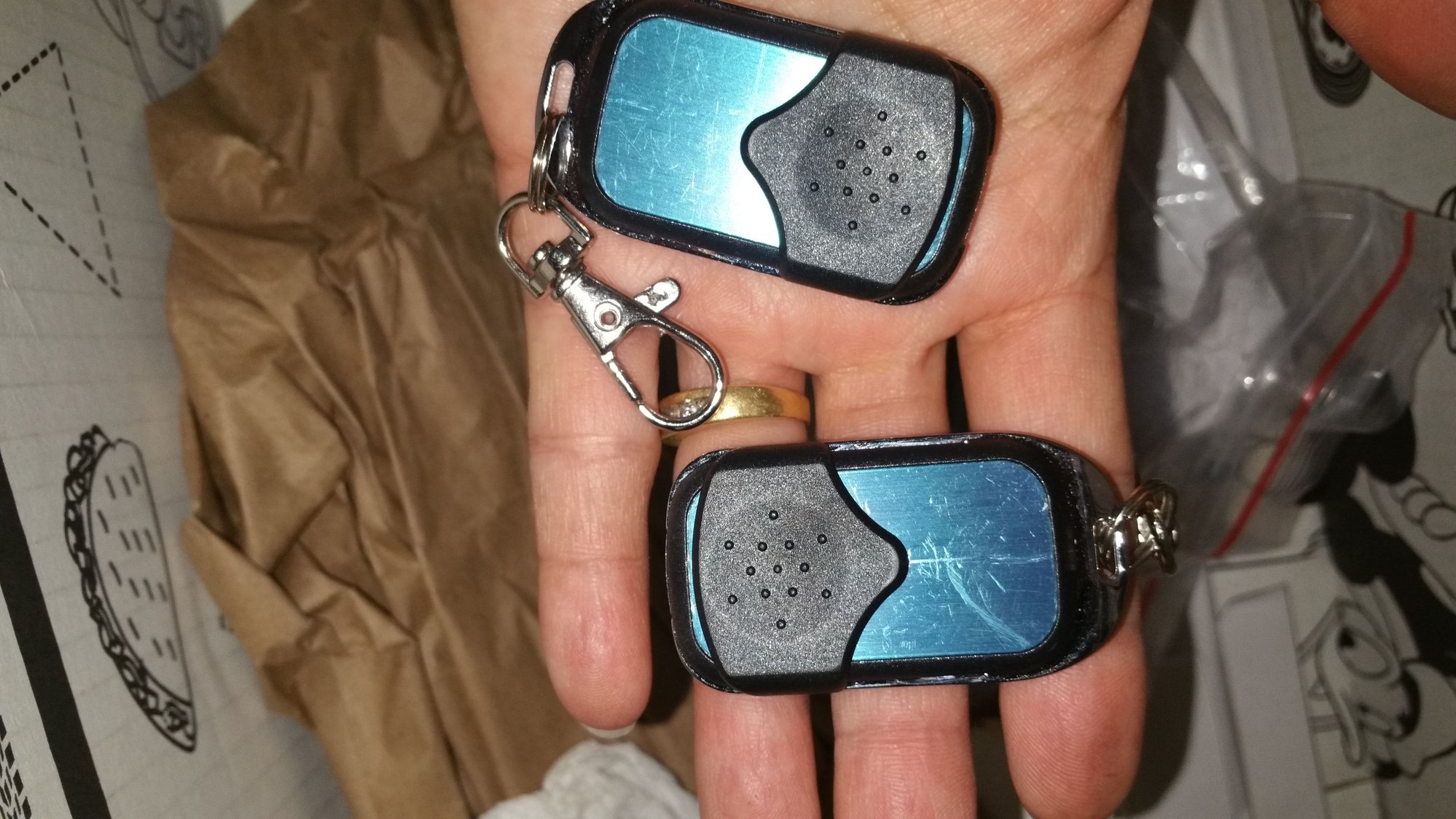

Old Aug 6, 2019 | 07:56 AM
240Z TwinTurbo's Avatar
iTrader: (25)
Posts: 2,810
Likes: 329
From: Charlotte, NC
^ It definitely works...
File Type: mov
