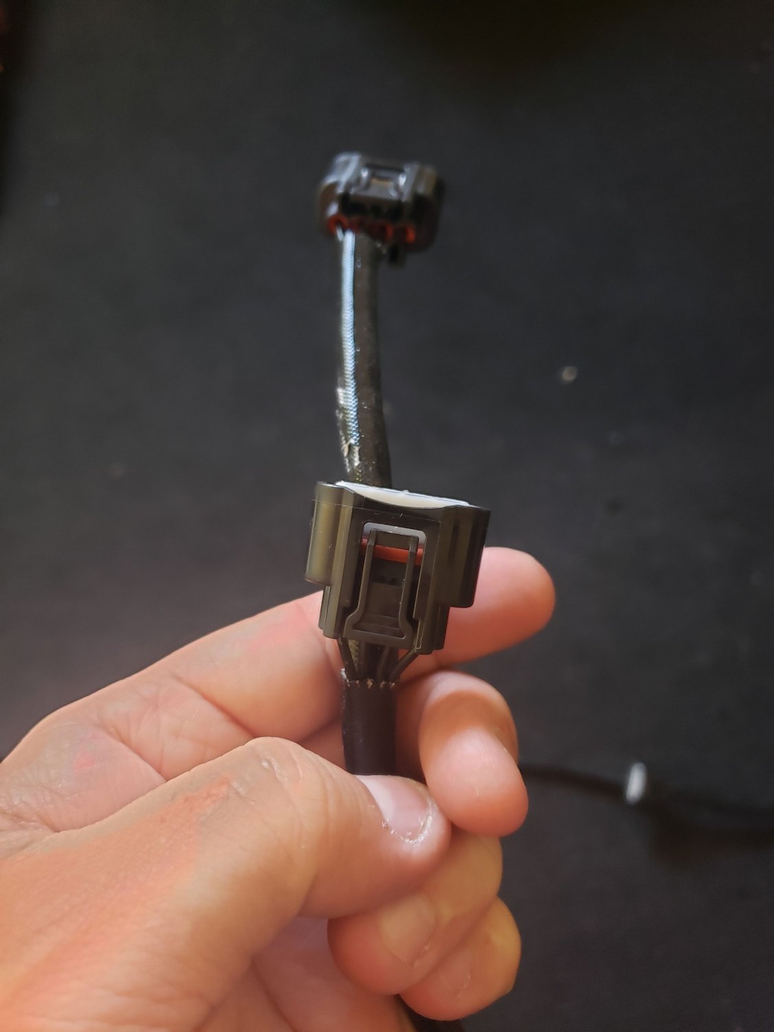

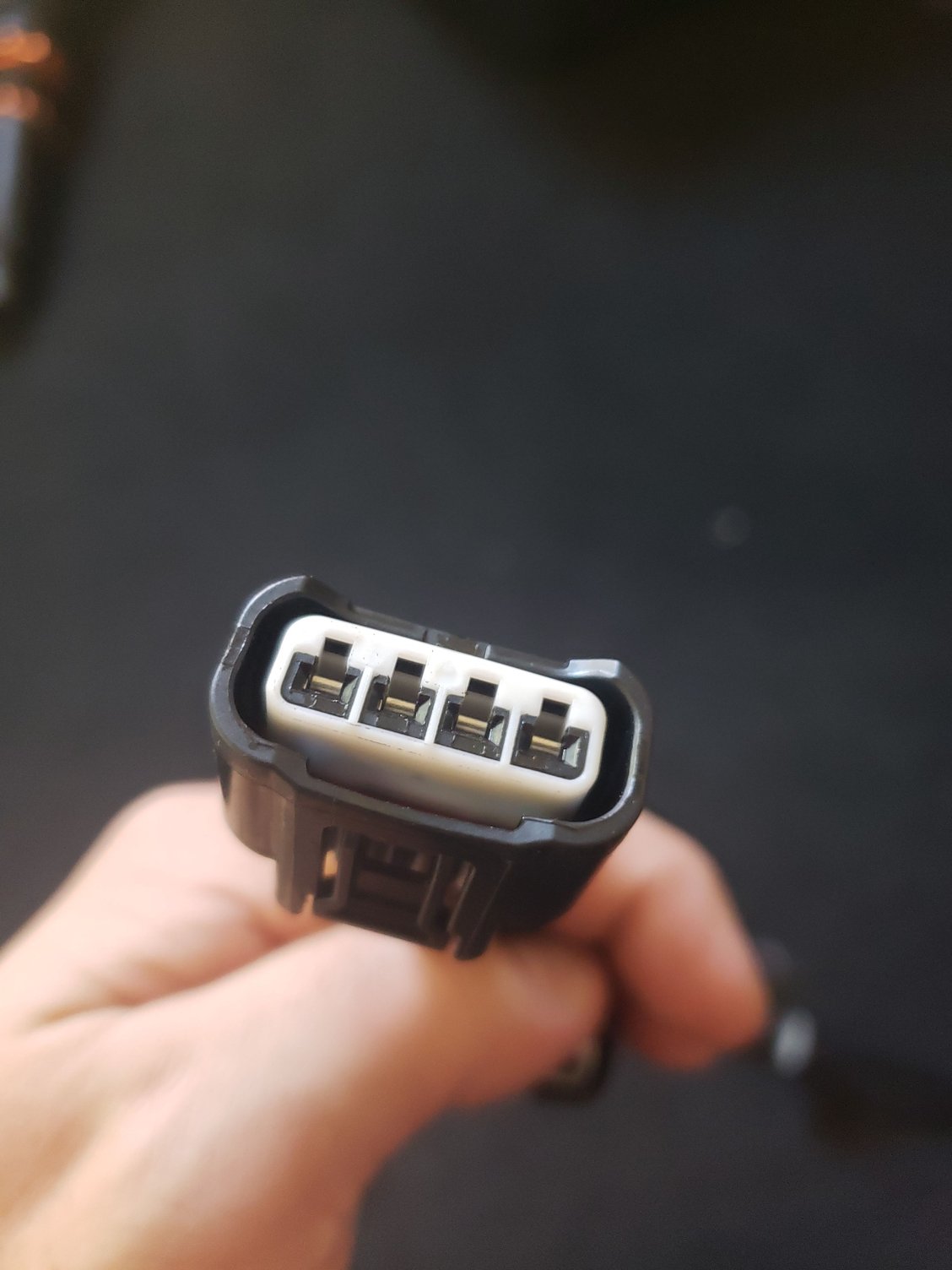

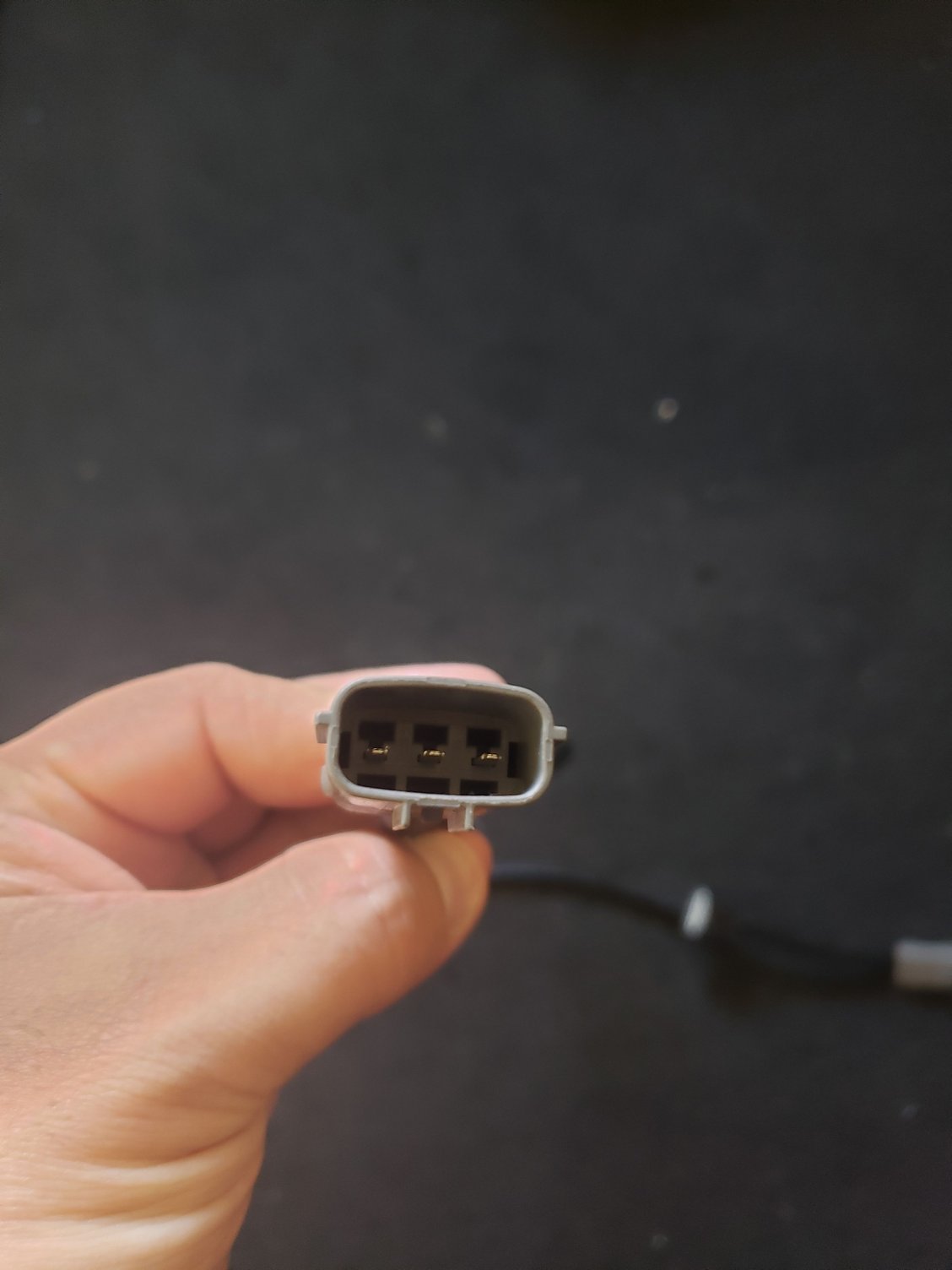

What's up Evo fam, So I just made a COP harness and I know I did it right, I went and double and triple checked my work and made sure all the pins were in the right place. I have brand new Denso Coils PART# (90919-02240). This is on an Evo 8 and after installing everything and trying to start the car, the car did not start. so I went and checked my work again I pulled the harness both of them and re-did them again and checked and made sure the harness was made correct. So at this point, I pulled the plugs and there is fuel on the pistons I installed the stock coils and the car started right up and burnt all that unburnt fuel in the cylinders. So I know the car runs and starts perfectly with stocks coils, And there is no issue with my CPS. So again I installed the COP kit again and this time it acted like it wanted to start but did a Lil backfire so again I took the harness apart 100% and started all over again. Car is on E85 and it's tuned there is fuel and everything works 100% confirming with the stock coils. I already checked the fuse in the car and it's fine I know I need a 15AMP fuse but even with the stock 10AMP fuse, I know the car should at least start. I there anything that I missed that someone can point me in the right direction? I am going to be checking to make sure the coils are working with a Voltmeter and see what results I get back. Any info will help thanks for your time.

Yessir, I also did that but I think the coils are bad! I installed the coils from my wife's Camry and the car started and ran perfectly. So I just got a ****ty pack of Denso Coils. New Coils are on the way thanks for the input.
