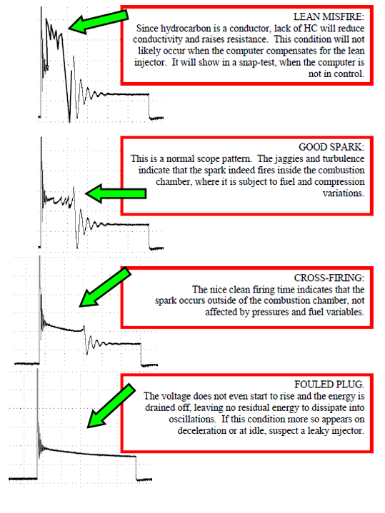

The right way to test a coil is with a scope. You can see so many things that are going on:

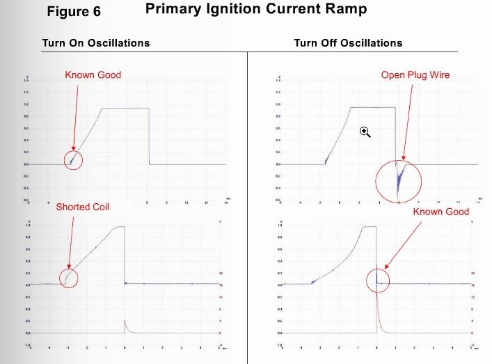

Similarly, with a inductive current meter you can see the things you are most likely to have on a bad ignition coil:
