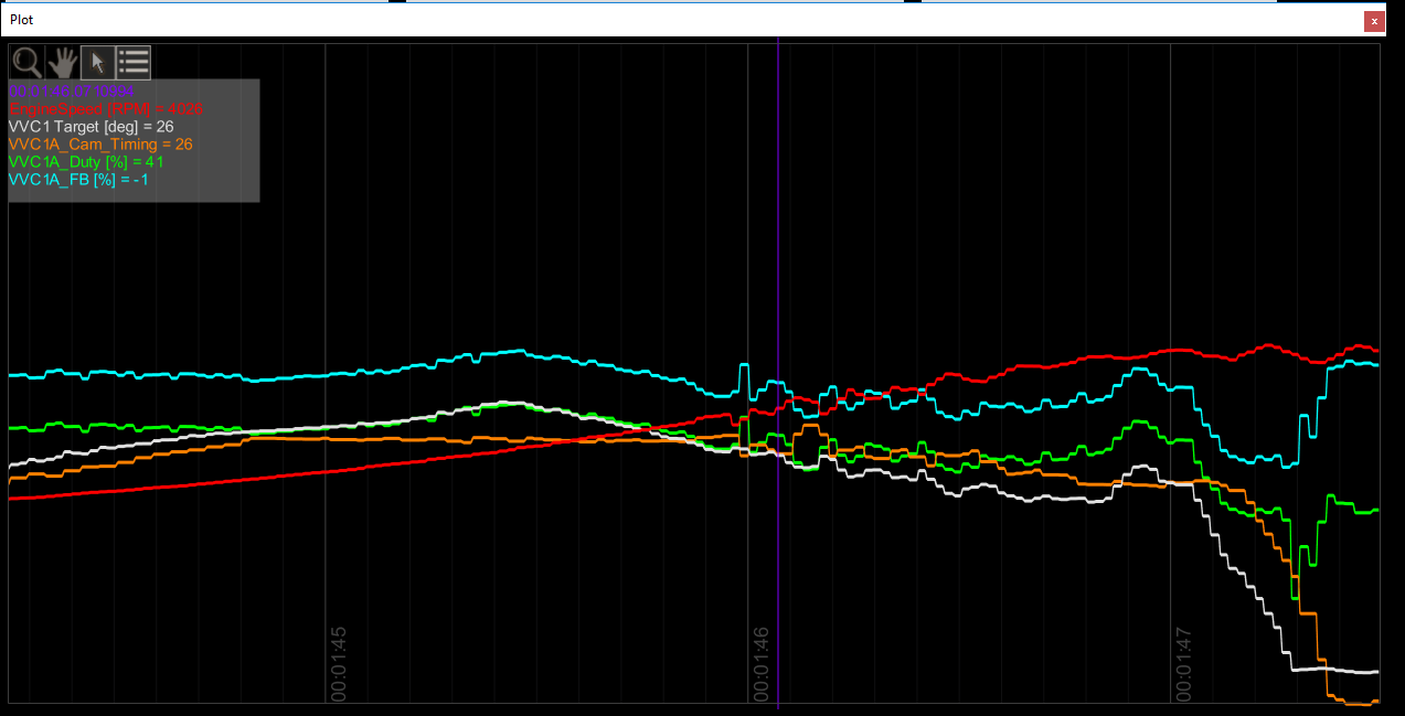

Dallas - Not too sure what a failing cam sensor should look like on a graph. If you look at mine, the actual timing vs target timing stay within 2° of each other. I would think that there would be a bigger split then that if it was going bad. I dont know though.
Thanks for the link too. It says that most people were having the issue at 4500 rpm and I am very close to that at 4000 rpm. I will have to see if Soso will let me borrow his sensor to test! I am going to try a different MAP sensor either way too.
So the thing Im not 100% sure on is what the ECU uses each sensor for. It could be that the crank sensor is giving you that position, the intake sensor is timing MIVEC, and the exhaust sensor is timing spark (Hypothetically speaking, I really dont know on this one). But its possible what the ECU is giving you there isnt the same as whatever the Exhaust sensor is doing.
Seems Mychailo later in that thread had some misfire pop up again and it happened to be injector gunk. Either way, Im going to get some extra sensors to keep in the spares box just in case since mine are 13-14 yrs old now.

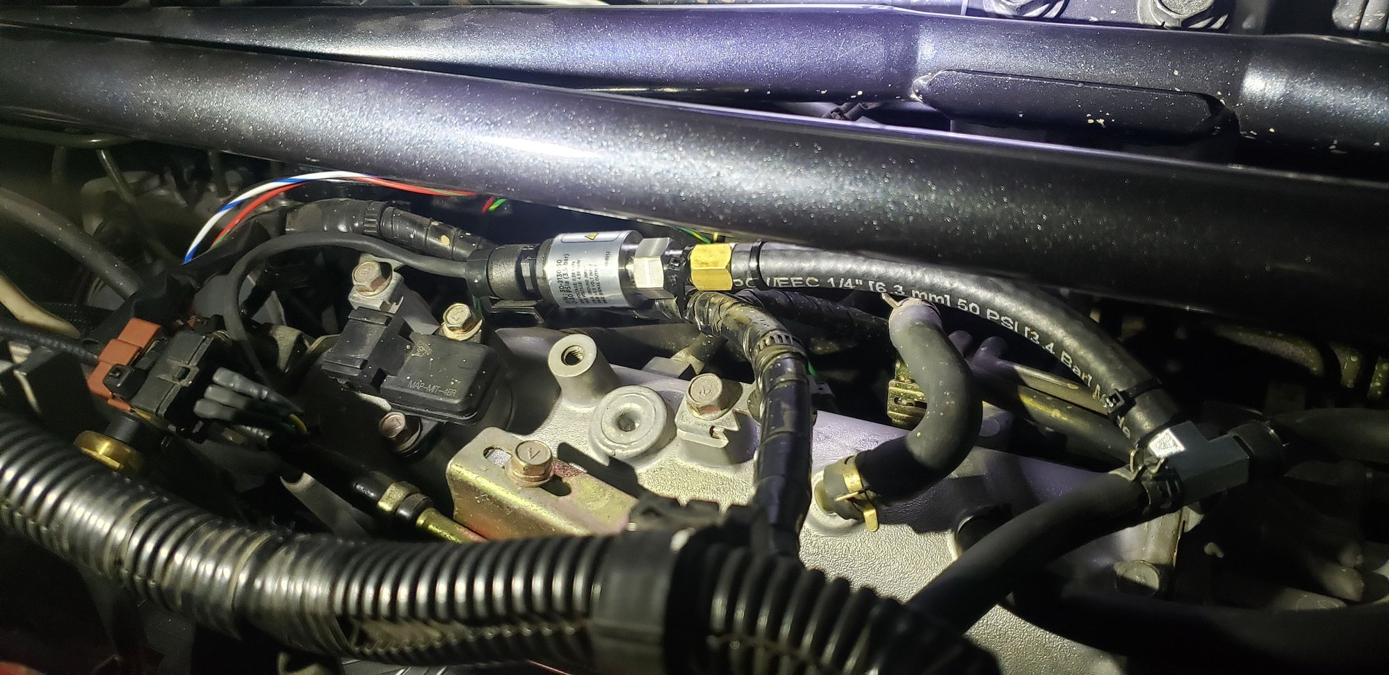

My AEM map sensor came in today. With my discount, it was actually cheaper then the OMNI was.... Whatever. I will rig it up for a test and if it solves my issue, I will hard wire it in and mount it correctly. If it doesnt solve my issue, im going to inspect the plugs and do a compression test.
I drove the Evo again today and the issue is getting worse by the minute. Once I hit around 1.5 bar boost, it starts cutting out and wont stop. If I keep it below 1.5 bar, everything works as normal.

New sensor is temporarily in. Map selection changed in tune. It starts and runs. Tomorrow we find out if the issue is fixed.
