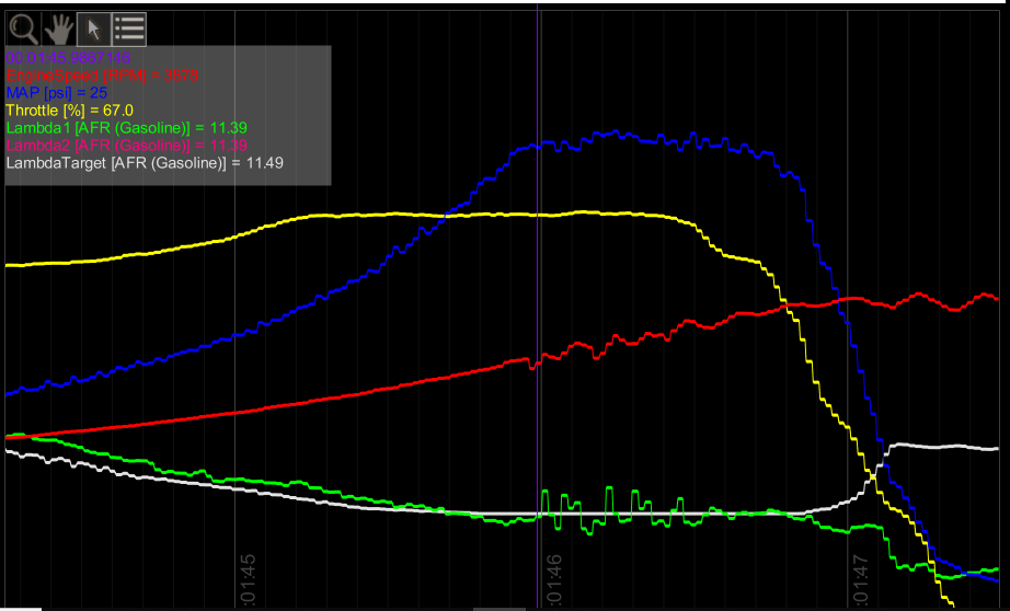

Before I got my OMNI MAP sensor, I was told it was going to fail in a short amount of time. I said whatever, I am going to try it anyways. Well, I have a feeling all of you were correct like normal. I just wanted to see what symptoms everyone was having when theirs failed to pin point if this is truly my issue or not. My issue is that when I am transitioning from vacuum to boost, the car will hesitate and backfire once or twice and then go like normal. I am going to say it happens when I hit around 20 psi. If I go from 5 psi to 20, all is fine. But when its below boost and I go into boost, it happens. This issue has slowing been getting more consistent. Before, I could only get it to happen once every couple times I drove the car, rare enough that I couldnt log the issue. As of today I can pretty much make it do it on command. Has this same thing happened to any other OMNI users? What symptoms did you guys have as your sensor went out? Thanks.

Well I dont think its the MAP sensor. You can see where things start to go crazy and then I let off. Everything stays close to where it should be but you can see something is indeed going on. This is going to be fun to figure out. I will try a new MAP just to rule it out.

Unless you know what PSI should be what load. It's hard to tell.
I'm still saying map lol

I dont know if my ECU supports load calculations or not. Right now it based purely off of boost and rpm.
But with the afr, timing, boost level and rpm staying steady, it's hard to pin point it to the map sensor. I would think I would see a big spike in the graph if the map sensor freaked out. You have to keep in mind that the logging rate is 1000x faster then you can do with an OEM ECU. This shows everything without missing anything.
No I get it.
Usually in the stock ECU you'll see boost not be correct for load. Or AFR at wot will be change, or the car just acts weird and theirs no codes, like what you're describing, hard to start, poor idle, dying a lot, etc...
