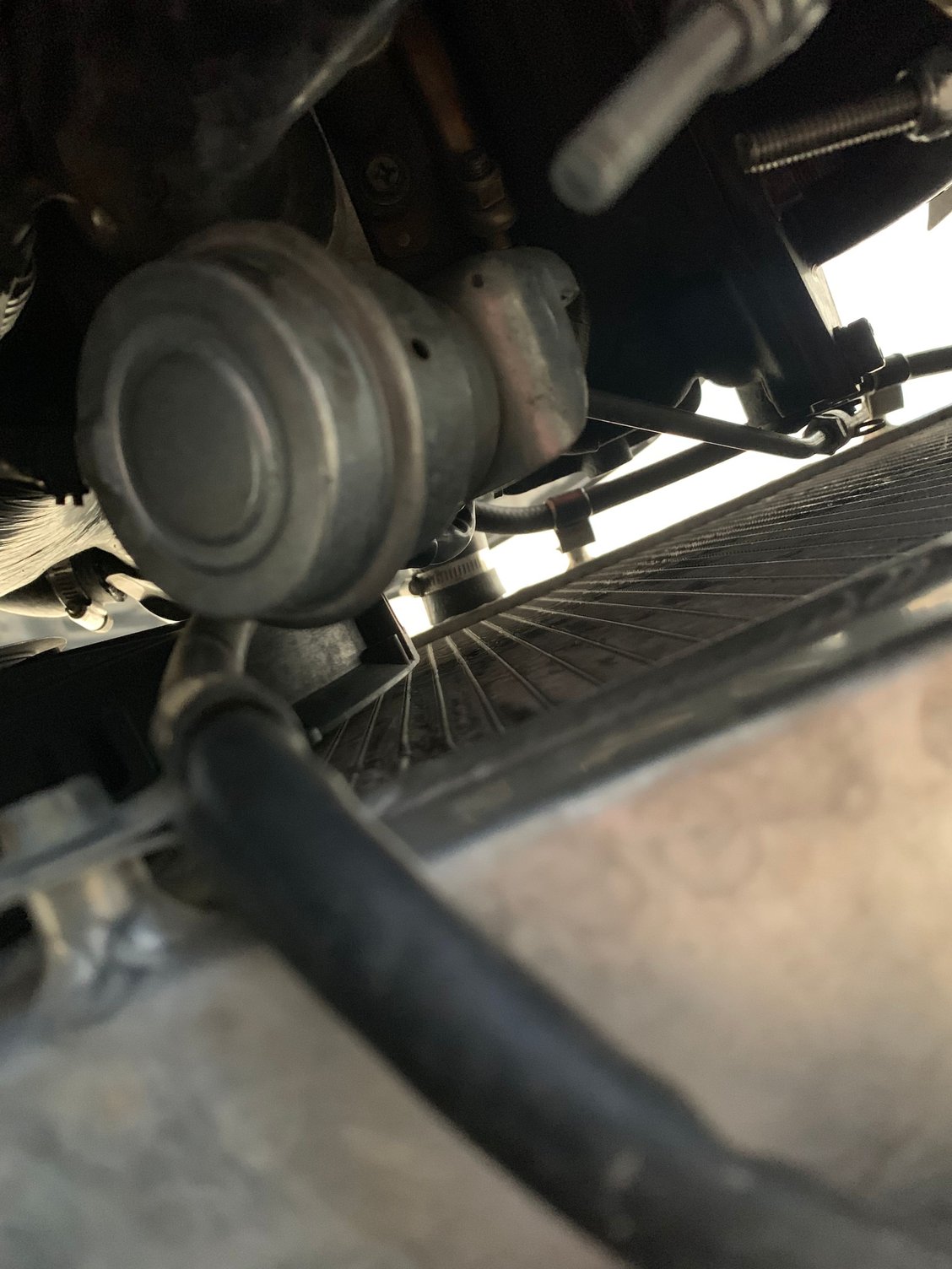

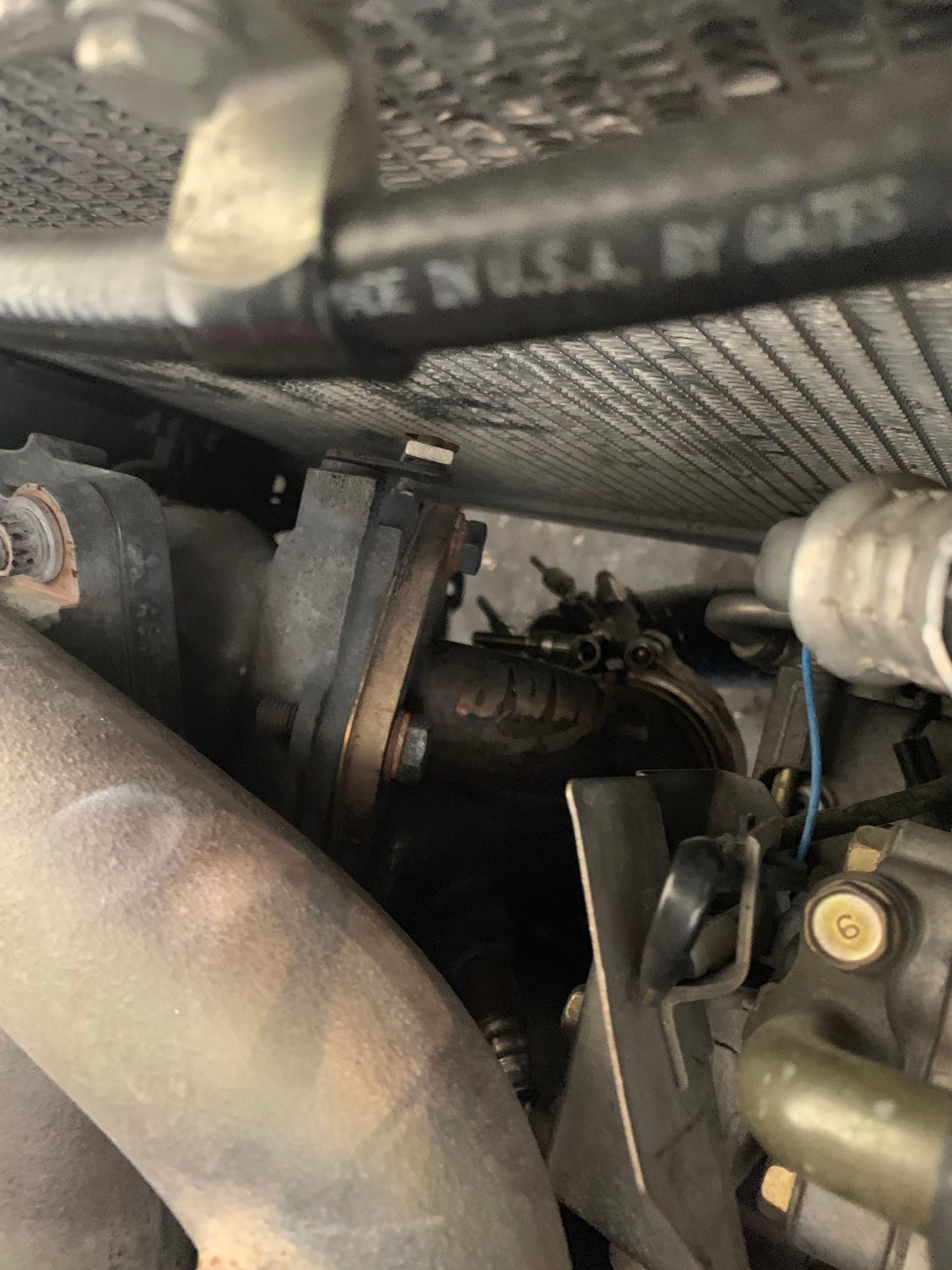

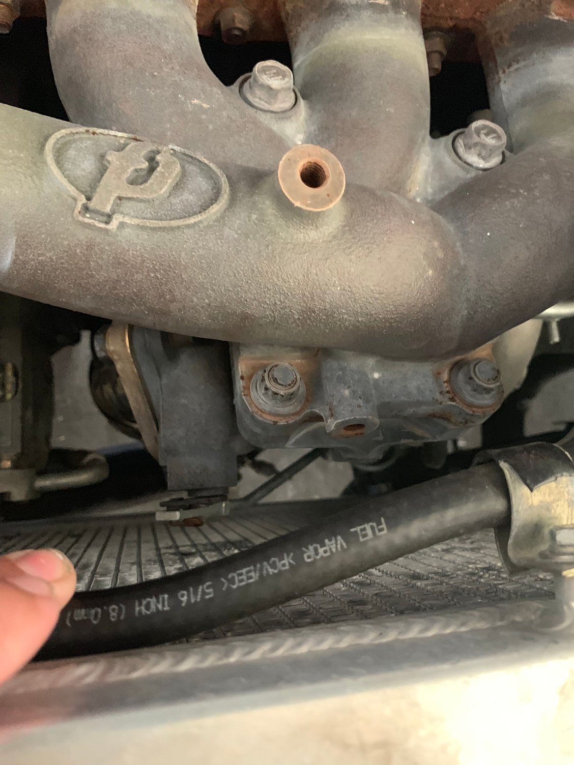

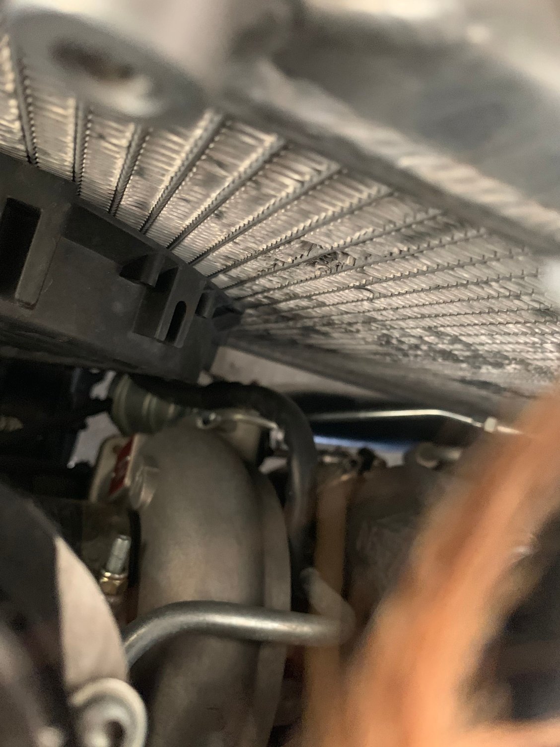

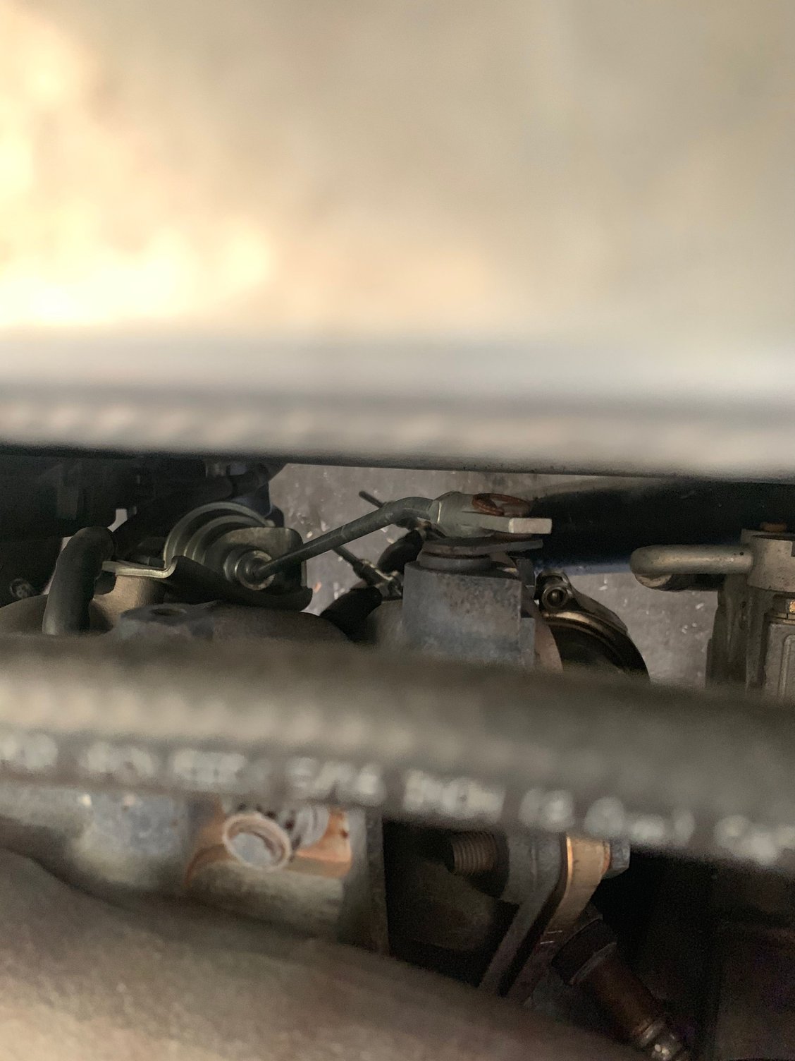

Pictures will help.

Snap a picture right behind radiator. We should be sble to see the wastegate arm.
Got off of work early. I’ll get some pictures up when I get home.
Old Nov 27, 2019 | 08:18 AM
DualEvoGuy's Avatar
Joined: Nov 2019
Posts: 15
From: Texas

Update guys
After getting some parts out of the way and toying with it. It was jammed. Now it freely moves up and down. I can wiggle it by hand. It feels like it can get stuck again easily though. Is there something I should tighten? Isn’t this arm supposed to already have tension on it?
