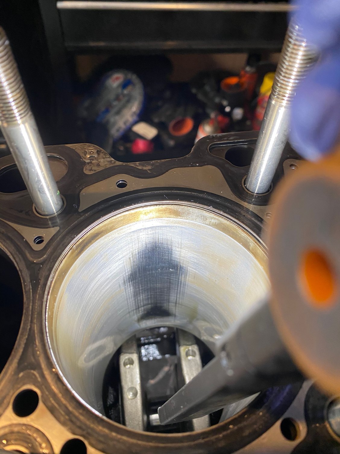

Thanks, waiting on a drop off date for the machine shop and just trying to plan for the worst case.

Walls don't look to bad really. Maybe just another hone depending on how deep those scratches are on the cylinder walls are again I would talk to the machine shop and see what they recommend.
