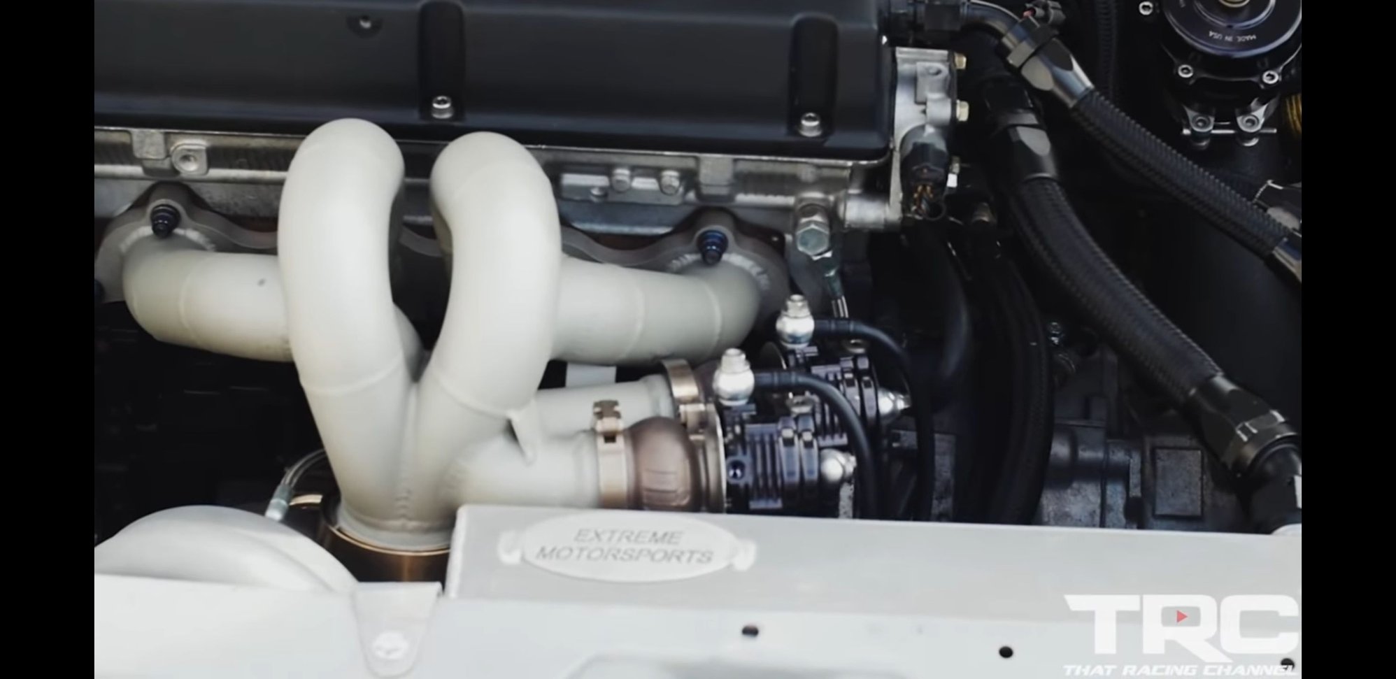

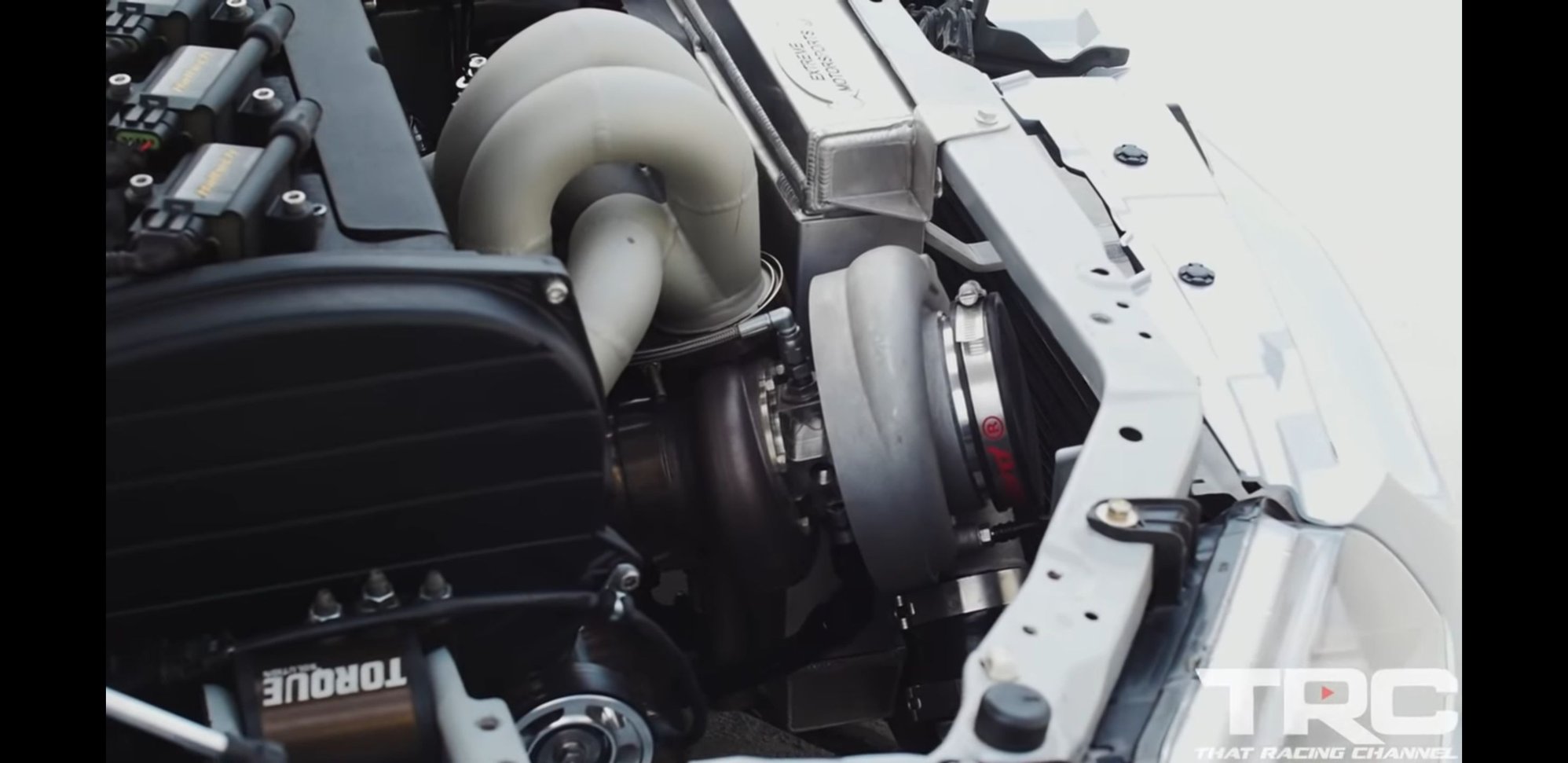

How do you guys feel XR9569s compares to the g35 1200? I think dan's setup is Twin scroll.
Old Jun 30, 2020 | 11:11 PM
2006EvoIXer's Avatar
Joined: Jul 2012
Posts: 3,294
Likes: 197
From: California
I see two 38mm EWG, but it looks like a regular vband turbine housing. Does FP offer vband twin scroll turbine housing?
Old Jul 1, 2020 | 12:09 AM
Shamsiel's Avatar
Veteran: Army
Joined: Apr 2019
Posts: 63
From: Virginia
No they don’t. And it’s because they don’t need one. It spool fast enough as is, and I don’t think a UHF wheel would work in a TS application.
