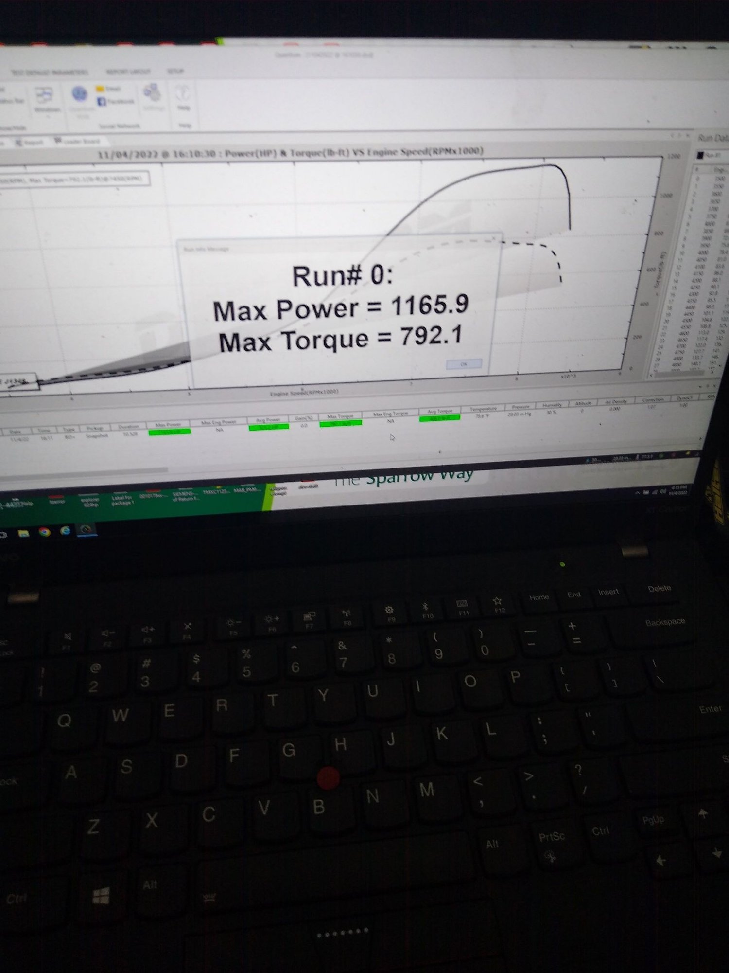

MY turbo is in my sig. It's a forced inductions s372., Basically the same as the 10569 but larger and it flows 115lbs per min and it has a 1.0 a/r hotside. Here's of the picture of the dynograph when it made 1165
This will give you an idea of how this style of turbo reacts.
Great!! Thanks a lot. Assuming it was pull on 3rd gear?
That was in 4th gear, he was working out some issues and made a pull right afterwards. I don't have any third gear pulls on my phone that I saw.
