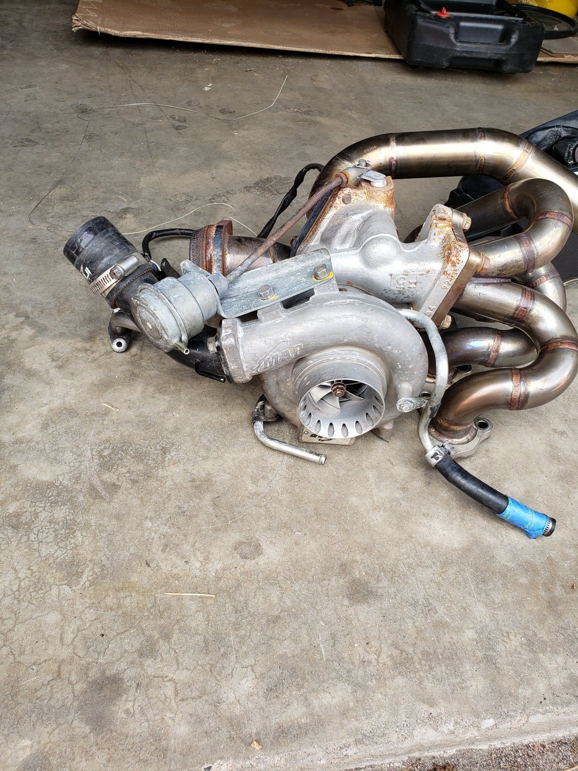

So this is my first build Im doing on my own. Ive done my 3000gt a few times so Im comfortable wrenching but always had help. Im doing a full build and already have most of the parts bought. After the build I will have it tuned by a local shop I trust. Im aiming for 550 on low boost and whatever on high boost. This is what I have already
Engine
Map 2.0 stage 2
GCS springs (done by previous owner)
HKS adjustable timing gears
Induction

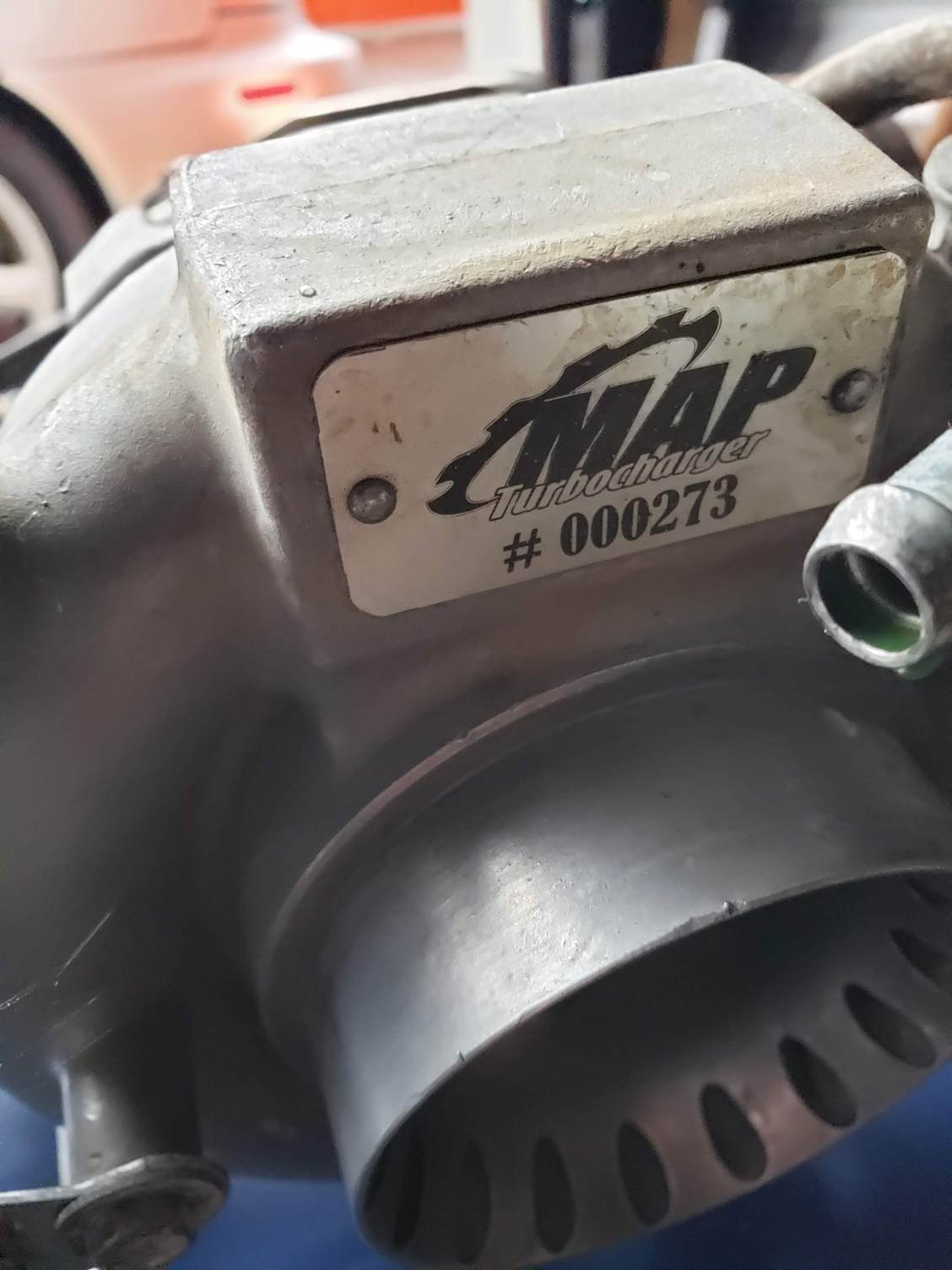

MAP turbo and hot parts (dont know much about it as it was already on the car)
STM UIC
Injen LIC
AMS FMIC
AEM EBC
Tial BOV
Fuel
Buletproof fuel hat
525 Pump
Will be running 8an feed 6an return
FIC 2000 Injectors
JM Fab fuel rail
Drivetrain
Jacks built transmission with carbon fiber syncros
Exedy twin clutch
Other
Full 3 inch exhaust
AEM infinity
New oil pump
New coolant pump
Questions
I have a Kelford 272 Cam in the head now, I also have a HKS 280 cam. Should I use the 272, 280 or get something else
Should I get new balance shafts or can I reuse the old ones (about 60k on them)
Should I pich up a specific wastegate spring strength
Is there anything else I need to look at?

Thats a good start. If the engine isn't together already I would do a 94mm crank. It just makes things better/easier IMO.
What turbo and flange do you have ?
If you plan on revving it past 8500 alot then I would recommend the ER oil pump gear to slow things down. ATI dampner is a great idea .
Balance shafts were engineered for a stock rotating assembly. Since you do not have that any more , they need to be deleted. You are more likely to have problems if you keep them on a built engine.
Have the 12 tooth trigger wheel discussion with your tuner. It will help with crank signal clarity on that ecu. Its a must. You also want to have a strong battery. Something like the Odyssey 1100/1200 that has burst of cranking amps to get the engine to fire off well. Make your life easier since you live in a cold climate .
Flex fuel sensor and a trim switch for different boost levels. Motec makes a 4 pot switch or Aem makes an 11. An example would be base boost on pump, then 25psi on E85 on setting 1, 30 on setting 2, 35 on setting 3 etc.
I would run a 20-22psi wastegate spring so you can boost it on pump gas if its a 9:1 engine. Should be able to make 40psi with a traditional BCS.
I wouldn't pay too much attention to the cams,I'd prefer to add boost/octane over being worried about a few horse power with xyz cams. Now, if its a mivec engine. Then I would go with the proven billet S2's to avoid a potential cam failure.
An intake manifold like the Skunk 2 or magnus will make 20whp+ on most turbo setups.

If that’s a map bolt on turbo , you may want to explore the proven FP path or go to a 5858/6266 turbo kit.
Hla is a good idea.

i think those MAP turbos have a bad track record.
i agree with Abacus suggestion

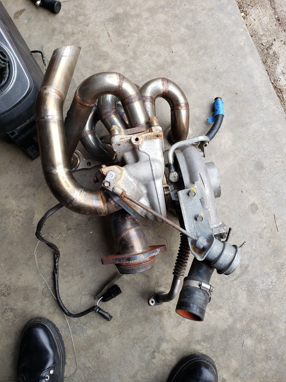

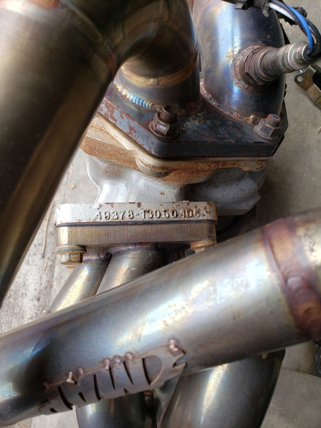

Thanks for all the input. Ill add some more pics of the turbo to give a better idea of what I have. Im willing to look at options but it would have to be bolt in. TBH Im already hitting my budget so I will probably sty with the turbo for now. I may use the winter as the time to build the head all the way but well see
