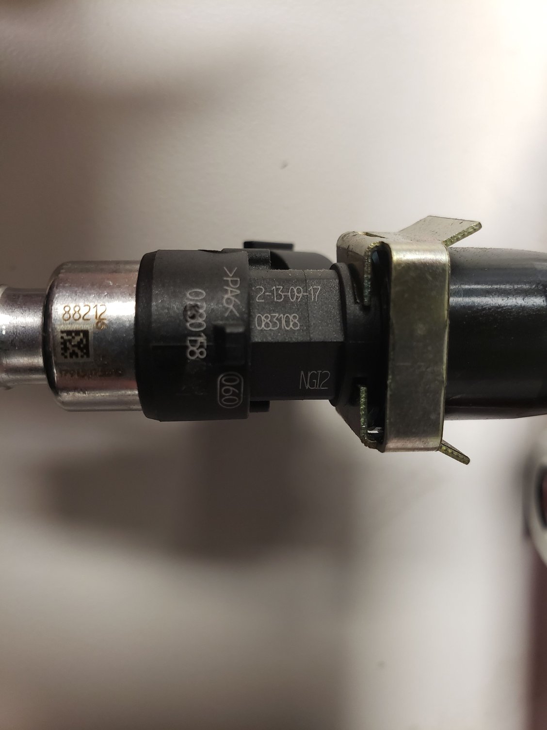

Can somebody identify these injectors?

Came with the car. Thought they were fic 2150's but they dont look like what other manufacturers are selling as fic's.
Thanks

They are bosch high impedence injectors.

Agreed. Any way to identify the size by the numbers on the body? They appear to be decapped too.

The "0280158" is the part number. It looks like the etched off the last thre digits that tell you the size. You'll have to flow tes tthem to confirm what they are for size.
But the hat looks like FID, fuel injector development. They don't do the best matching, you'd be better off with a set of genuine FIC (fuel injector CLINIC) or ID (Injector dynamics).
They're definitely modded. Had them flowed by a local guy. Said the spray pattern wasnt ideal but they filled the beakers to within 1%.

Spray pattern is important. I'd get real injectors..
