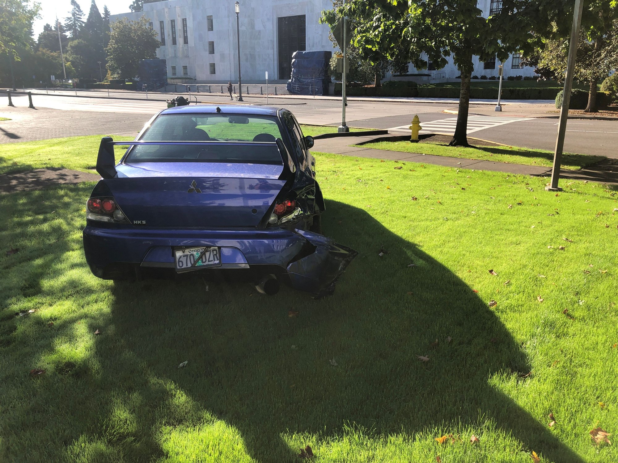

Long story short. My Evo 9 was hit in the passenger quarter panel and Mitsubishi has discontinued making the quarter panel and Lancershop is out of stock it sounds like insurance is going to total the car. I’m going to start to put the car back to stock but I sold my stock Evo 9 turbo but found a Evo 8 local to me. Wondering if that will fit?

How bad is the quarter? Is it impossible to fix?
Old Nov 3, 2020 | 03:19 AM
scornutt's Avatar
Joined: Jul 2009
Posts: 4
From: salem oregon
I think it’s non repairable but I don’t know much about auto body repair

That looks like it could be pulled and repaired. There are some pretty amazing body shops these days..
