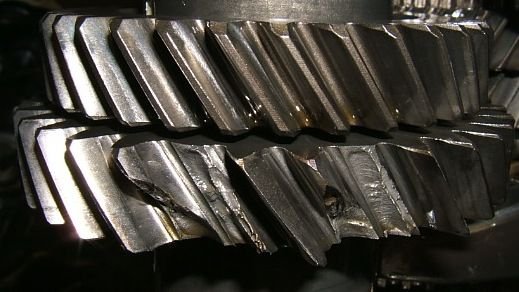

Originally Posted by razorlab
It's the 4th gear track use that kills the 6 speed. The local track I ran when I had my Evo 8 MR was a lot of 4th gear, which did this:
Ouch!

From: Tucson
I have an Albin 6 speed now, with a trans cooler. Haven’t tested the whole system enough as I’m waiting on a tune. Else just make sure you are good with changing trans fluid pre/post track days and allowing a thorough cool down period for the trans, that helped killed my last 6 speed on the track

just make one yourself.. it is just a couple of fittings, a pump and some hose.. Switch it on manually when on track.

I love the speed, shift smooth, I have thought about it a lot also, at the end I decided to go 5 speeds route, got one from TRE after talking to Jon, I opted for the mix and match gears, 1st 2nd and 5th from the evo9 and 3rd and 4th from the Evo 8. With 4.11 final drive 5th gears is like the 6th gears now.
