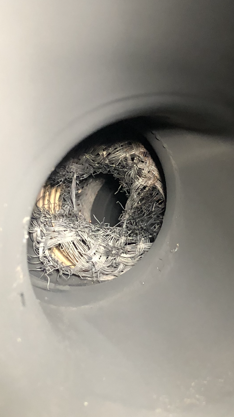

Originally Posted by TimC909
Don't suppose you monitor back pressure or turbo speed do you? Curious to see results as i'll be on 8374 T4 IWG soon enough.
Yes I did, but it was years ago... I think turbospeed was about 120k. Backpressure was more than 3 bar (maxxed out sensor) but I think the culprit was that my exhaust flex had collapsed inside and I havent measured backpressure after I replaced it. Think boost was 2.5 bar falling to 2.3 bar towards redline.
