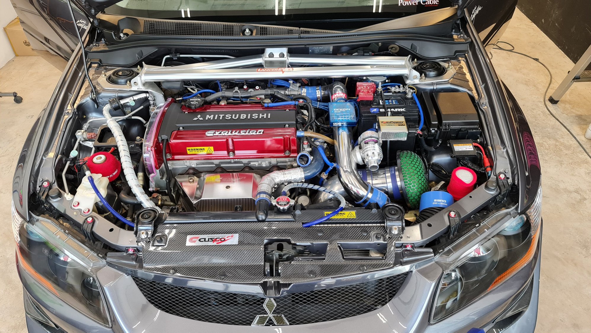

Finally picked up a neglected 2005 EVO 8 MR with 11,430kms in 18 September. Since then I've been working on paint restoration, engine maintenance / upgrading and tidying. Spent the entire weekend ridding of all the stickers not the vehicle and removing the BRIDE seats installed to revert back to stock MR Recaro Seats.
My dream JDM... EVO 8
Garage Queen no doubt!
Probably the cleanest looking engine bay until, she becomes my daily driver. Fully tuned and built by Ohura-san of HKS Japan.
