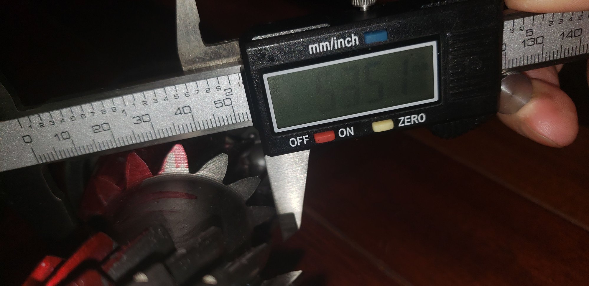

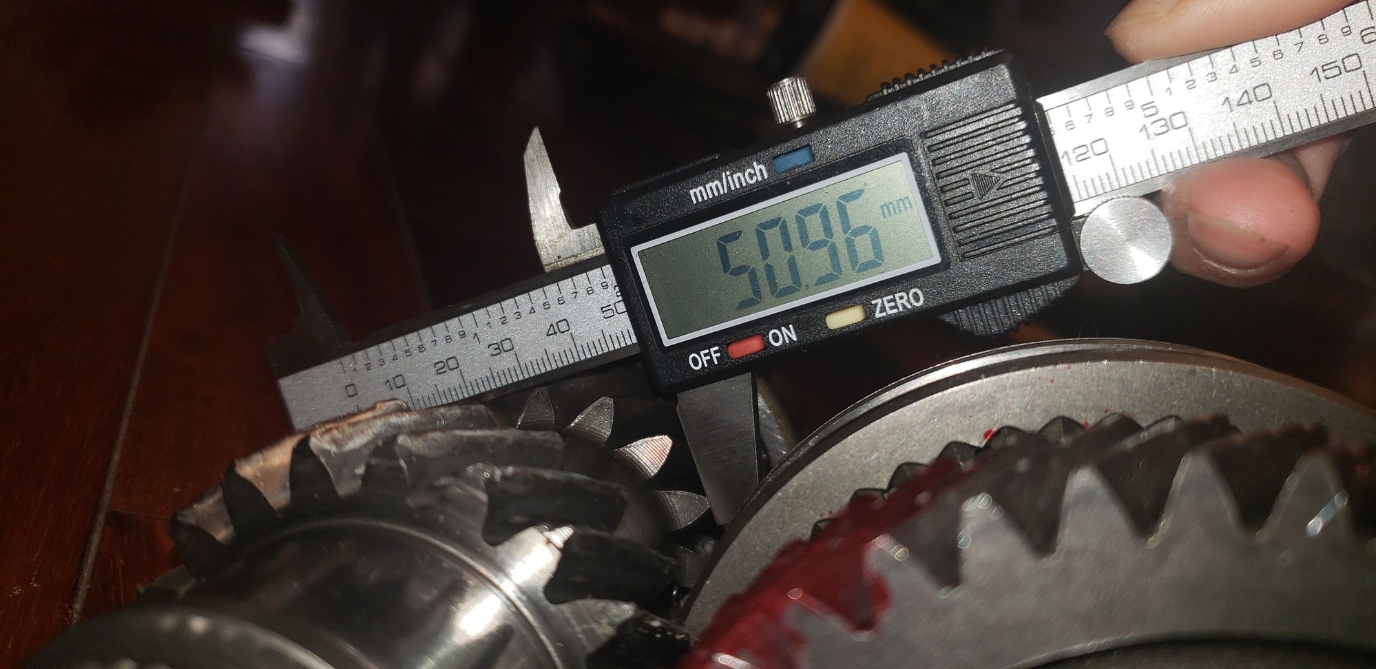

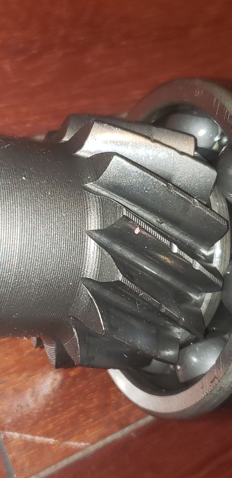

I just took a closer look. Is this the difference?
Evo 8:
Evo 9:
The evo 8 input shaft 1st gear is cut deeper into shaft.
can anyone confirm this?
Old Mar 6, 2021 | 02:12 PM
2006EvoIXer's Avatar
Joined: Jul 2012
Posts: 3,294
Likes: 197
From: California
Also, evo 9 has the larger diameter (as expected since evo 9 has the taller 1st gear).

Can you show us the difference between the 4th gear of the evo 9 and the thicker 8 one?
The best way to tell is by counting the output gear teeth and divide by input gear teeth. Then look up on Jack's Transmission gear info table. Here is evo 8 4th gear pics (33÷32=1.031 and cross reference with https://www.jackstransmissions.com/b...on-gear-ratios ):
Old Mar 7, 2021 | 04:10 PM
Joined: Jul 2012
Posts: 3,294
Likes: 197
From: California
I don't have any evo 9 4th gears available to show. All have been converted to evo 8. Sorry.
