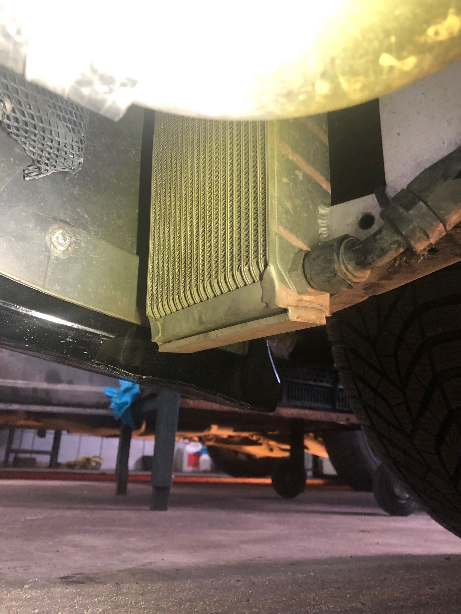

  • I'm not sure if oil cooler is stock, I couldn't find any serial number. I took pictures though, maybe someone can tell if its stock?

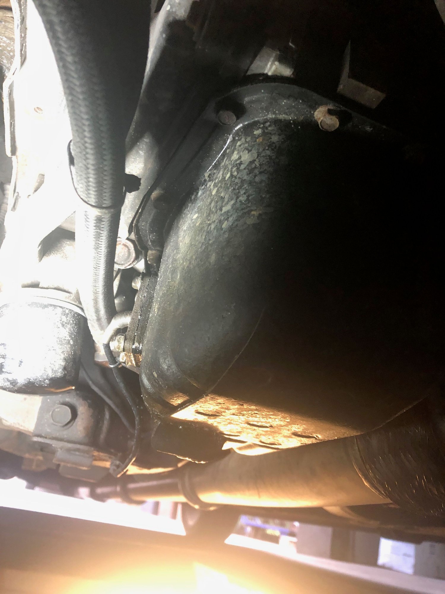

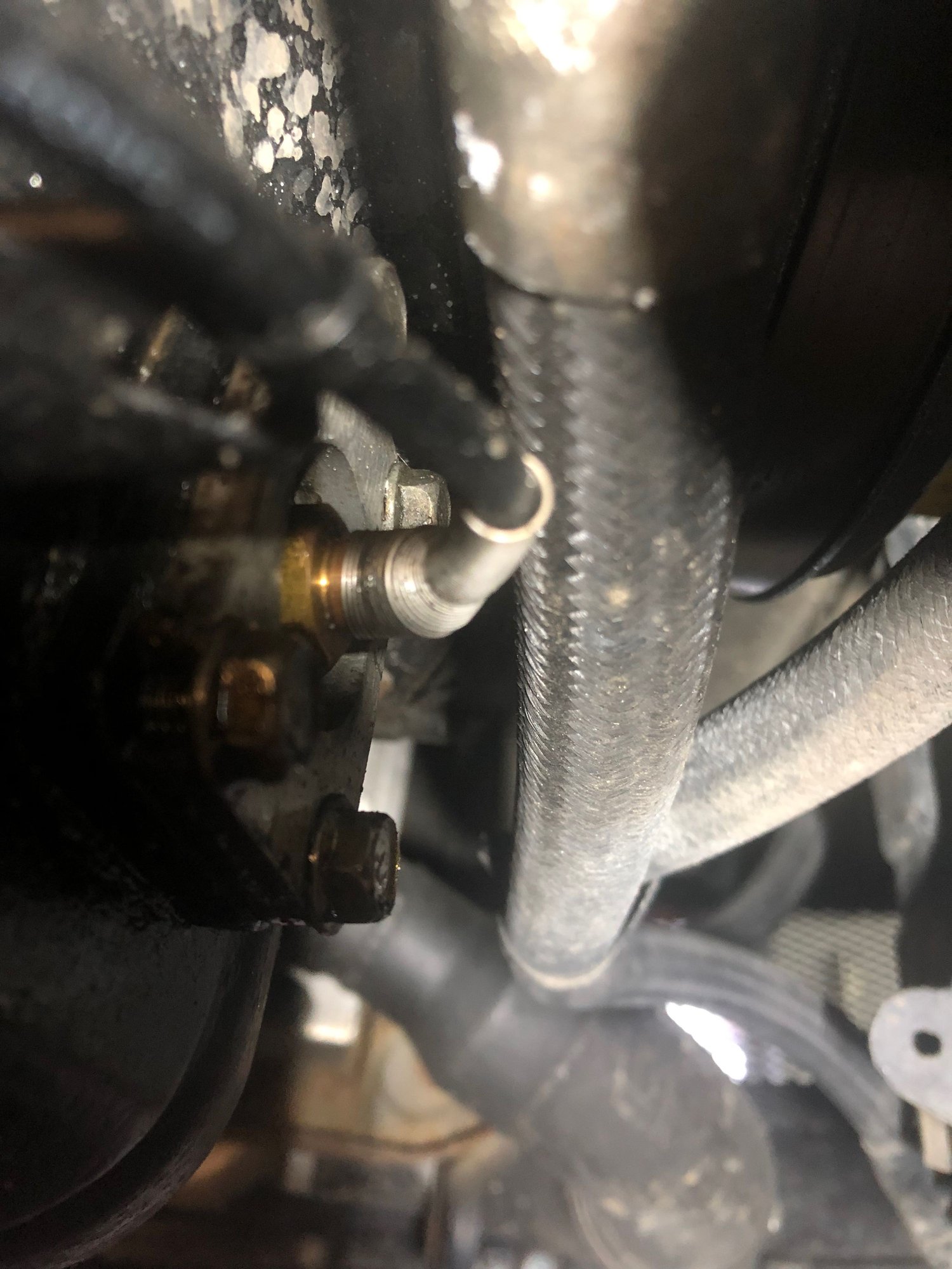

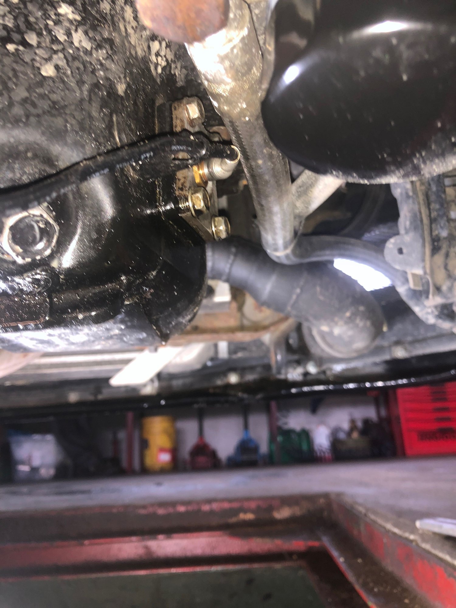

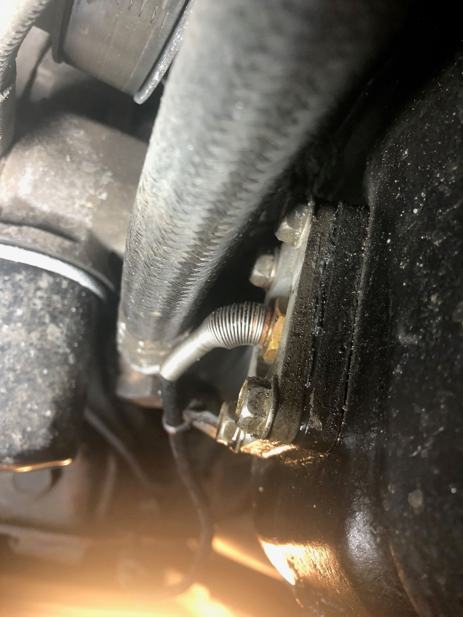

Also I have Innovate 3913 (3852) MTX-D oil temp/pressure gauge but I'm not sure if the sensor should be mounted on the side of oil pan? It has a little oil leak.

That's not the stock oil cooler but that does not look "too efficient" at cooling. Stock one look like this https://www.ebay.com/itm/14388000778...IAAOSwI~df0PLE
Someone here told me they cover their oil coolers during winter. Try that, put some cardboard in front of the cooler and test

FYI, I have an RS it came with an Oil Drain plug temp sender. That is completely useless in the winter. Yours is mounted better but still may not read correctly in the winter. Glow shift makes a filter adapter that put the sensor in the flow path of the oil. I will buy one at some point and tap it to fit the oil plug sensor. What you want is temp of the flowing oil not a dead spot on the outside of the pan.

I put my Oil temp sensor in the oil filter housing. It reads the temp before it gets to the oil cooler. I ran in in the oil pan before and had the same results you are having.

The oil will be hotter at the oil filter housing then the pan. I saw a 20* decrease when I moved the sensor from the housing to the pan (where it belongs)
