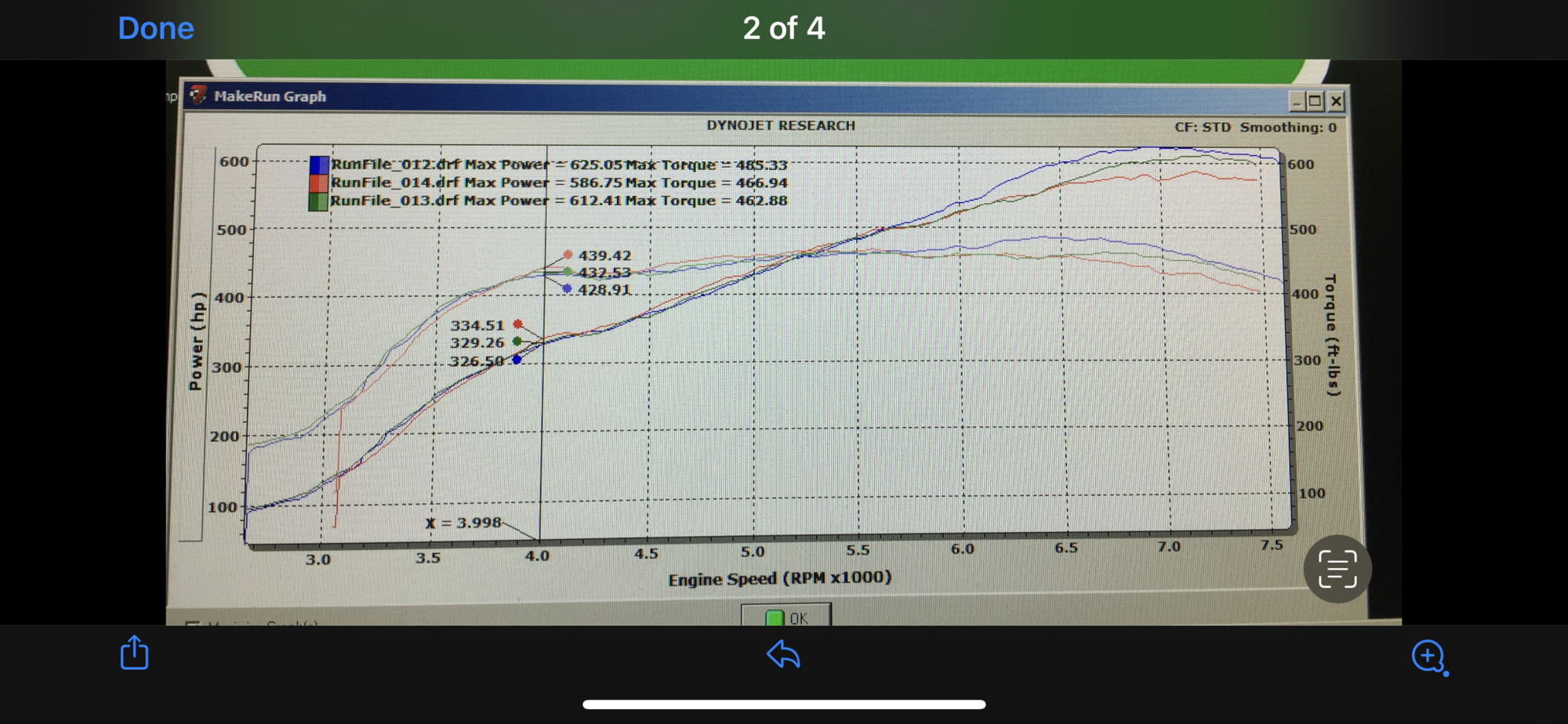

My non-mivec worn out (~135psi compression test) 113k mile stock block engine makes 20psi in 3rd at ~3950rpm on 93 oct (VD dynojet). Surprised you're not seeing better spool. Maybe mine spends more time chugging along to get there...
it doesn't make 300wtq until 4100rpm.
Even my stock engine would make over 400wtq at 3800 on the dyno. This is my 2.2 mivec on E85. 28-30psi 3rd gear

G25-660 has small turbine, presents backpressure, similar to FP Red in many ways. So FP Red makes sense.
Check this dyno, post number 257 for Built 2.0L, stock cam Evo9, G25-660 .83 A/R Vband setup.
https://www.evolutionm.net/forums/ev...turbos-18.html
