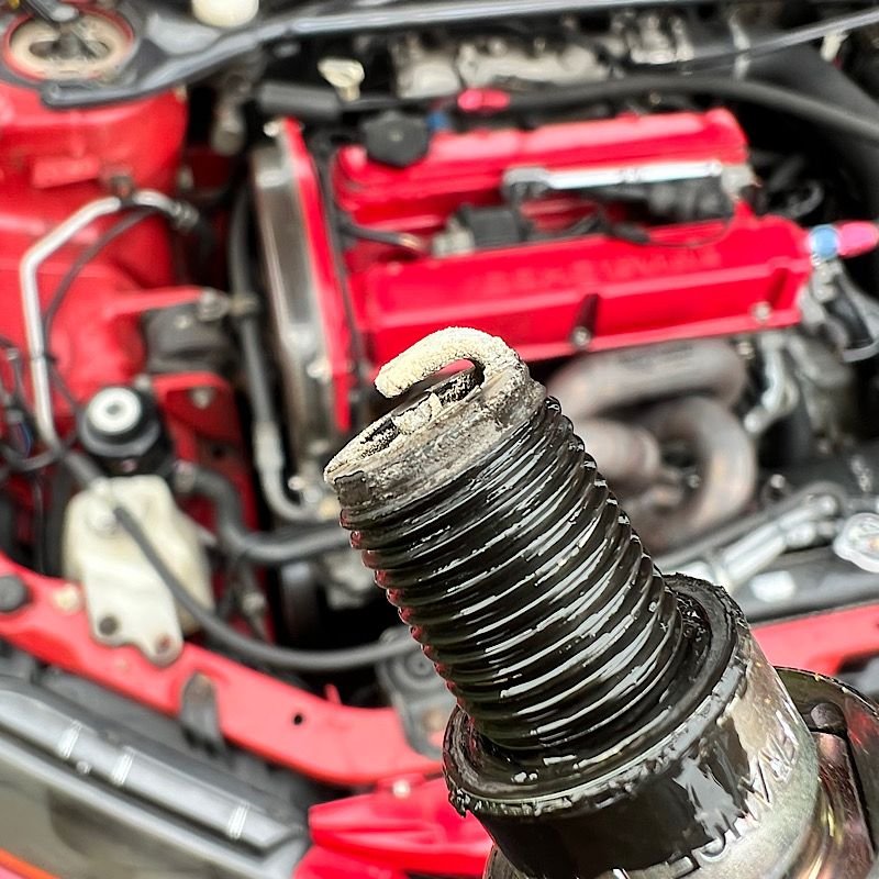

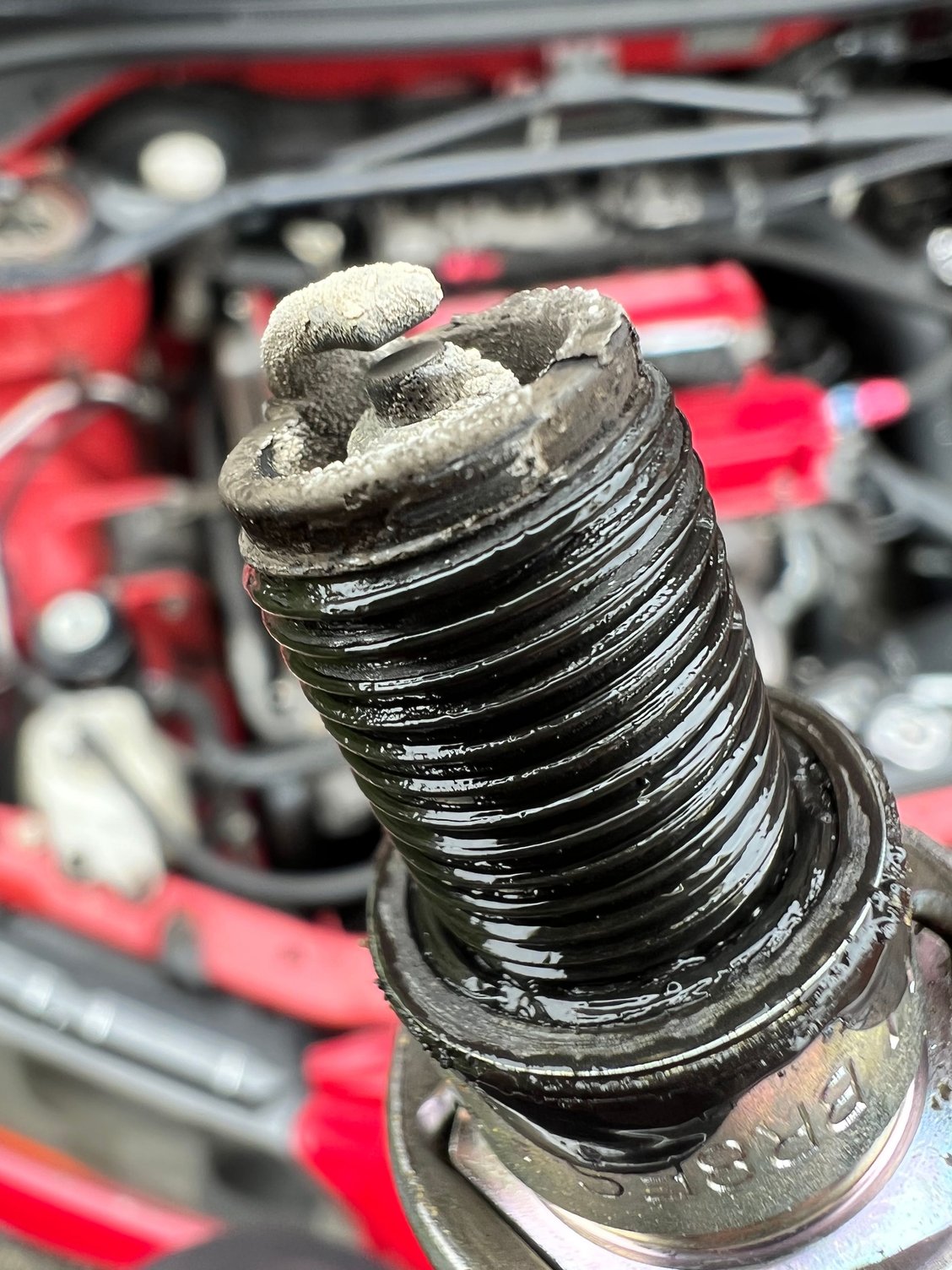

I’ve removed all the spark plugs and noticed 2 plugs looked like the photo attached. Any advice on what’s causing this? I also noticed the 2 cylinders the dirty plugs came from, have a bit of fresh oil on top of the cylinder, I’m assuming it’s the spark plugs seals in the rocker as it’s directly below the plugs.

Hey Nick / Welcome @sasha1712
So these attached pics are not from your engine correct? The above pics show the threads buried in oil residue which is likely that caked on mess on the electrode
Your plug threads are that contaminated w/oil as well?
Cheers, Joe

Hi joe. Thanks for the reply. The pics are of my actual plugs.

Oh i see.
Can certainly understand the electrode condition as oil is obviously leaking down the plug & into the combustion chamber, coking that oil to the plug

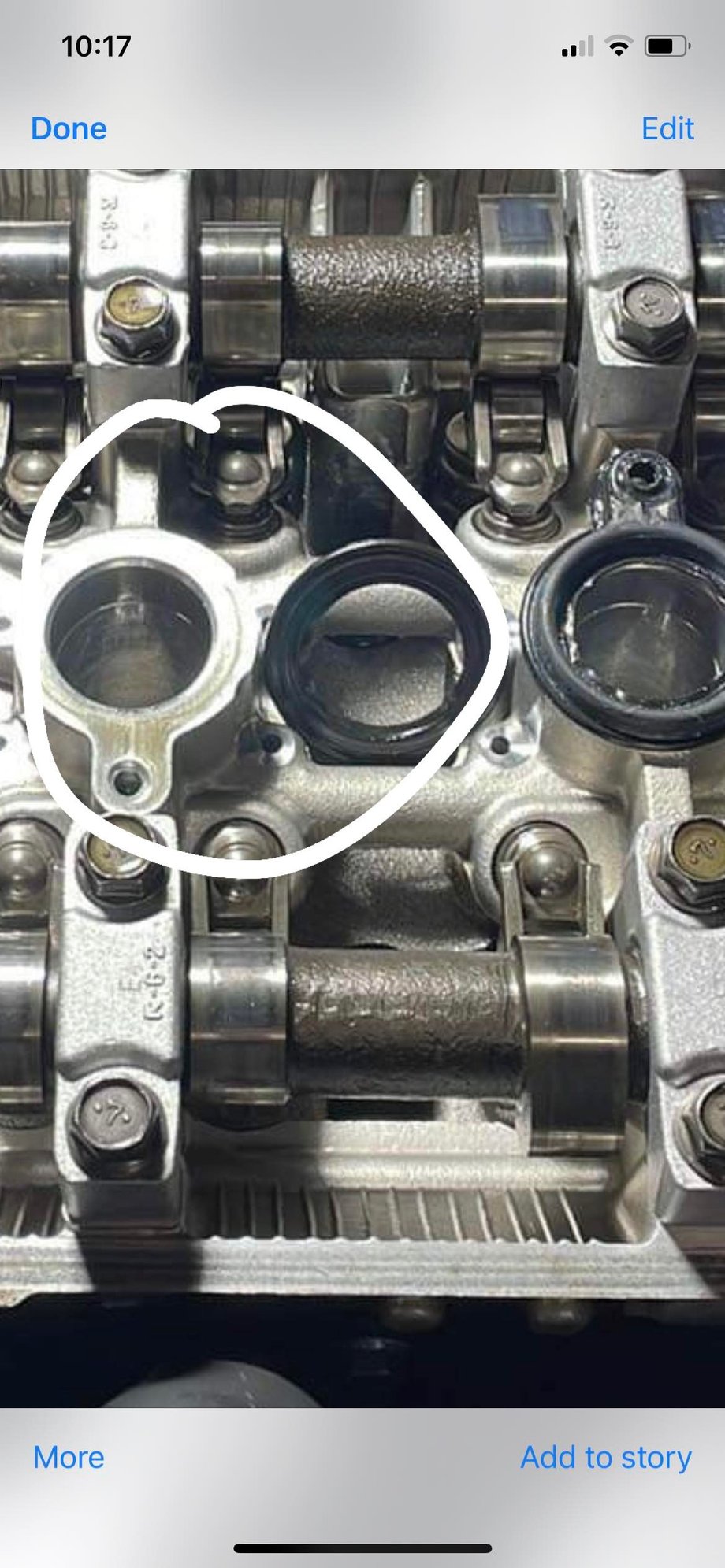

So by looking at the picture. Have you removed the valve cover lately? The round gaskets that sit on top of the head to prevent oil getting into the plug area are probably not seated or worn out. Will that cause you plugs to look like that? No, I don’t think so. But the first thing I’d do is pick up another set of plugs. Then after the car is running pull the coils and look down the plug hole to see if there is oil. If so you may have an issue like below picture.

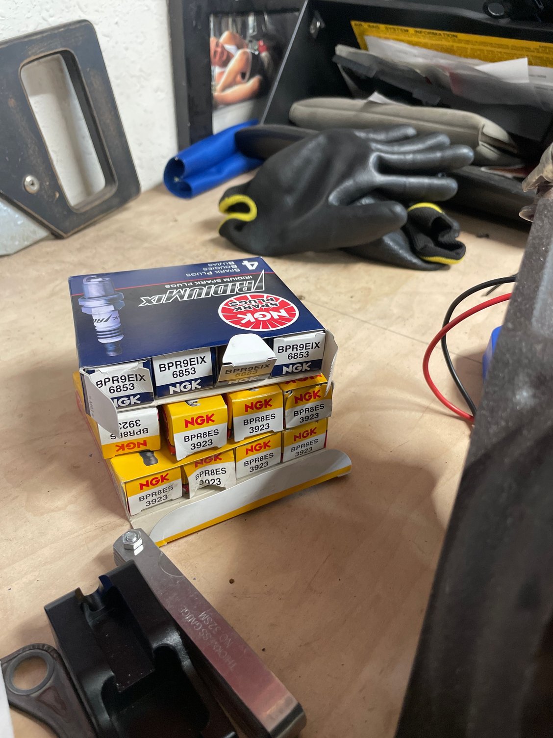

thanks for the advice. I’m going to order a rocker cover and spark plug gaskets and a set of plugs.
The plugs I’ve removed are ngk BR8ES. I’ve been reading up and wondering if the ngk BR8EIX Are a good choice for my setup? Running around 600bhp.
many thanks
better plugs. Their the iridium version, disregard the “9” for mine
