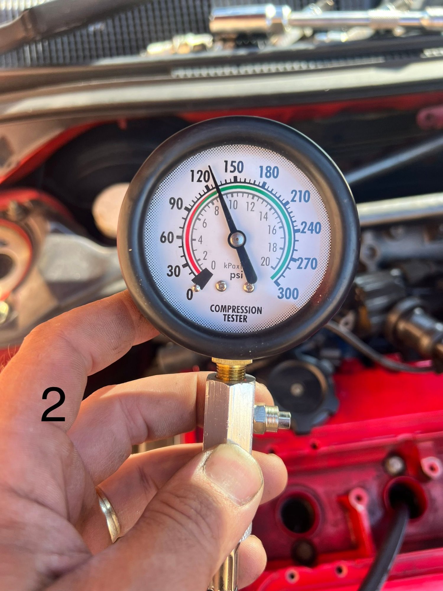

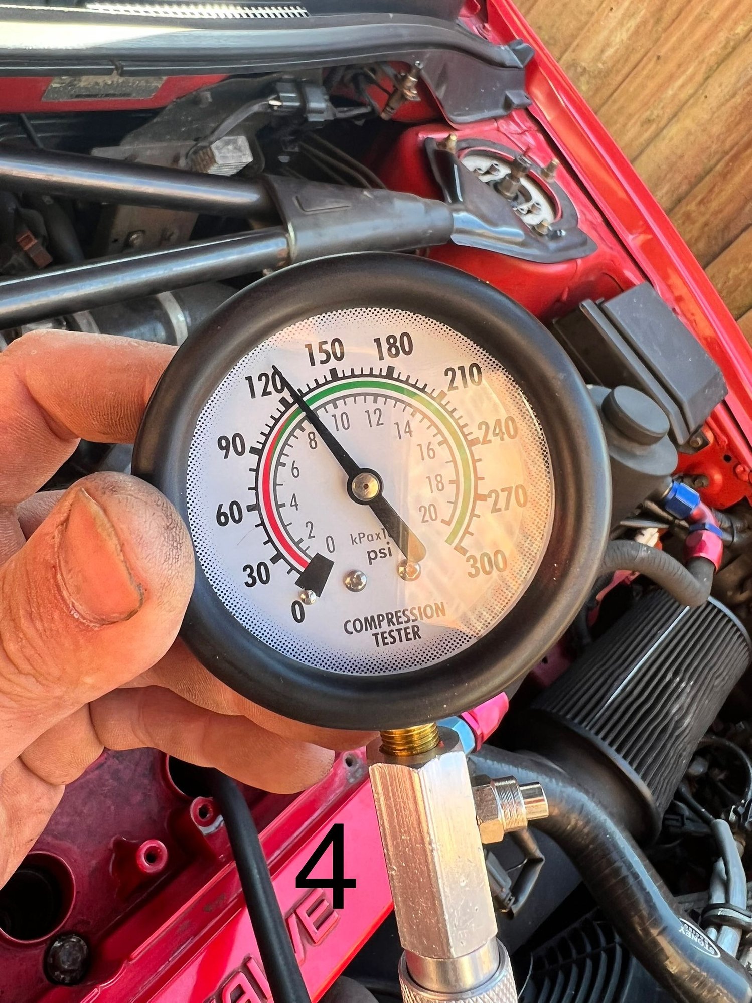

Hi
just done a compression test. Not sure what the figures should be?
cheers
Old Jul 26, 2022 | 11:23 AM
The EvO9 manual notes the following in PSI (145 max to min 92): Compression pressure (250 r/min) kPa (psi) /1,000 (145) / Minimum 637 (92)
