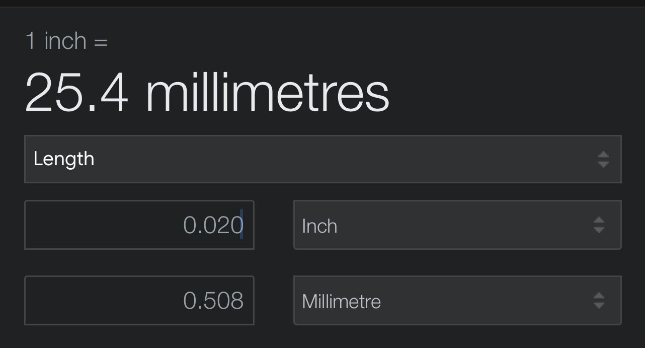

No. .200mm is .008". Sparkplug gap is .020"
Compression is fine for cold engine.
so it should be 0.020” equals 0.50mm?
