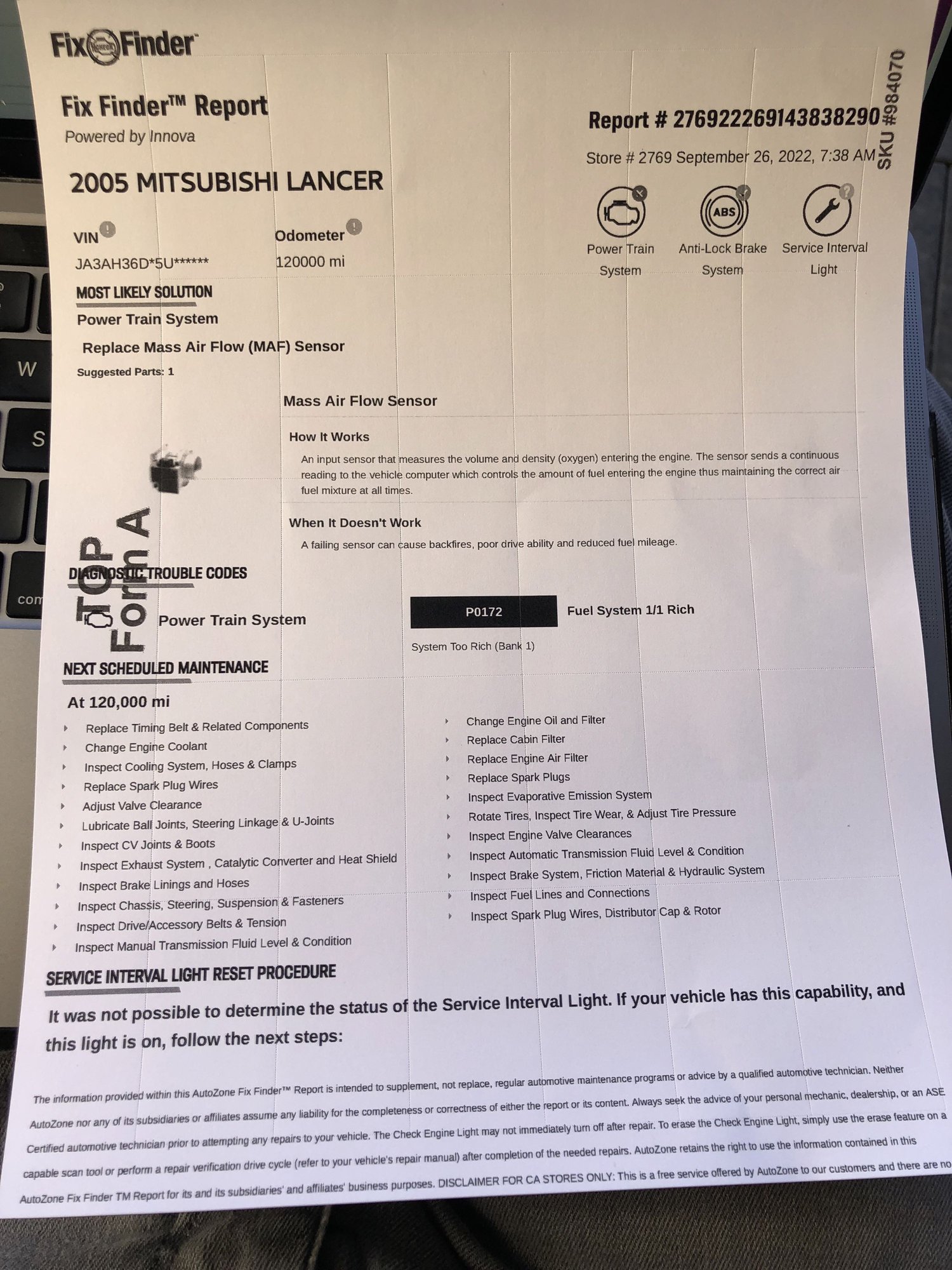

system running to rich
its telling to change the maf sensor I opened it up and it looks brand new and I also cleaned the hello out of my air filter any any help please thanks guys.

Do a boost leak test. You could just be losing metered air instead of a bad sensor.
