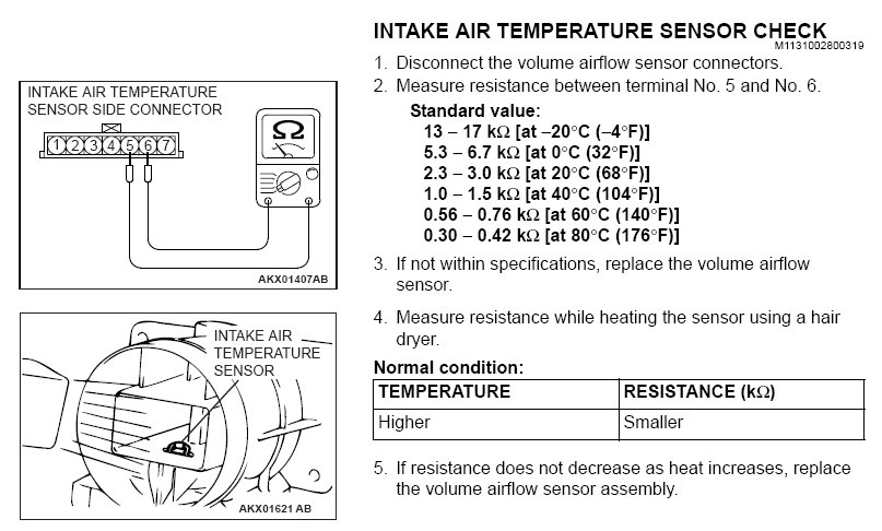

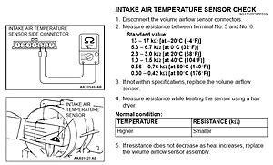

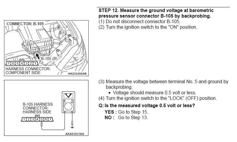

Some images for thought
Sounds like the IAT sensor is busted and the barometer may be diconnected.
