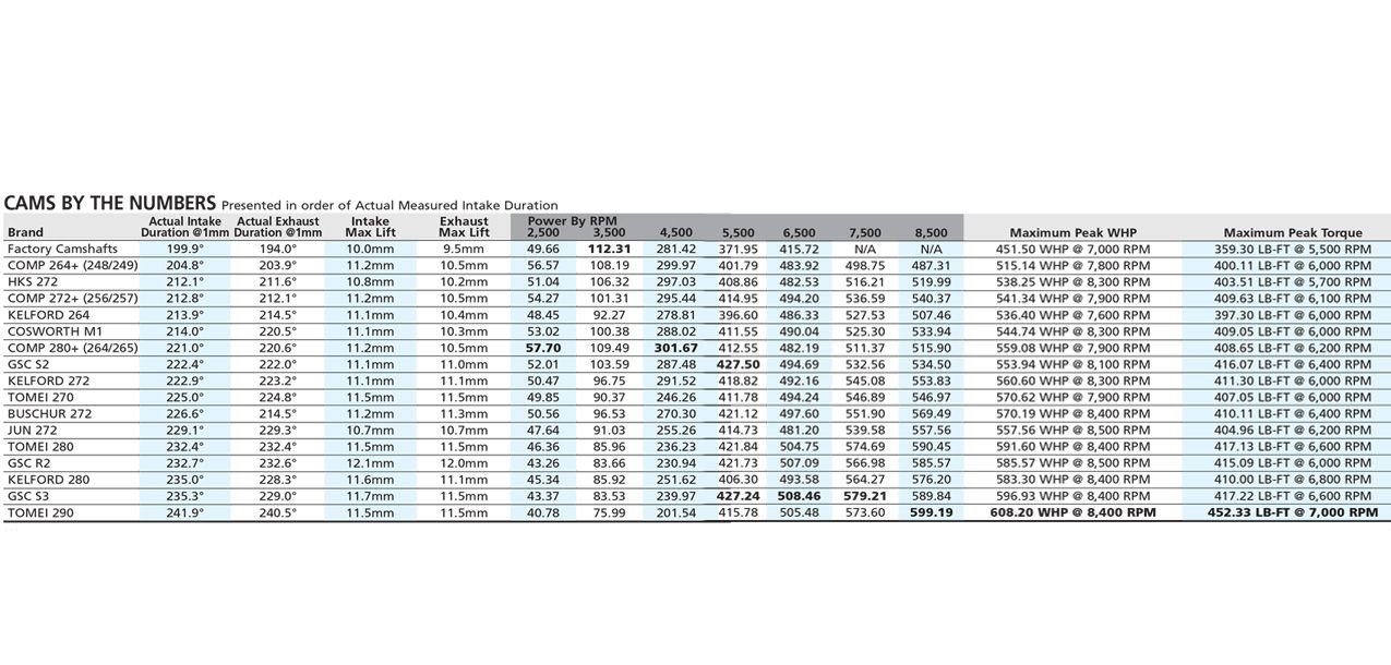

GSC S2 or S3 cams or Kelford 280 or 288's. Depending on power goals. Bigger cams move the power band more to the right and will run worse at low speeds. Turbo choice also plays a role. If its a stock frame turbo an S2 should work better then an S3 because RPM's will be kept below 8000/8500. Correct springs to go with cam choice.

https://dsportmag.com/the-tech/showc...final-results/

I kinda find this way out of date although it is good info. They have none of the newer Kelfords on there amongst some other cams as well. But the rest of what you said I 100% agree with.
