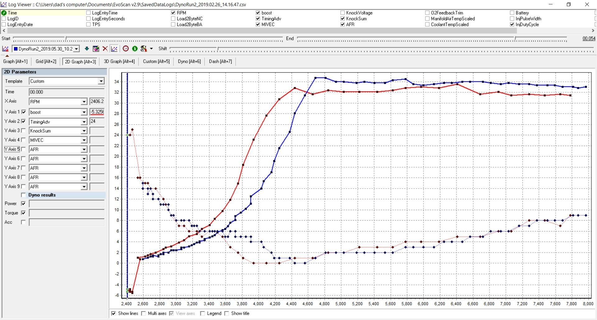

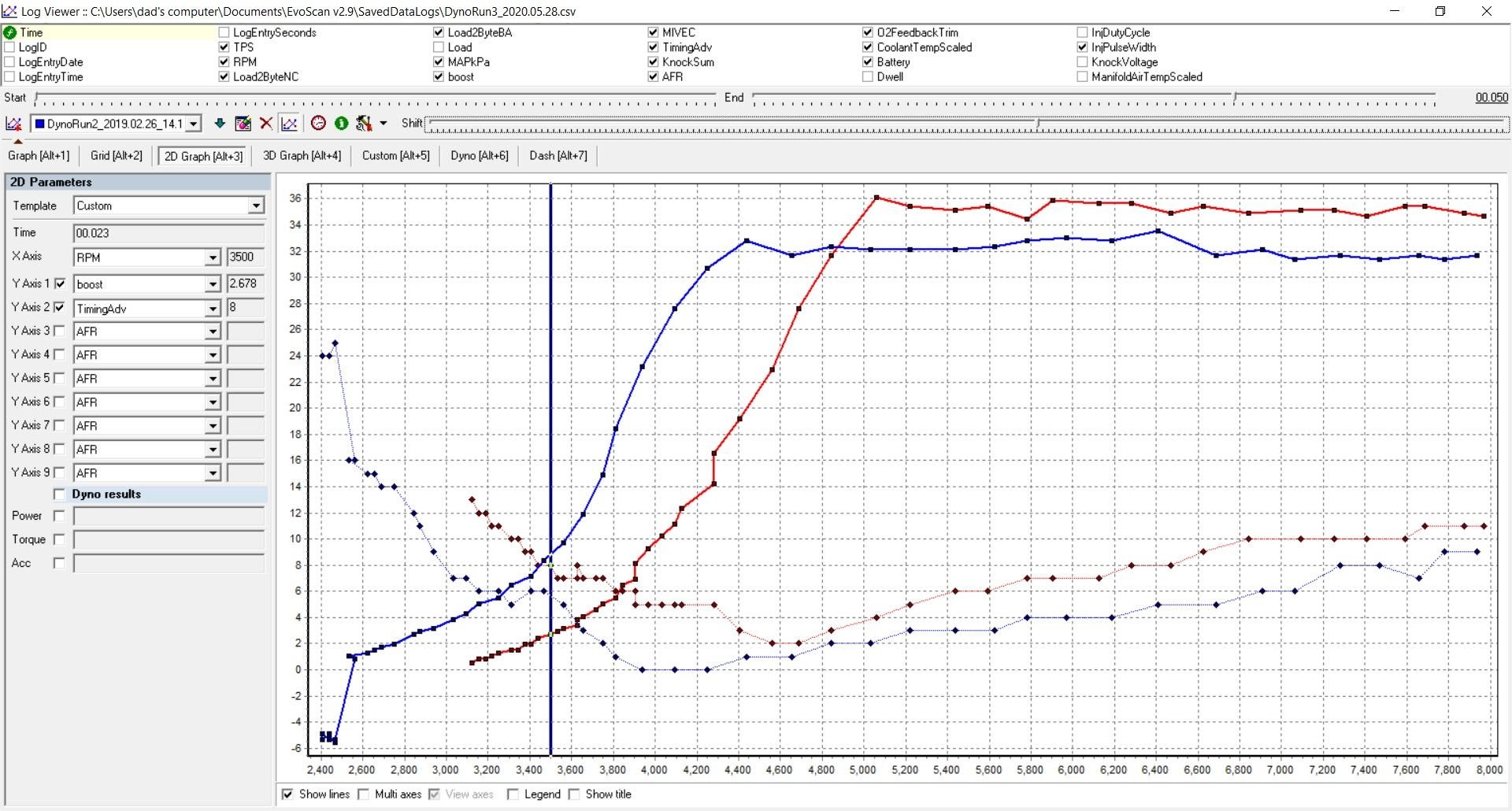

There is no magic involved, it is simply that running the larger turbine wheels with a high flowing a/r and exhaust allows you to run more boost and more timing (intercooler also important). If you choke the turbine side it will absolutely be more knock prone and boost limited. Debated doing a 72mm turbine, but I like the response of the 68 turbine and it makes plenty of power so gonna stick with the new SX-R 6468 with larger a/r for my next turbo swap and AGP thinks I can easily get 40whp from that change.
62 sxe flows 76lbs
64 sxr flows 95lbs
66 sxe flows 87lbs
Looking back at my 35r I was actually running 32-33psi (not 35psi) as that is all it would take before starting to knock. Simply going to the S362 (6268 & 6668) allowed for more boost and more timing. Below is the dynojet log of the 6668 vs 35r and the 6268 vs 6668 dynojet results.
Street log of 35r vs 6268...
Dynojet numbers of 35r vs 6268 as well as the dynojet logs

It just amazing that it lived well . Retarded timing can cause high EGT. But, you put the car thru its paces and it lived.
In my world we tuned 3.0-3.4 2JZ's with a PTE 62/66 or 64/66 and stopped at 650-700whp on pump gas. Thats a much larger engine with the same cylinder head tech from the 90's. That was a send it down the road tune that would live awhile.

Not sure about the retarded timing comment as this is typical pump gas timing for a IX from what I've seen although some have commented the peak torque timing is a bit higher than expected. I have not experienced this type of high boost capability on any of my other 3 turbo setups and very seldom see knock. My old L28 powered 240z with twin 16g's was running about 19-20psi max on 93 pump. My RB26 powered 260Z runs about 19psi on 93 pump, tuned by the previous owner, so I have not personally pushed more than that since I have been focused on making personal changes to the vehicle. Purchased an EMU Black for the 260Z to replace the old Electromotive Tech GT, so I'll see how much boost it can push on 93 pump safely, but not thinking more than low 20's. My R35 with a pair of GTX3071r's runs about 23psi max on pump (750whp) although I typically run around at 19psi daily driving due to knock inconsistencies. Below is my dyno results and dyno log for the GTR and the car trapped 141.6 at ZMax. Can't really explain why it is so much different than my other turbo setups, in terms of boost capabilities, but it is what it is.
