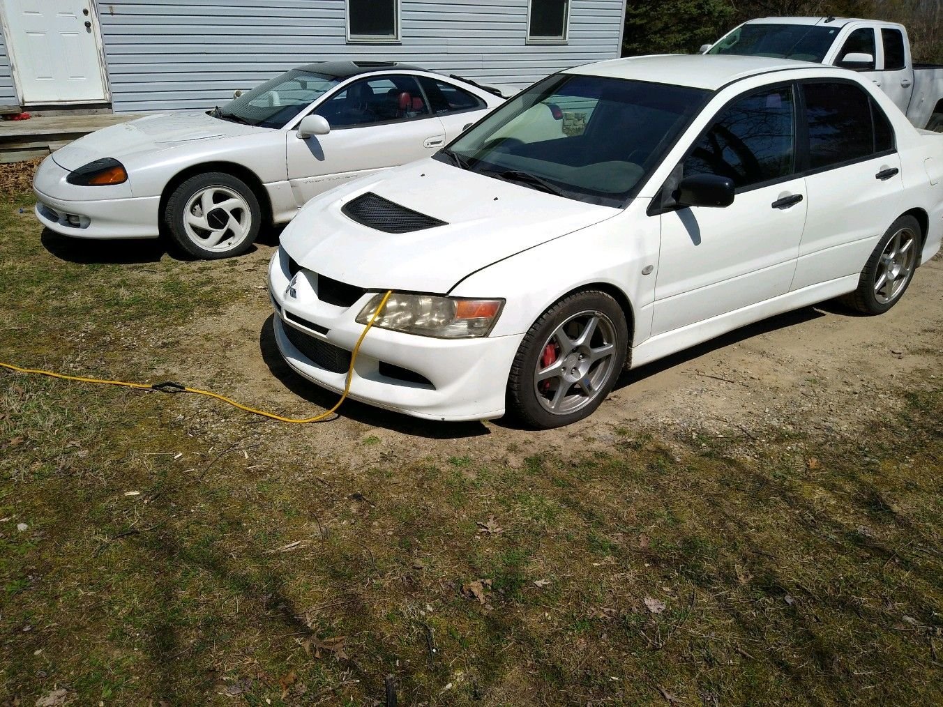

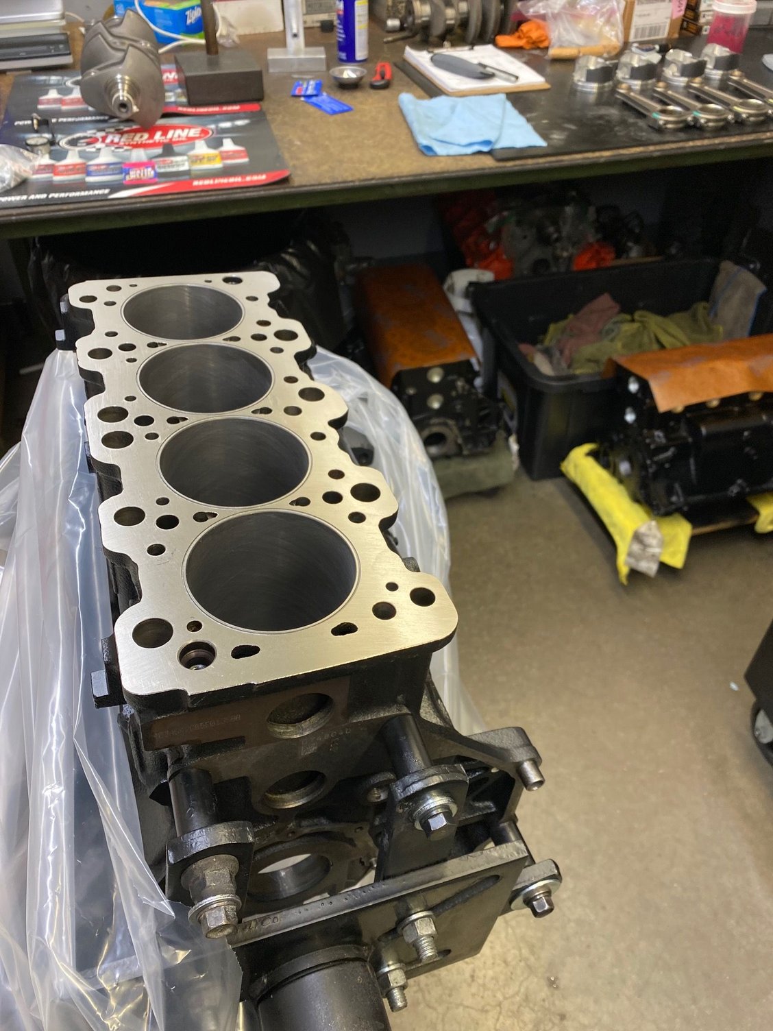

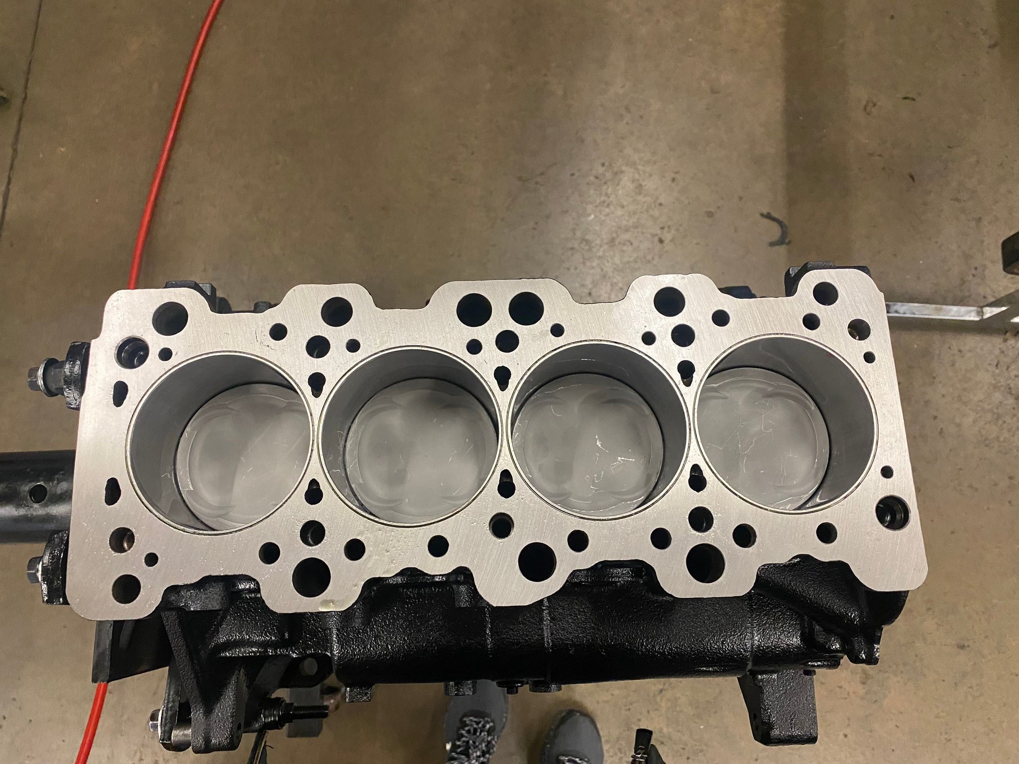

Ok so this is my official build thread. Lets start with the car.
Bone stock 05 evo VIII rs with 18000 original miles
First build consisted of this stuff
Engine:
Standard rod 2.4
Manley turbo tuff rods
Weisco Hd 12.5:1 pistons Swain tech coated
Oem mitsu crank
rebuilt oil pump gears that are polished
Swain tech coated bearings
Cosworth hg
Torque solutions motor mounts
Head:
Force Engineering Nasty head port and polish
1mm over Ferrea competition intake valves standard size exhaust valves
Bronze magnesium valve guides
Kelford 288 hl cams from GSC S2
Aem true time cam gears
Performance Springs valve springs with Ferrea retainers
GSC Zero tick lifters
Sparttech non cdi cop
Turbo:
Map Ef4 that will be ported and polished up and clipped by Force Engineering
Map o2 housing with dump tube
Zeitronix Wideband 02 sensor
Map ported exhaust manifold
Intake:
Map rev3 Intake mani
Milspec 65mm throttle body
Bushur ic pipes
Ams Fmic
Fuel:
Fic 2150s
Magnus fuel rail
Redone double pumper controlled by the Haltech
Dual Walbro 2550s -8 Y into -10 to fuel rail
Magnus Afpr
Magnus in line fuel filter
Zeitronix eca flex fuel sensor
Engine Management
Haltech Elite 1500
Grimspeed 3 port ebc
This engine lasted about 5400 miles or so before I decided to go crazy. I got all the new parts for the new turbo build with this same motor and decided to go Ign-1a coils and totally destroyed the motor, turbo and as you all saw everything else. So with that said here is how the car sits today.
Engine
Slowmotion Motorsports 2.2
2.4 block with 97mm bore and o ringed
Custom stock modified head gasket

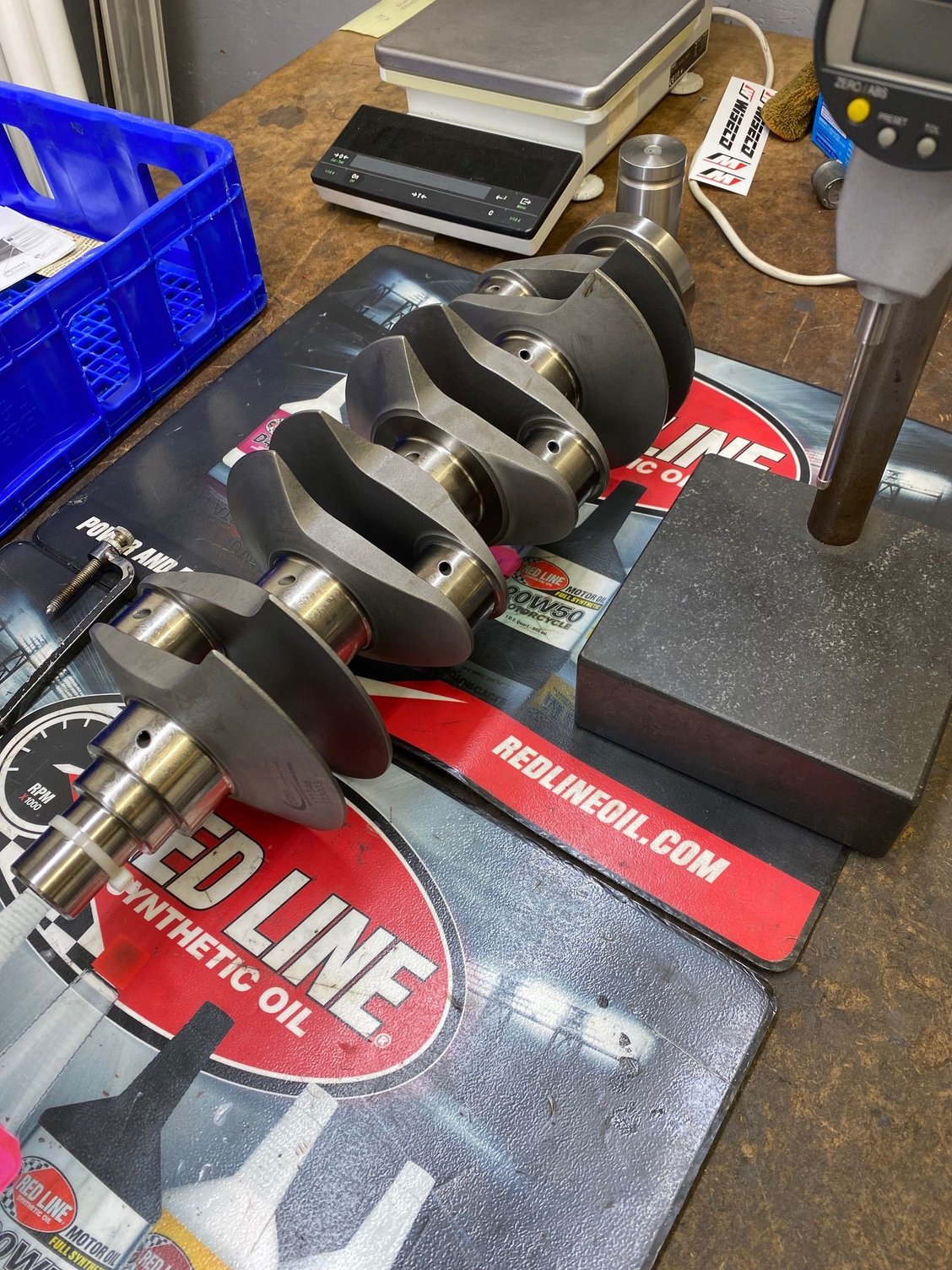

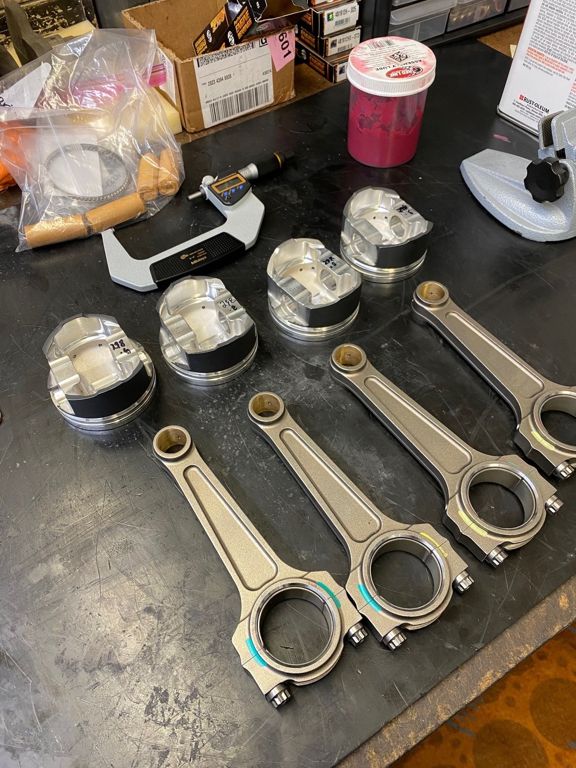

Manly turbo tuff 162mm rods
Manly Platinum Series pistons with skirts and tops coated by line2line coatings
Callies 94mm crank

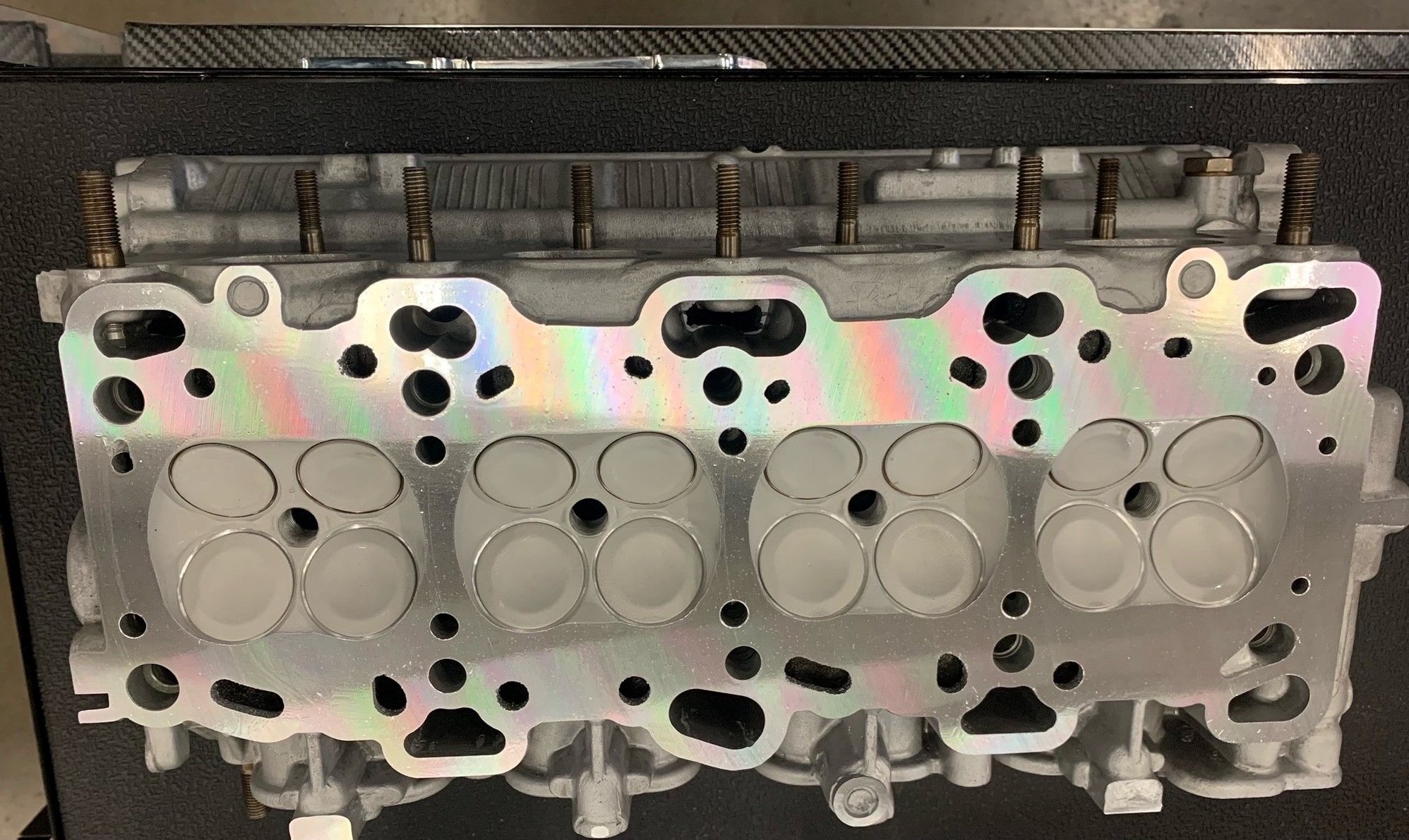

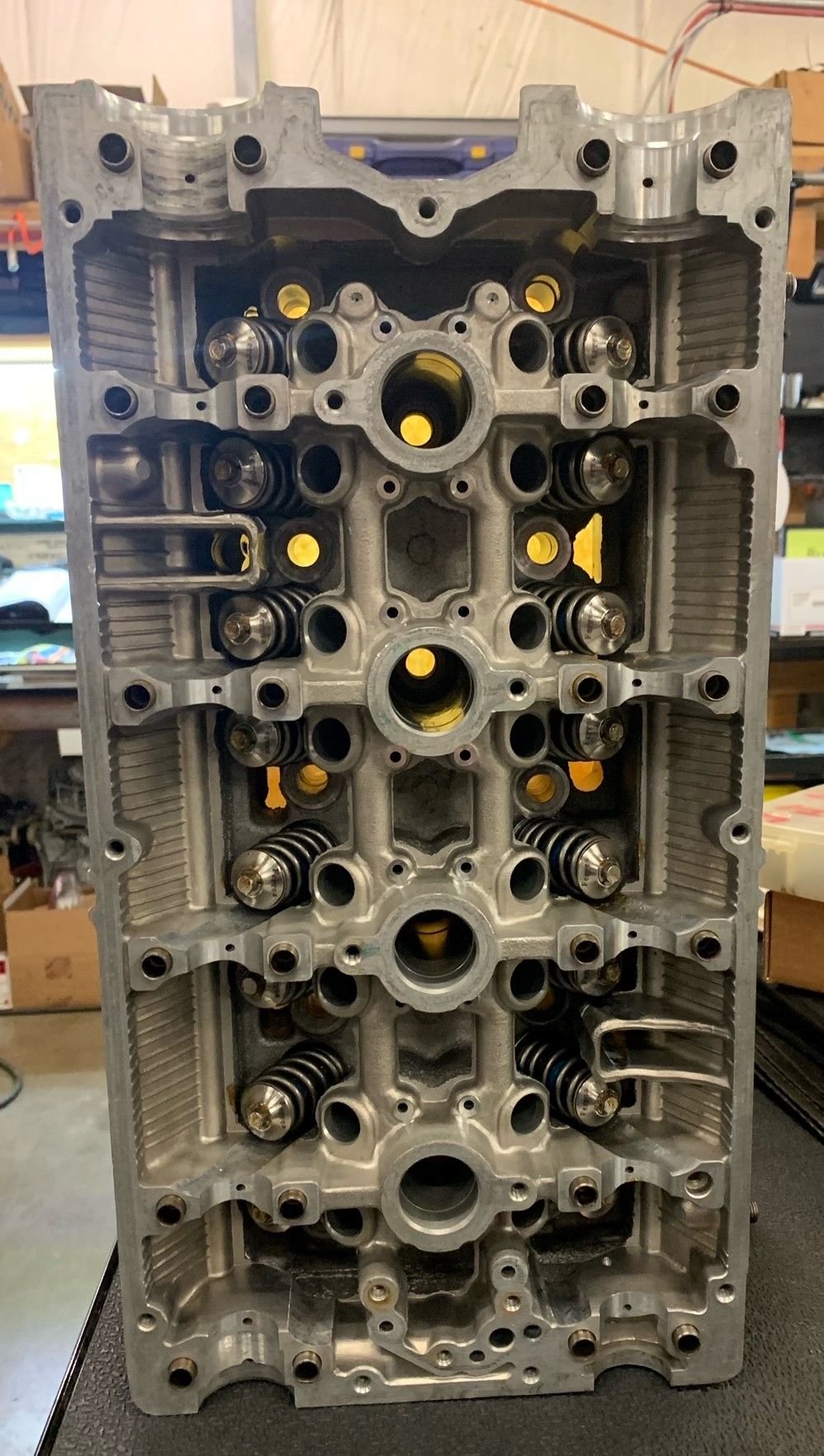

Head
1mm over Ferrea competition intake valves standard size exhaust valves. Valves bottoms and bowls coated with heat barrier from line2line
Kelford 288 hl cams
Performance Springs 29.01 valve springs with Ferrea retainers
Haltech Ign-1a coils with MSD wires
Reversed cam angle sensor
Turbo
Forced Inductions s372 turbo
Fis .81 ar race cover
Intake port coated by line2line
Divided t4
PTP Lava cover
Tial MVS wastegates
Exhaust and Manifold
Jm Fabs divided t4 top mount with 1.5 runners
PTP lava wrapped
Jm Fabs 3" downpipe PTP lava wrapped
Buschur 3" exhaust
Intake
Jm Fabs billet race manifold
S90 74nn tb
Fmic
Ets 5" intercooler
Slowmotion 2.5" and 3" ic pipes
TIal Q 50mm bov
Fuel
ID 2600cc fuel injectors
Magnus fuel rail with -10 fittings
Magnus afpr
-10 feed line
-8 return line
Areomotive -10 fuel filter and 10 micron filter
Bulletproof racing double pumper with dual 525s
Trans and T case
RRT trans with all evo 8 guts with carbon synchros
RRT t case, Raif uses this t case in his race car. I really don't have any specifics but I know its bad ***.
Englewood 2 piece driveshaft, Chrome molly front, aluminum in the rear.
Act mod twin 225 with organic discs rated for 725 ft lbs of tq
For now axles are stock. Figured that would be easier to replace when I break stuff lol.
Brakes and Suspension
Enkei coilovers
Racing Brake 2 piece rotors both front and rear both drilled slots
Whiteline ball joints
Energy Suspension full bushing set
Electronics
Haltech Elite 1500 ecu
Haltech single channel wb

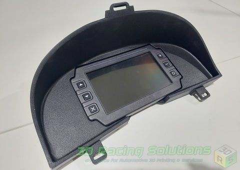

Haltech Ic-7 dash
3d Racing Solutions dash bezel
Zeitronics flex fuel sensor
Grimspeed 3 port boost controller
Braille battery
Aem 5 bar map sensor
Aem 150 psi pressure sensor for fuel pressure
I know all this stuff is in my signature and all but there is alot in this that I can't put in there lol. I will add some pics as I can find them again to add to this thread. Again I would like to thank all who followed my Evo update thread and hopefully this is a little better of a thread to read rather then the disappointing read in the other thread. Here are some pics that are of the new build.
