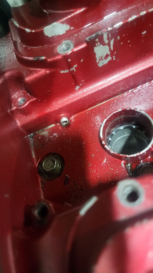

Well I have an update. I got an email from the shop with some great pics of the car. I can't wait to show you what I have to fix now. Here are the pics.
Here is the list of what they found.
Hey Brian,
Got your emails . Just wanted to give you a quick update.
Your oil leak is coming from several places.
Valve cover is leaking pretty good on the intake side, dripping all the way down the side of block , soaking alternator oil pan and oil filter housing .
Oil filter housing lines leak which we're aware of already
Brake abs pump is wet and leak somewhere there
Rear diff cover leaks as well
Valve cover has an opening in the spark plug valley that soaking the plug area with oil.
Turbo oil drain gasket leaking at the pan
Cyl#3 spark plug was missing a washer as well.
Getting ready to do a leak down and compression test but just wanted to shoot over some pictures for some updates.
He doesn't know but my car doesn't have abs thats my acd pump that is cracked.
Car has been on the lift all day and has made 0 hp. I am thankful that he is as thorough as he is in the pre prep of the car. I am just pissed yet again that car is pissing oil everywhere.
