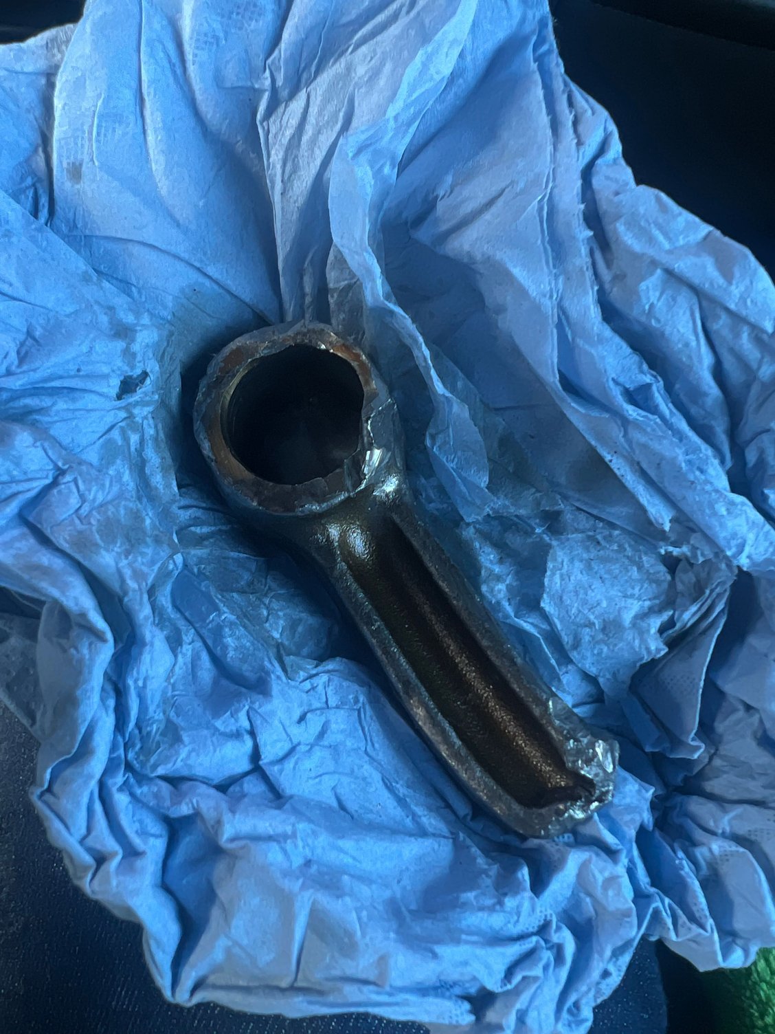

Hi all,
Took my Evo 6 out on the track for the first time to shake it down and threw a rod through the block. Not exactly what I was hoping to find out about the car but I have only had it for a year so presume the engine had a hard life before I got my hands on it. I will be looking to build a replacement engine so was wanting to see what people have done and any suggestions. I will be looking to track the car as well as have it usable on the street every now and then. Im not looking to go crazy with power, 400Hp would be were I want to sit. I more want to make sure the engine is strong, reliable and able to handle regular track days.
Not certain what parts are salvageable yet, the workshop I take it to will let me know this week once they have a chance to get it up on the hoist and inspect it. Initial idea they have floated with me is an Evo 9 short block build.
Cheers

I wouldn't chalk it up to the motor having a hard life and move on. Try to find the root cause of the failure. Just cuz an engine is old it shouldnt throw a rod, maybe spin a bearing first but it should not throw a rod so easily. So many situations of people dropping in a fresh build with all the strongest components only to blow their new motor during the break in because the original problem wasn't addressed.

Yeh Im waiting to find out this week what the workshop finds. They will be giving it the inspection to see what the situation is and then goes from there. I guess im just looking at it having thrown a rod, so a rebuild of some description is going to be needed and wanting to see what others have done/suggest looking in to.
