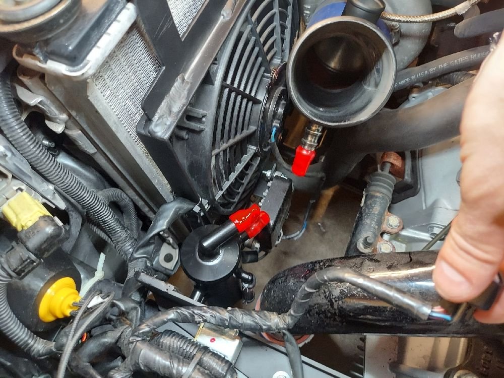

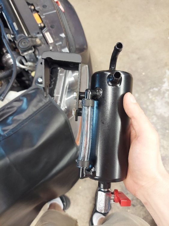

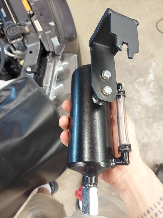

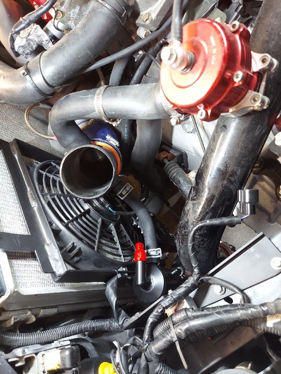

On my car (which is now sold and gone) I had machined a 20mm hole in the valve-cover to add a breather port with a 14mm ID hose. I tig put a catch can under my intake on the drivers side just near the headlight. I tig welded the appropriate nipples onto my intake so that it pulled the crankcase vapors back into the intake system sorta like stock.
I took some photos but I can't find a final build photo right now. Here is some stuff I found of when I was putting it together. I made all of my brackets from 1/8" aluminum with my tig welder, and then I powdercoated it flat back myself.
The other catch can (which you can see in the pictures) was right by the factory pcv valve on the passenger side.
