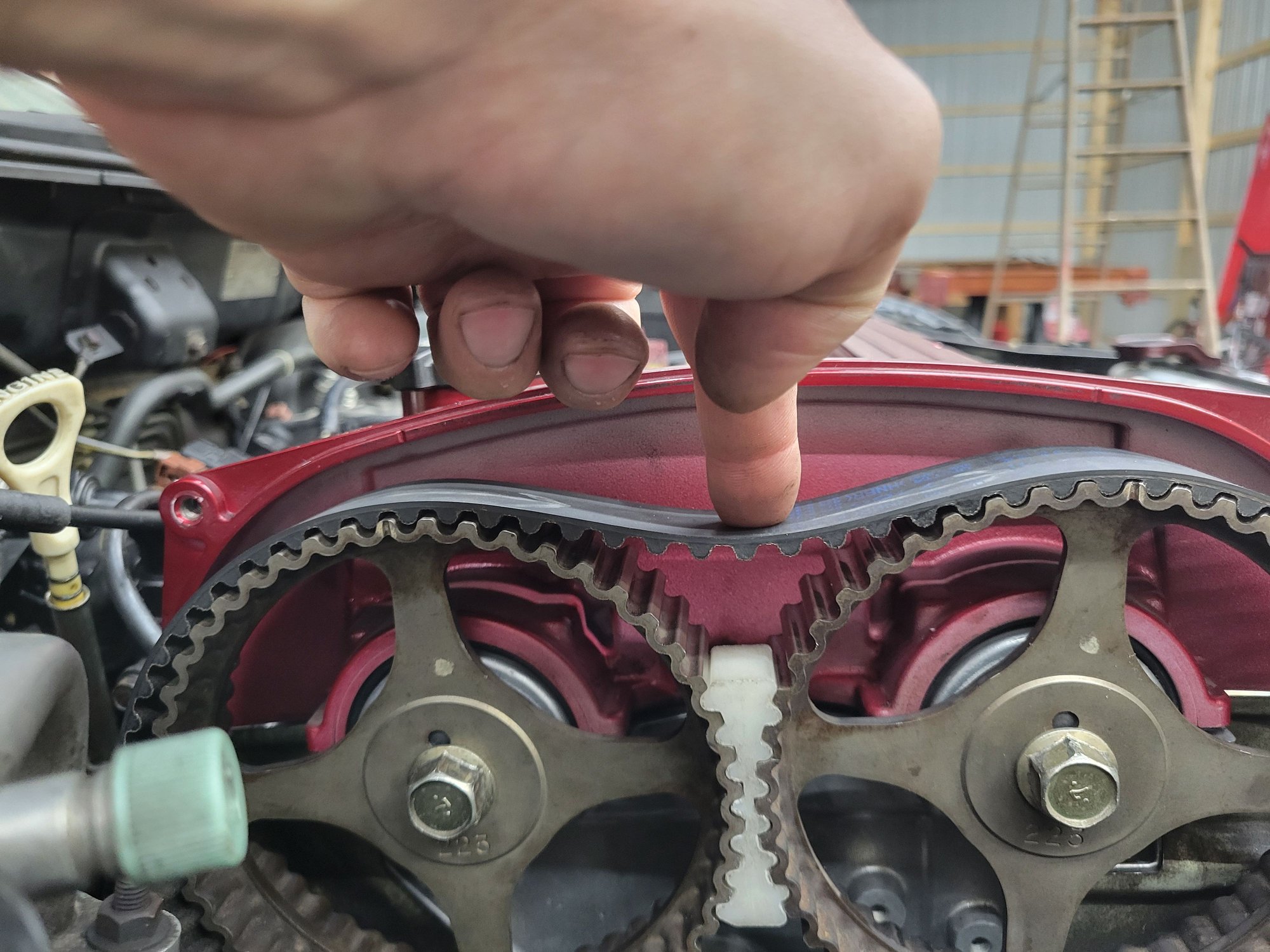

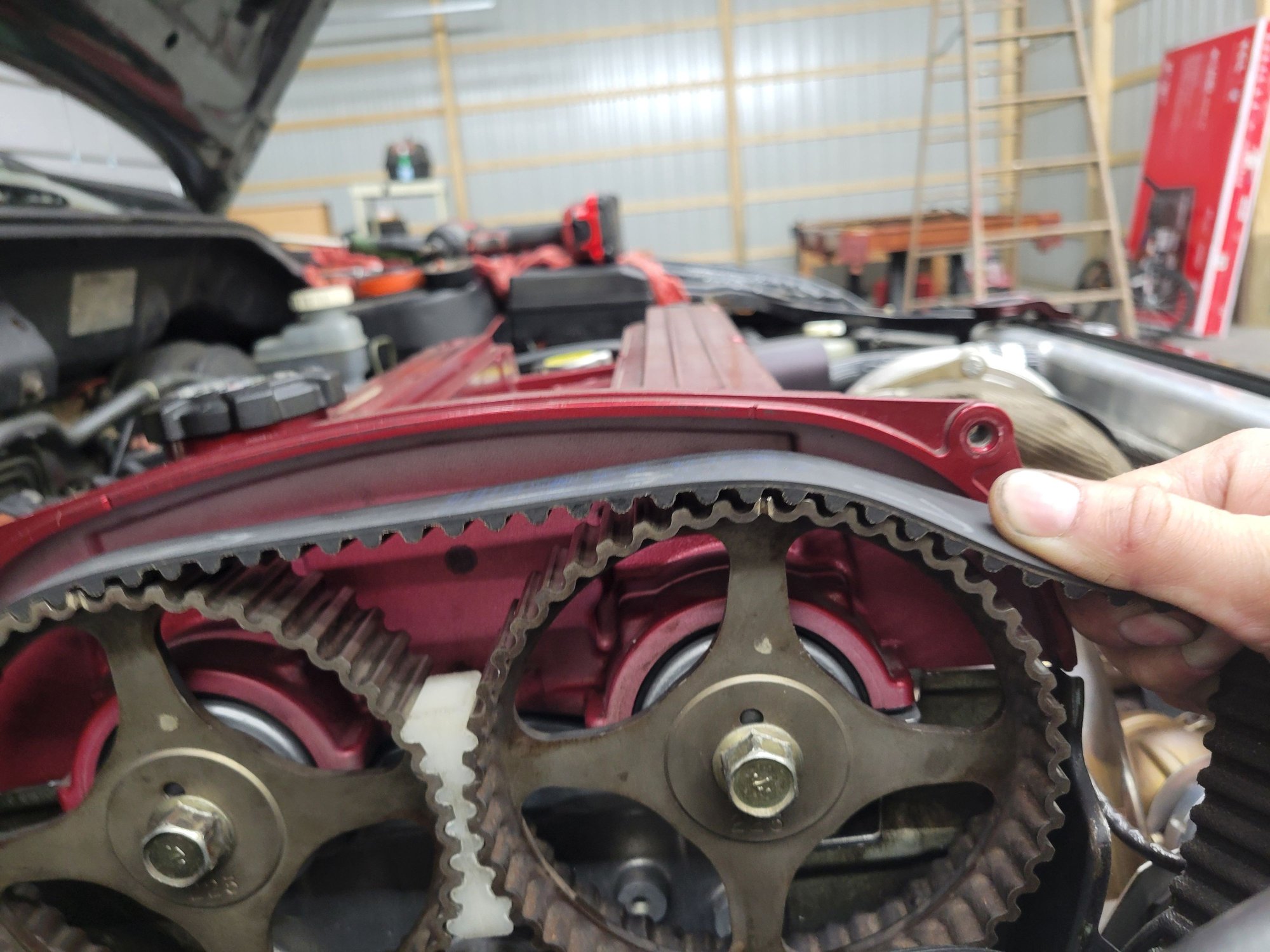

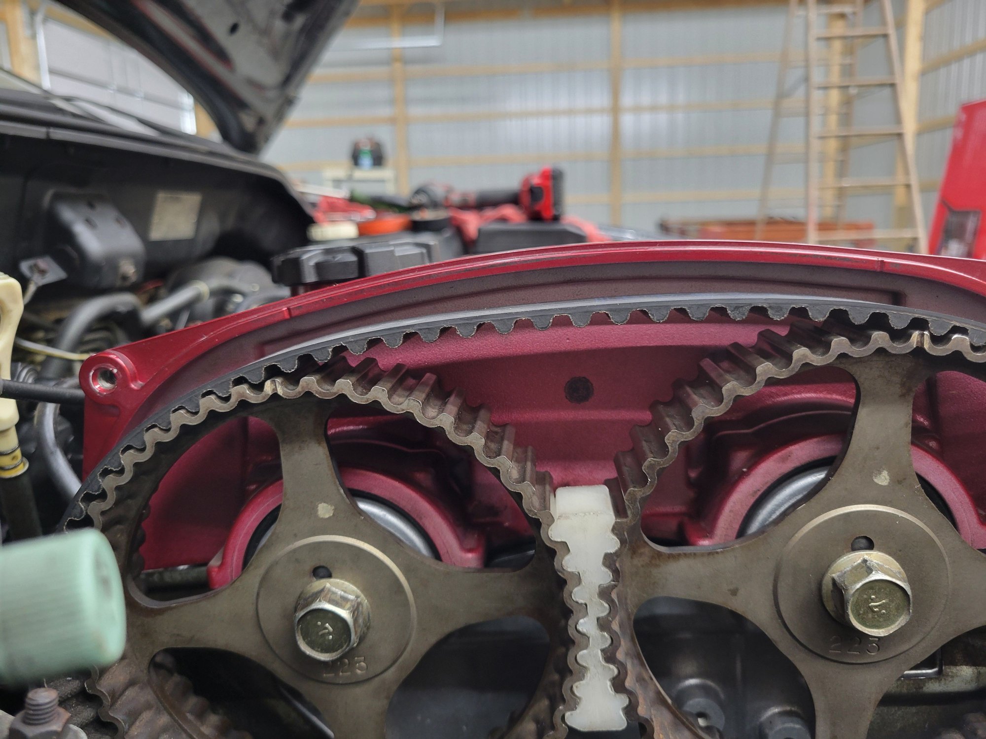

Its been a while since I've done a timing belt on a 4g63. I have the cam tool installed and the belt seems loose. The engine is a 2.3 with a 6466 making some jam. It doesn't have more than 5000 miles on this belt but I do beat on the car quite a bit when I drive it.
Is this belt stretched or will it look normal when I pull the cam tool? Its perfectly lined up to the valve cover
so im thinking its stretched but never seen it happen before.

thats actually normal at TDC and I hated it. i prefer the Gates belt for this reason but this is more of 'feeling' since it hasnt jumped a tooth yet, unlike when I had the OE belt

so when you stop the engine and it stops in that exactly position the cam gear will roll to one side and might skip a tooth. normally would happen when getting gas(maybe the belt is not warm enough) and you'll experience hard-starting. good luck
