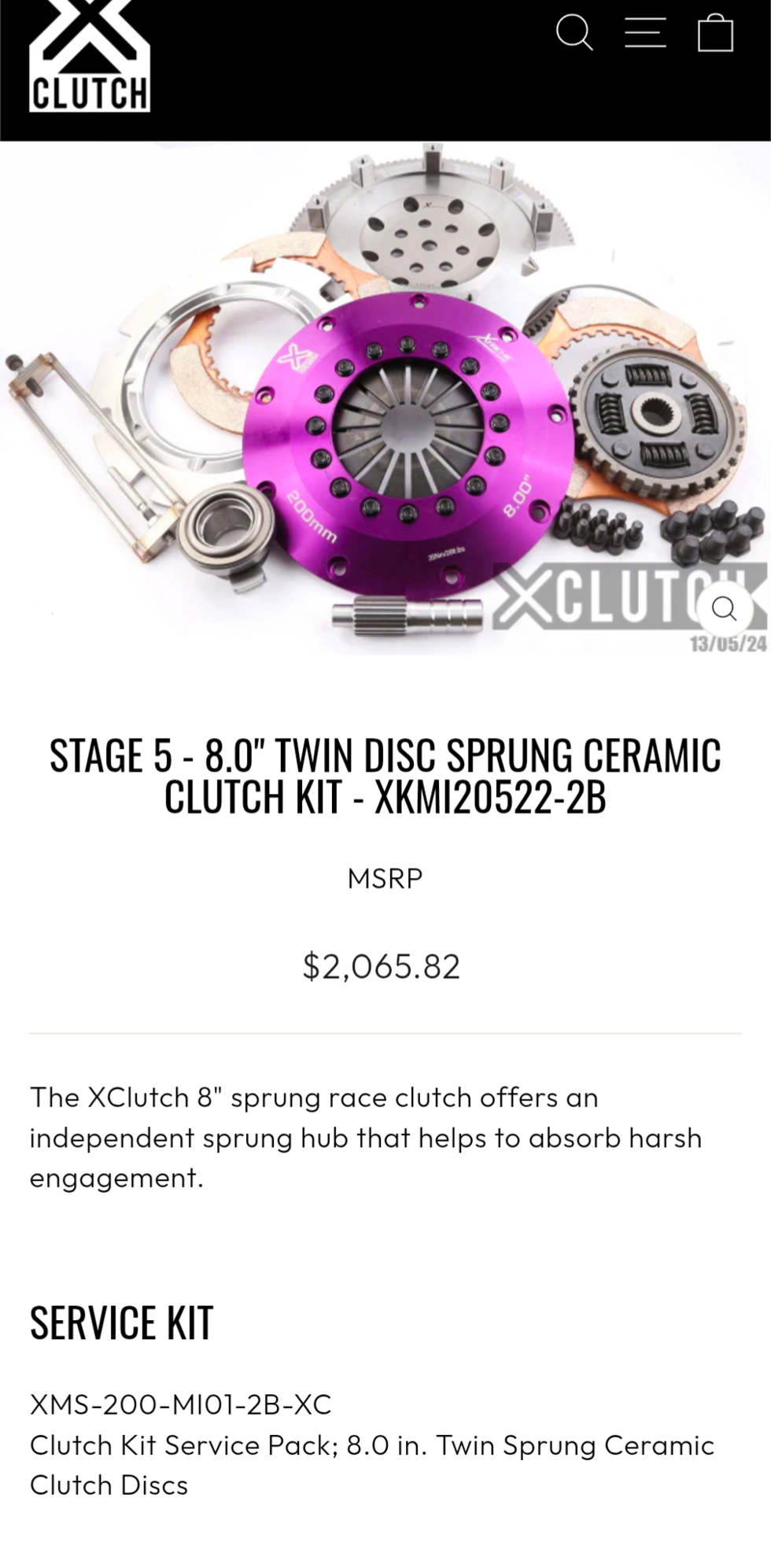

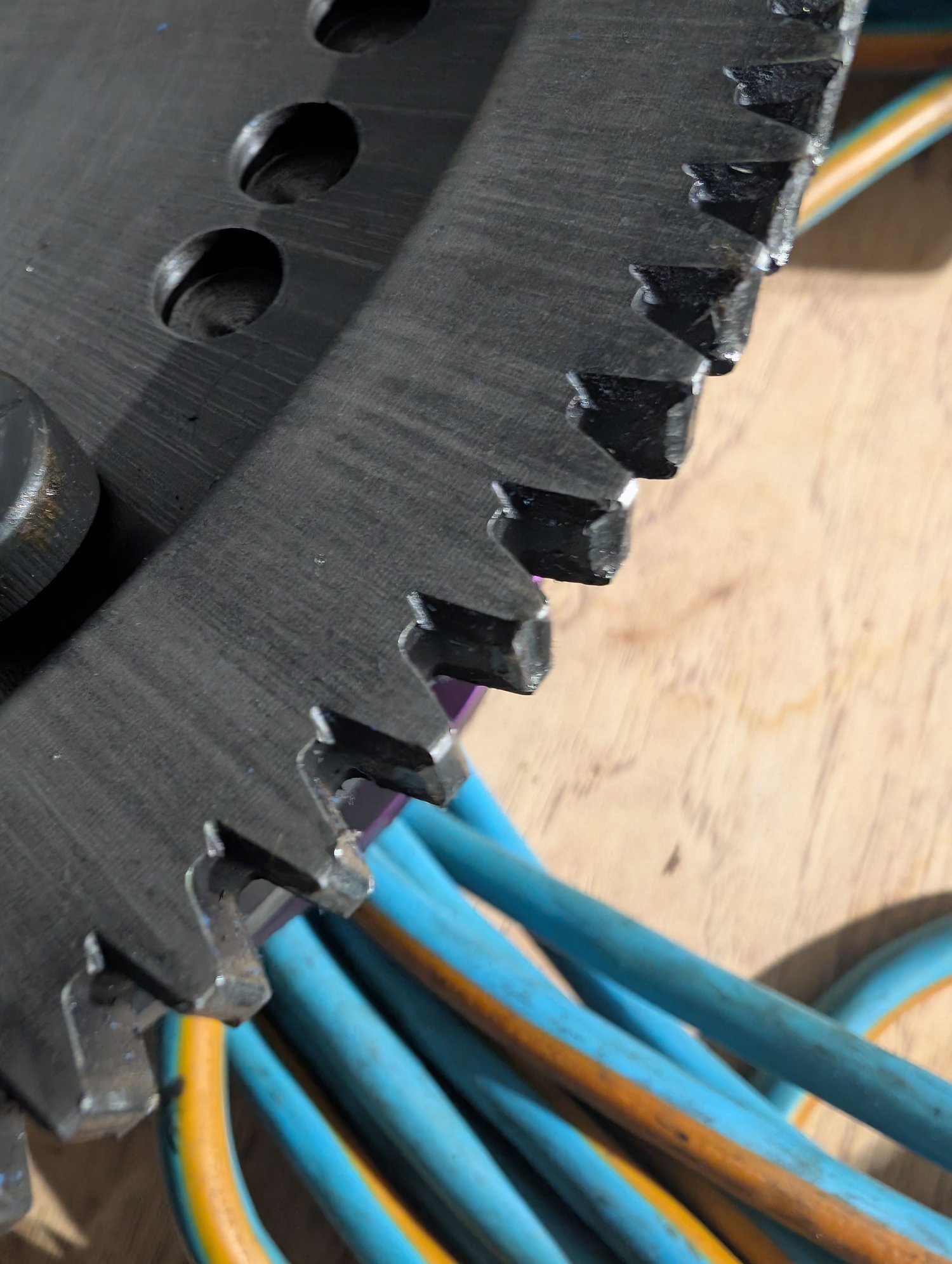

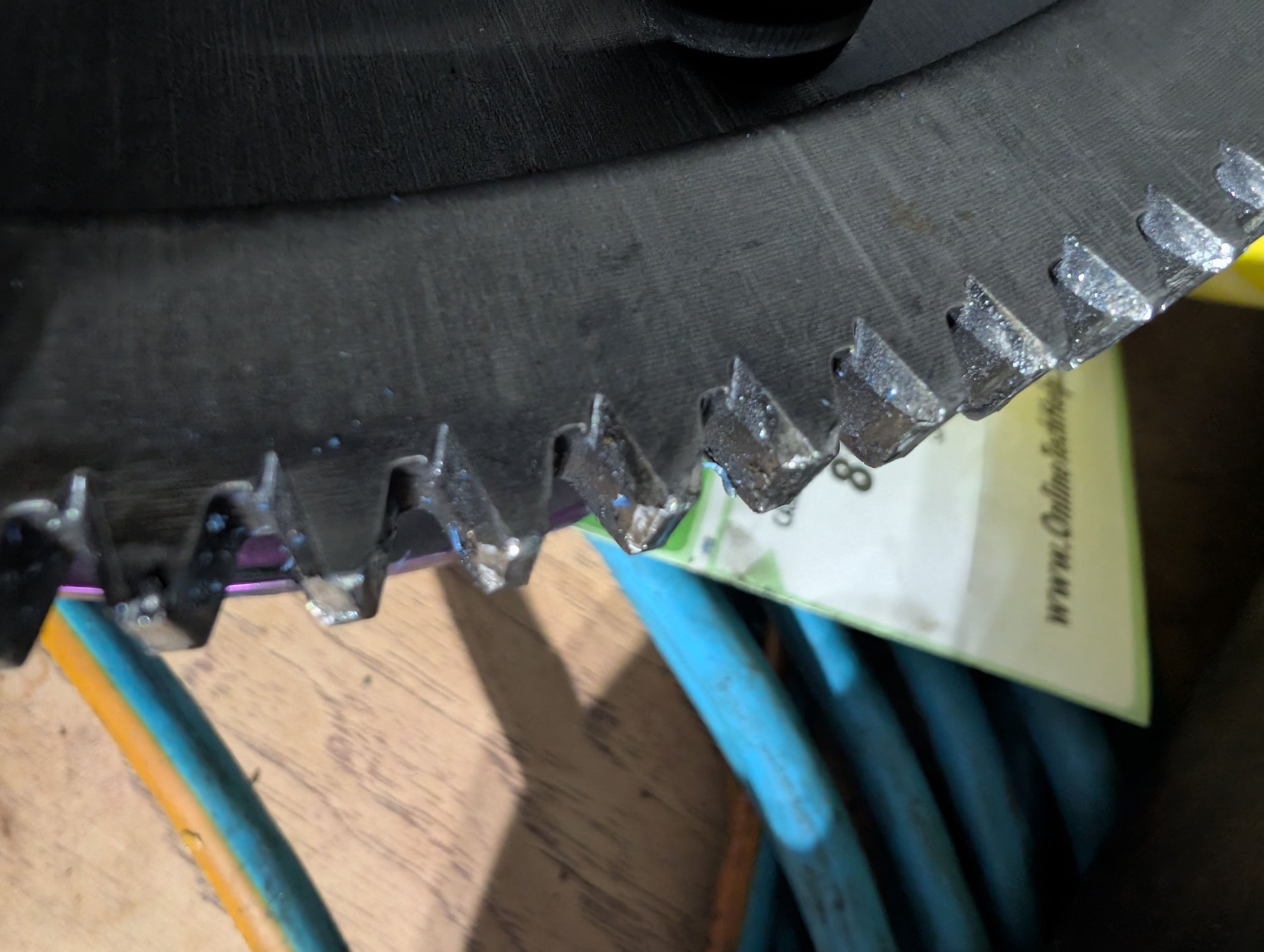

X Clutch twin. This is my second flywheel from them, I don't know specifically what is causing my issue. I've probably been through 10 starters or something ridiculous like that. I don't know enough about starter engagement to know how bad this is it whether it's just indicative if the starter not making enough contact. Either way, I'm at a loss. Engine has a total of about 4k miles on it which is hasn't been completely dialed in so long cranking for starts was usual.
The first time I was having this issue, I replaced the flywheel and starter plate. After 1 or 2 starters that is and the issue went away. I'd rather not buy a 3rd flywheel. I'd have symptoms of it hanging up and kicking back while turning it over as well as the grinding. New engine to trans dowel pins as well, same deal.
Please someone just tell me I'm being stupid and it's a really simple fix ....lol
This is the specific kit.
Last edited by Random4g63; Mar 3, 2026 at 08:56 PM. Reason: Adding picture of clutch kit.
