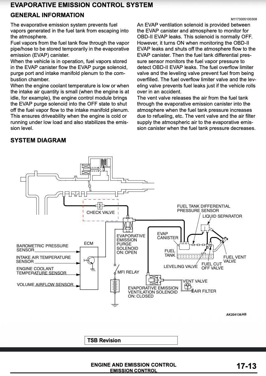

Hi Ya'll,
Wondering where you guys find a check valve between the purge valve and intake manifold to avoid boost backfeeding into the EVAP Canister?
Any aftermarket solutions, compatible parts from other cars in salvage yards , etc?
Picture below
